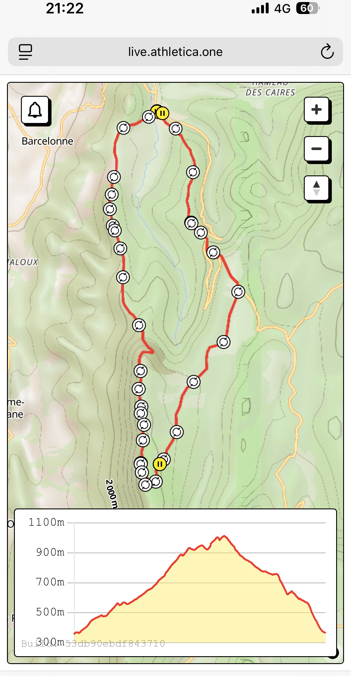

                                  Full tested tonight, on a 2h17 trail running in a place I didn’t know (route drawn and followed).
                                  Here my feelings :
                                  • works very well ! My friends have used the link to follow me : very impressed by reactivity !
                                  • precise, easy to use
                                  • batterie consumption :
                                    => phone 19% (iPhone 16pro). A bit high to me even if I’ve done some picture and 3 small videos, 2 short phone calls and a few times looked at the tracking link
                                    => Suunto vertical : 7%. Higher than usual but 2 apps running (live. And climb).
                                  • power and heart rate were not transmitted despite I had pinned « additional data on » in app
                                  • I understand that tracking link is always the same from an exercise to another is using same watch ?
                                  • it would be awesome to have the altitude profile as a hide and show option during tracking. As I understand it’s only available a the end of exercise
                                  • would be great to have a « zoom out on whole track »
                                  • would be greater to have the planned route as background if using navigation
