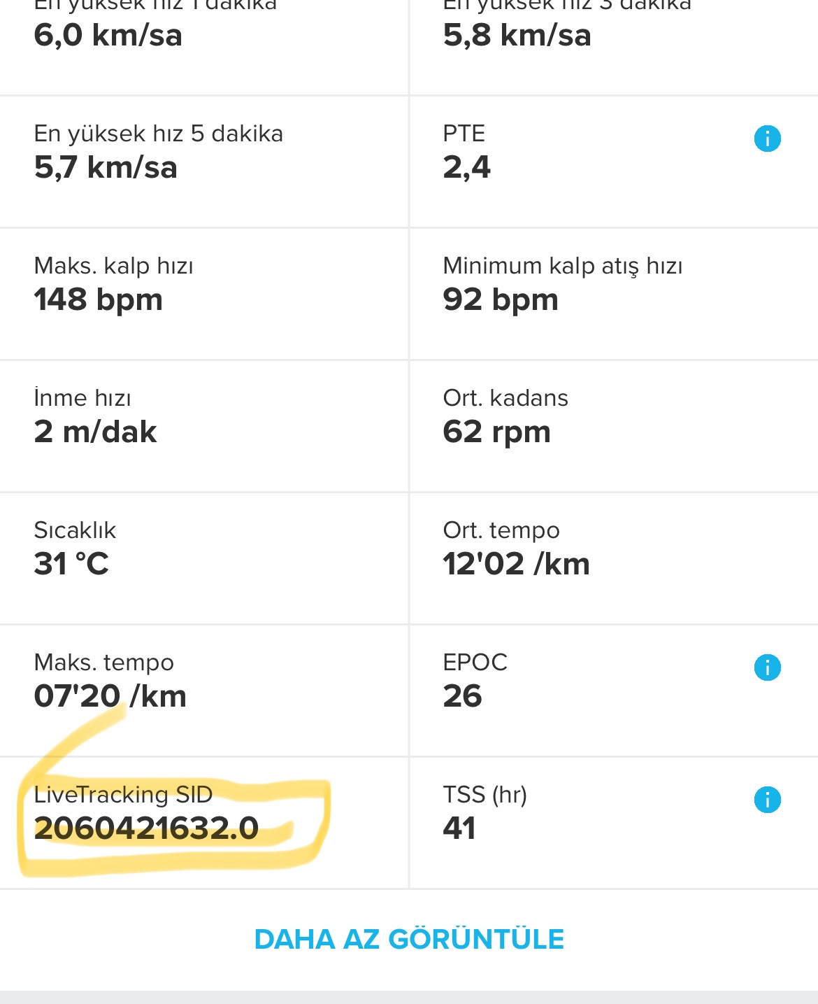

                  Hello, the area in the image comes with the results of the training. What is the meaning of this SID code?

                        Nikolai Simonov @safari
                        @safari
                        Great question, the SID code isn’t used for anything just yet.
                        In the future, when we introduce login via Suunto feature, this code will help link the Live.t session with your Suunto workout.

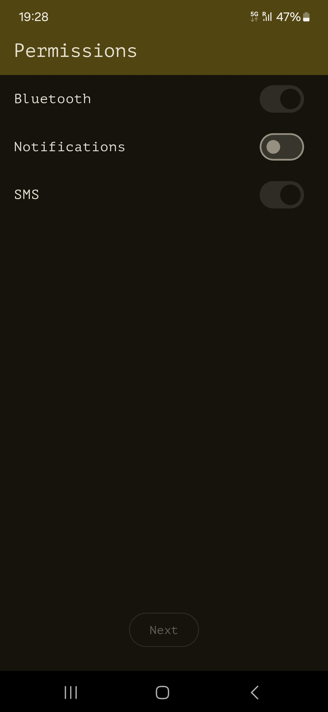

                                        1. I installed the app by downloading the APK file because it didn’t give an option through Google Play here in Israel.
                                        2. I told @peegee that Android is better than IOS 😁
