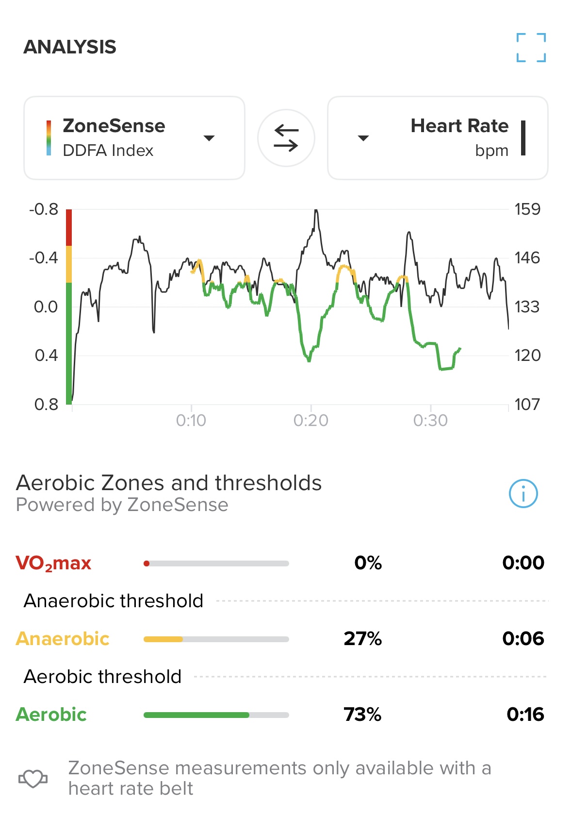

      @timecode it happened me the first time a few weeks ago. I didnt wet the belt before my run. I guess the connection was good enough for HR but not the r-r data. After a while probably my sweat made the connection better or something?
      Vertical All Black
      isaziI ? 2 Replies Last reply Reply Quote 1
        isazi Moderator @SamuelP
        @SamuelP indeed, if the data is too noisy it is not used for ZoneSense, data needs to be quite clean to be used.
        Watch: Suunto Vertical Ti
        SamuelPS 1 Reply Last reply Reply Quote 0
          A Former User @SamuelP
          @SamuelP good hint, thanks. I will try it again tomorrow and keep this in mind.

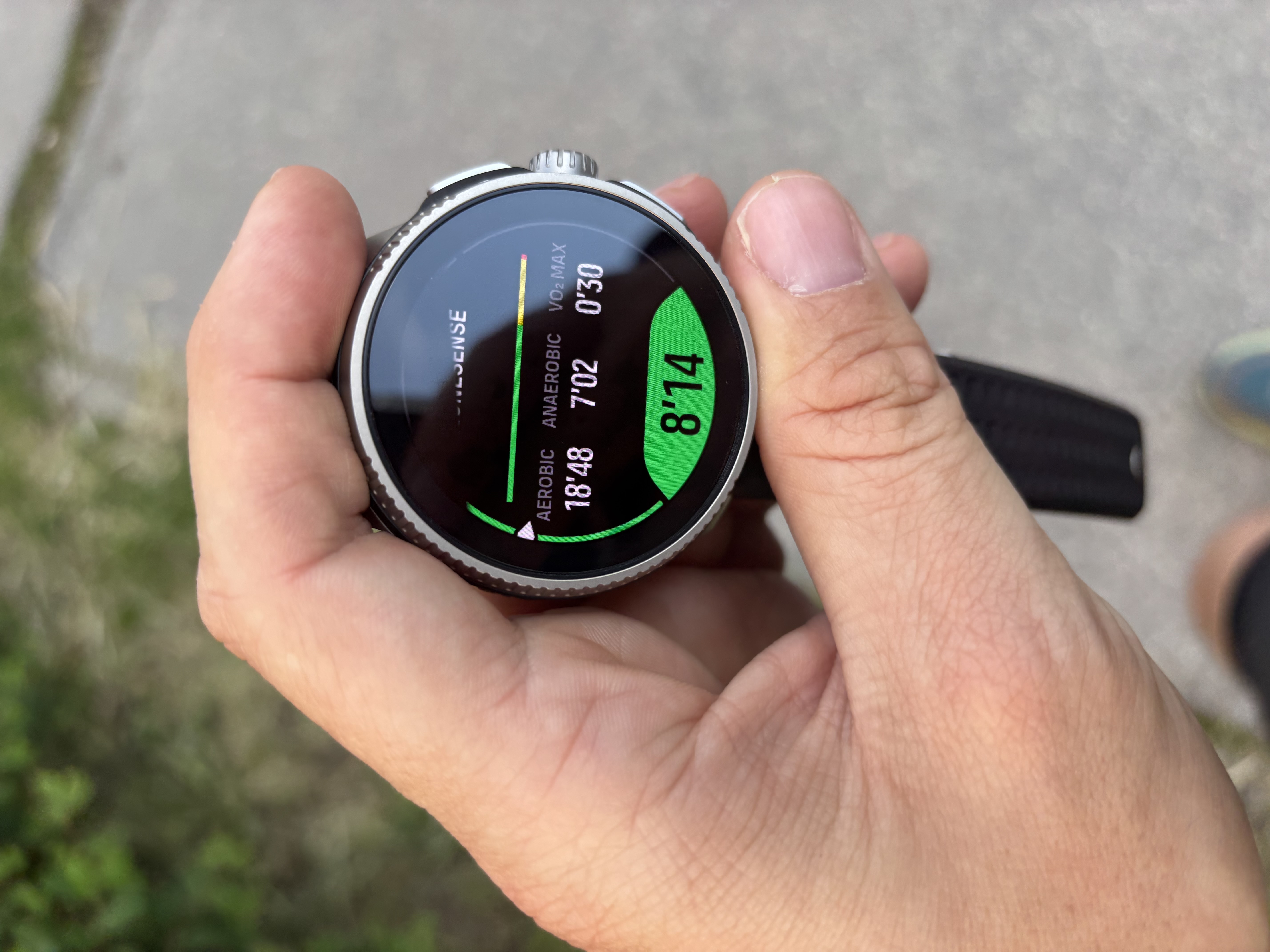

                    A Former User @Brad_Olwin
                    @Brad_Olwin just fyi, today I ran again with the HR strap and as you can see time spent in each zone on the watch is different as in the app. There’s again a gap at the end. I am sure it’s not an issue with the strap, it’s wet, fairly new and a brand new battery.
                    Brad_OlwinB SportsfreundS 2 Replies Last reply Reply Quote 2
                      Brad_Olwin Moderator @Guest
                      @timecode the watch is real time and the app calculates from synced data. Those are very similar IMHO 30s ± for VO2M does not seem like much.
                      Don’t know about the end, perhaps R-R data is noisy from strap drying or static from tech shirt, don’t know. I have not seen this in my experience.
                        @Brad_Olwin ah ok, I thought data in watch == data in SA. Good to know, thanks. Will “investigate” further.

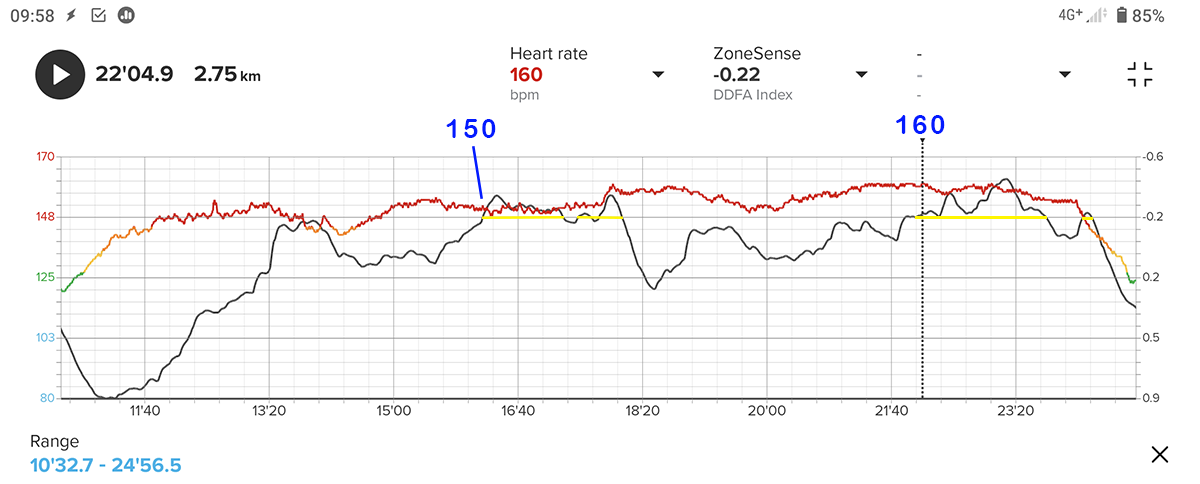

                                i also want to rely on zonesense but i really struggle to understand how is it possible when going uphill , with over 170Bpm for some minutes the app to be showing i am in the green zone… In principle i am excited about relying on hr variability but am i harming myself by relying on it? that’s the big question for me
                                Francesco PaganoF ? cosme.costaC 3 Replies Last reply Reply Quote 4
                                • Francesco PaganoF Offline
                                  Francesco Pagano Silver Members Bronze Member @thanasis
                                  @thanasis from my perspective this question arises not only when going uphill, but when increasing the intensity in general.
