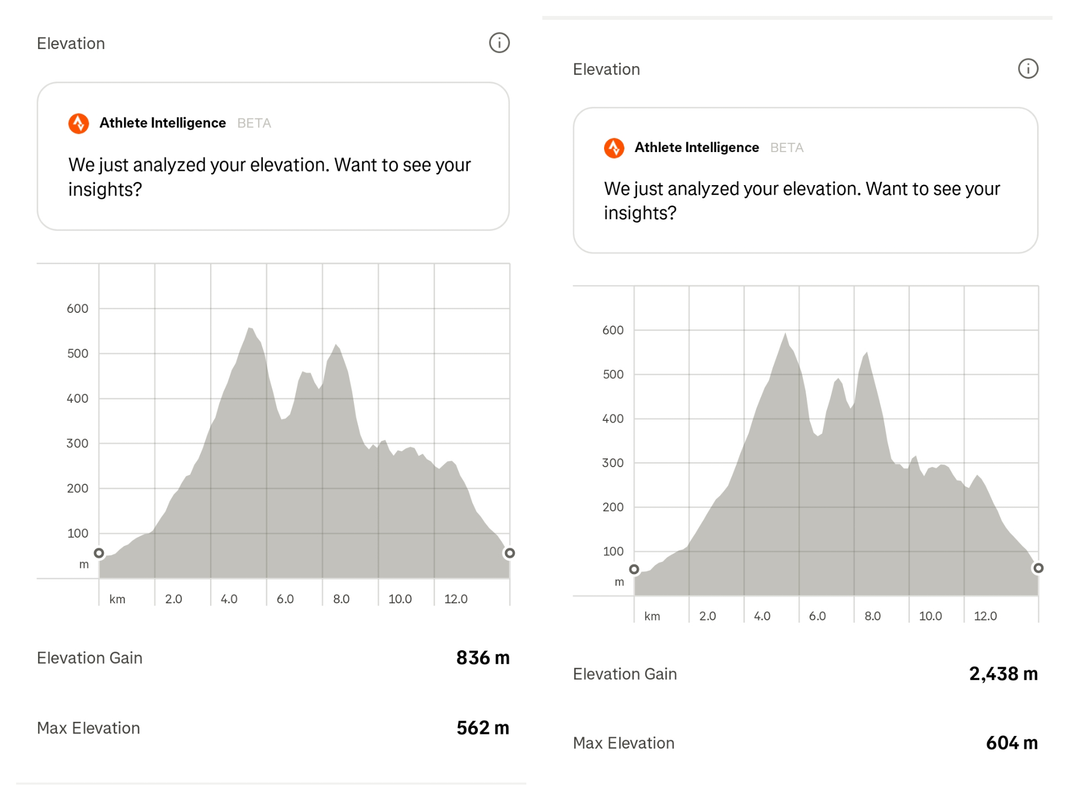

                        • M
                          maszop Bronze Member @isazi
                          @isazi Improving this current algorithm is essential - current measurements are often completely useless.

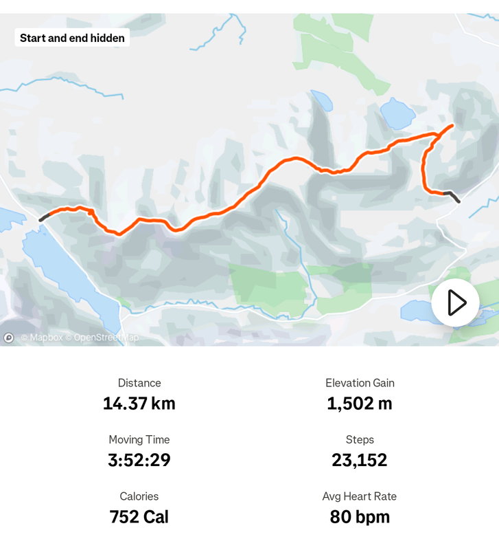

                          Yesterday’s example:
                          Suunto Vertical measurements -1502m:

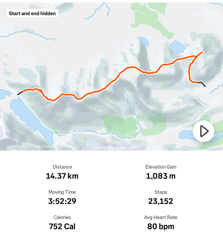

                          alt text
                          Strava data - 1083m:
                          alt text

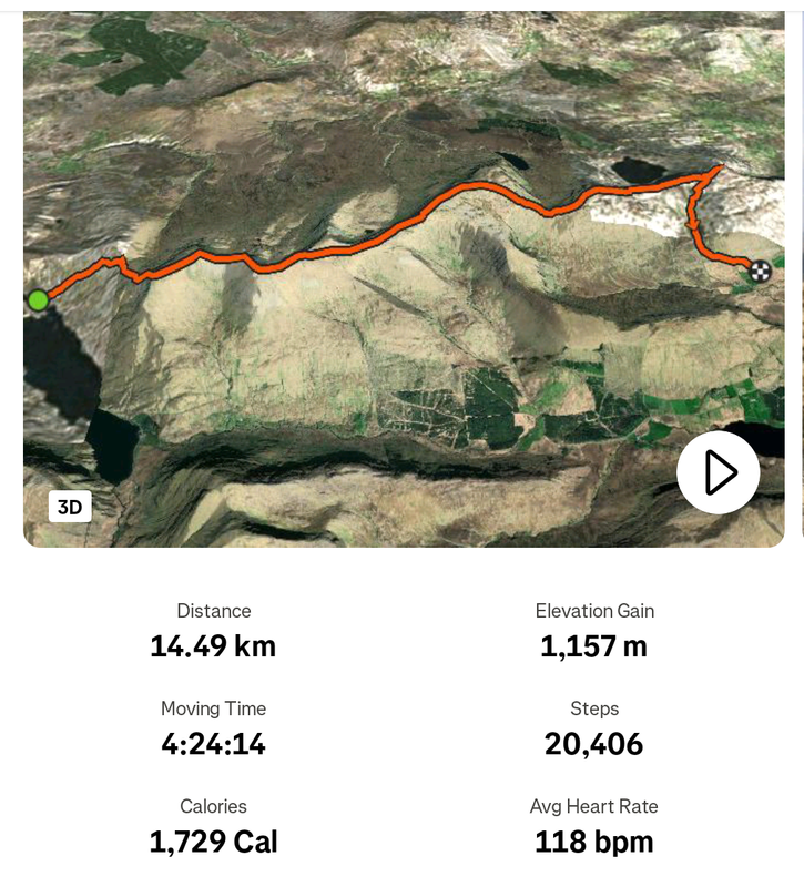

                          Garmin Fenix 7 - 1157m:
                          alt text

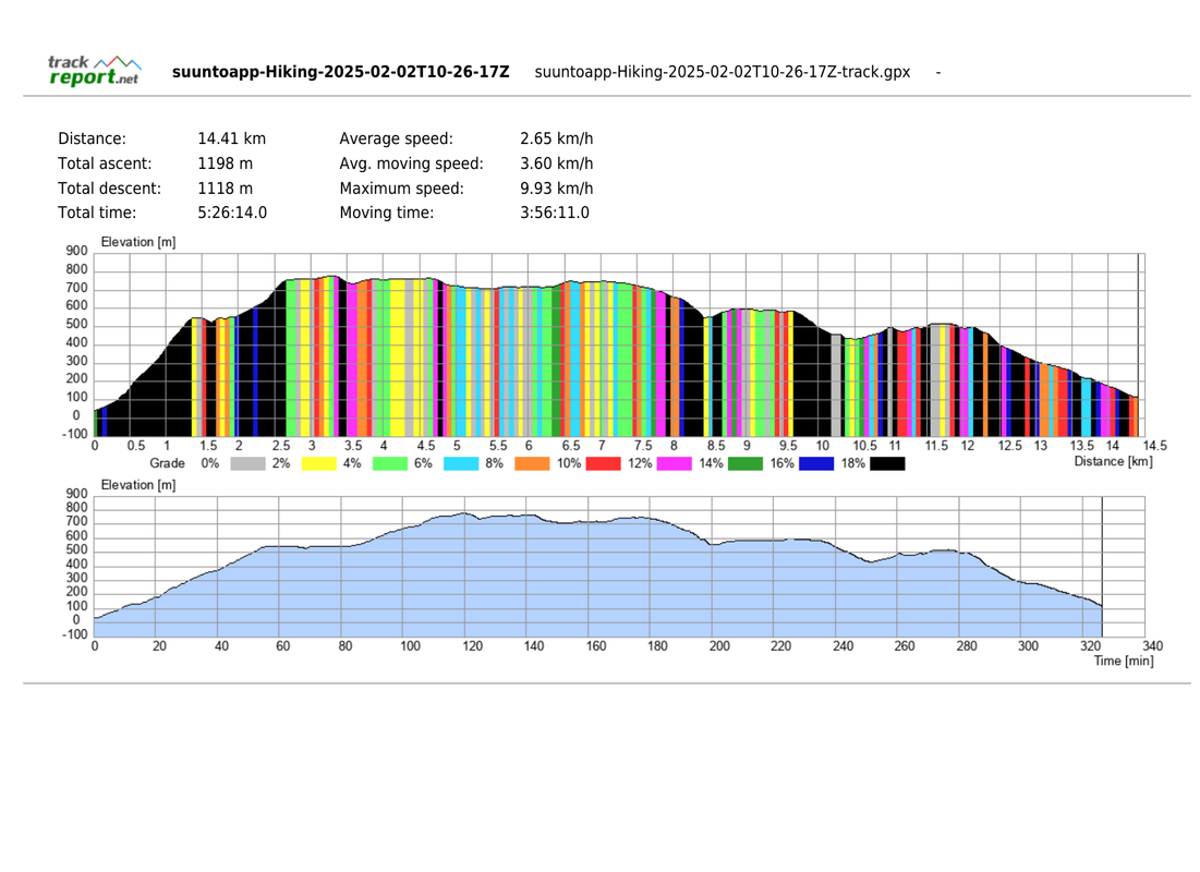

                          Suunto data after smoothing - 1198m:
                          alt text
                          It seems that the measurements from Garmin 7 look the best.
                          Suunto measurements - better not to even comment on that.
                          M 1 Reply Last reply
                          Reply Quote 0
                          • M
                            maszop Bronze Member @maszop

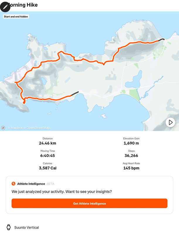

                            Yesterday Suunto Vertical also shone:
                            Suunto Vertical measurements: 3247m
                            alt text
                            Strava data: 1690m
                            alt text

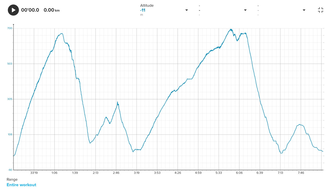

                            Elevation profile in Suunto App:
                            alt text
                            Total disgrace of Suunto.

                                      • S
                                        slash1111
                                        Today was the wind stronger than usual. So the spikes on the meadows are significant (and the distance (3D?) is longer too). I’m wearing the Vertical on the sleeve.
                                        (The “spikes” in the Woods are terrain)
