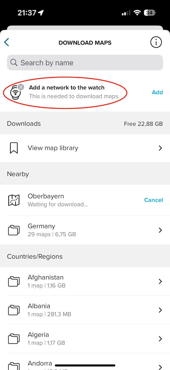

                                            zucchero
                                            I did a factory reset on my Race S, restarted the Suunto APP and restarted even the mobile phone, but I have the issue that the App is not remembering my Wifi and the map download cannot start.
                                            The Wifi I have connected uses 2,4 GHz, but for the watch it does not exist anymore. This is really annoying. The Software is 2.43.12.
                                            What’s wrong?
