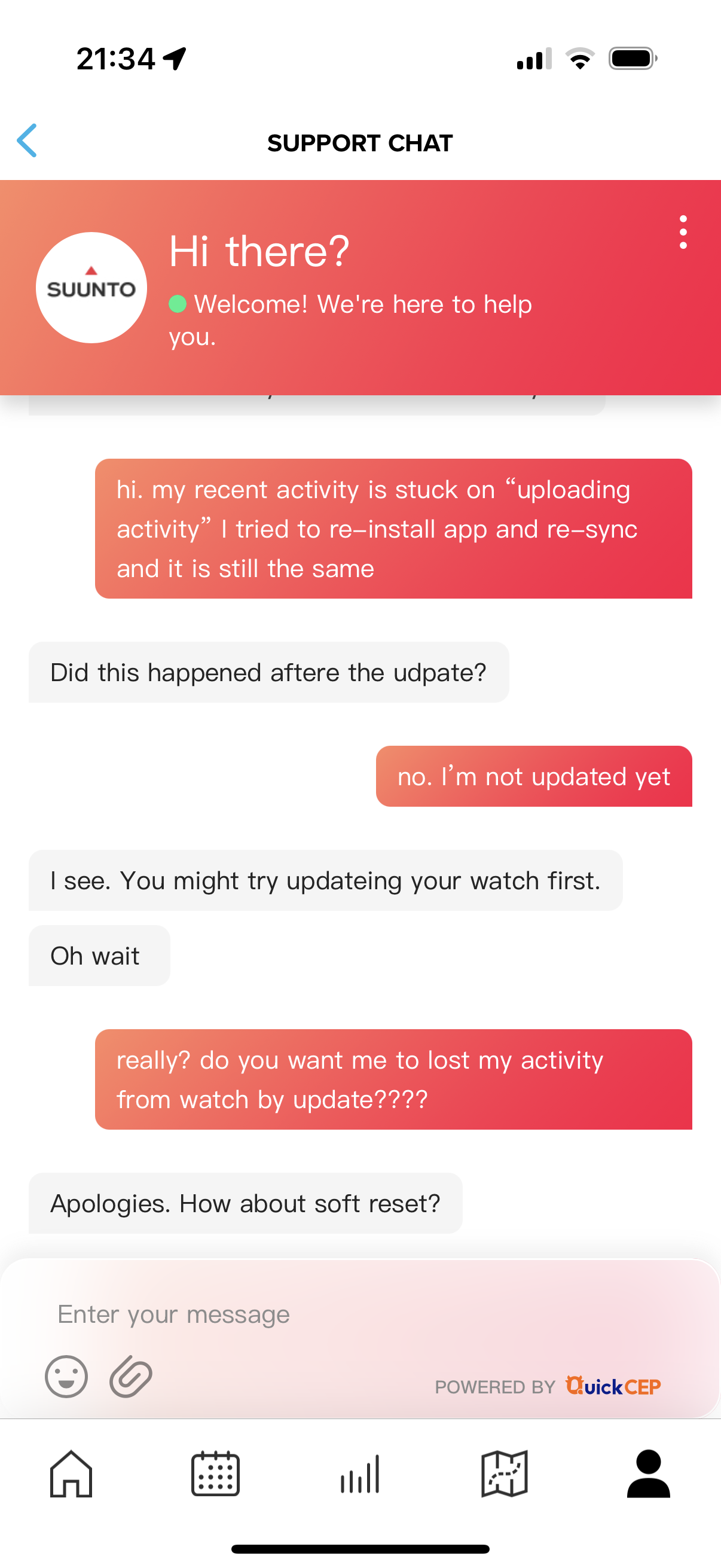

          @mareeeeeel I have the same issue. I tried everything, also contacting where they suggest to update firmware (so I would lost my activity completely)!IMG_4701.png

                  @mareeeeeel now I try previous build via testflight and it is still the same. I assume our “broken” activities are already on the servers, so re-uploading will not work
                    dombo Bronze Member
                    final update: our activities are on suunto servers - you can see them when you log to https://www.sports-tracker.com/
                    I have tried to delete activity, install older build and re-connect watch and re-upload… and still the same
                    so the issue is that suunto is not able to process this activity
                    warning: DO NOT DELETE ACTIVITY FROM APP/SPORTSTRACKER IF YOU HAVE REINSTALLED YOUR WATCH FW MEANWHILE OTHERWISE YOU LOST YOUR ACTIVITY!!!
