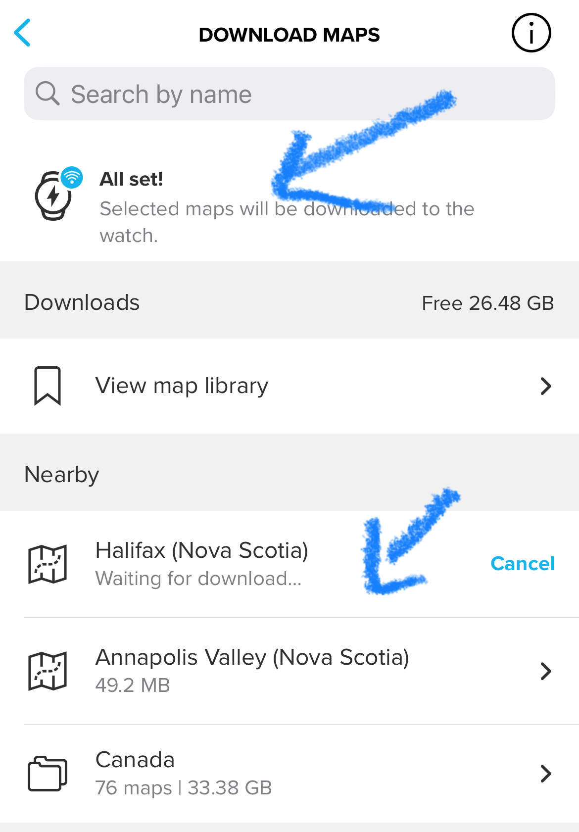

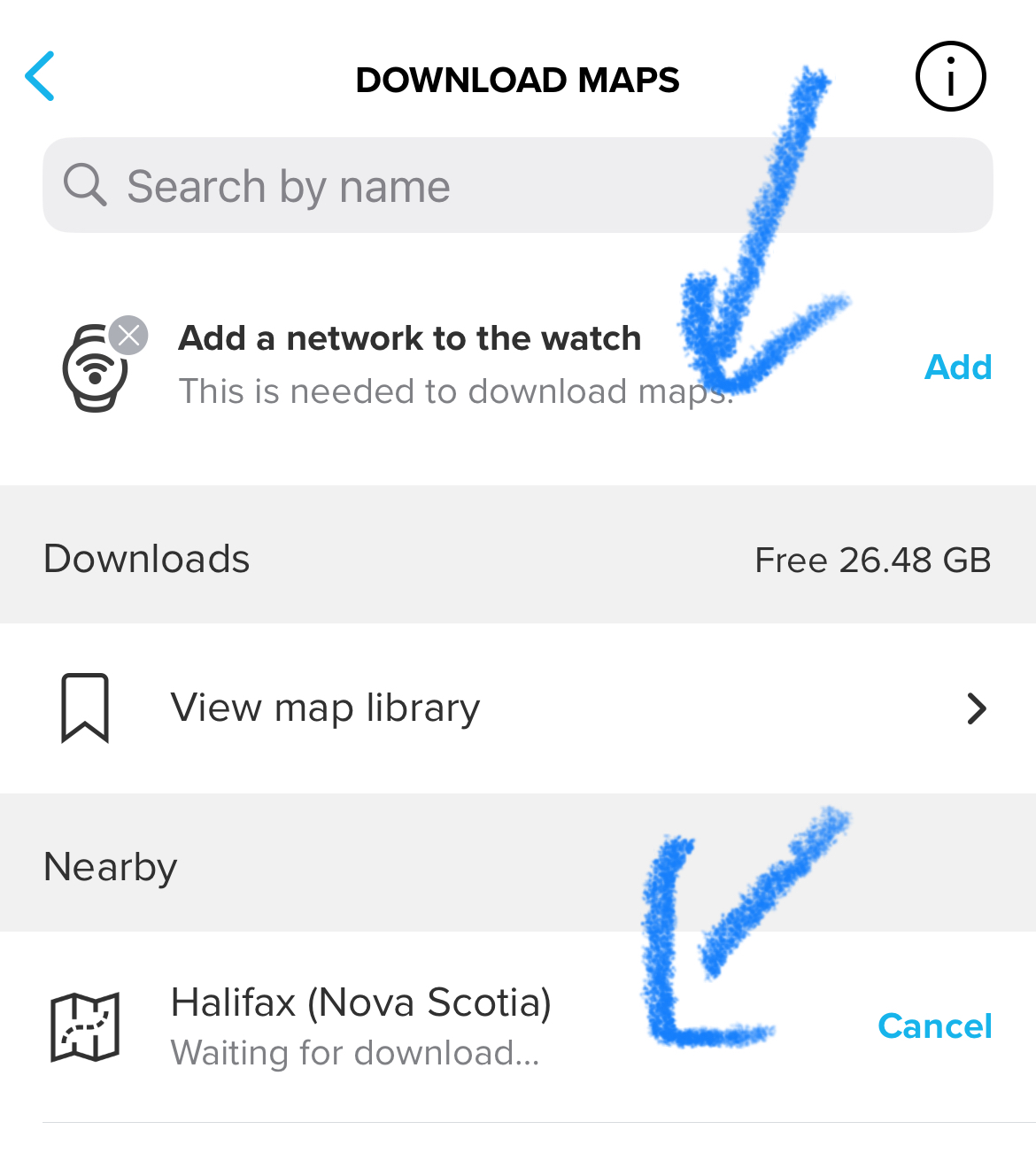

          I’m on holiday and trying to download a region before I go out to explore the trails. When I added the wireless network, it said “All set!” After a few seconds, it says “Add a network to the watch”.
          The map itself is stuck downloading.

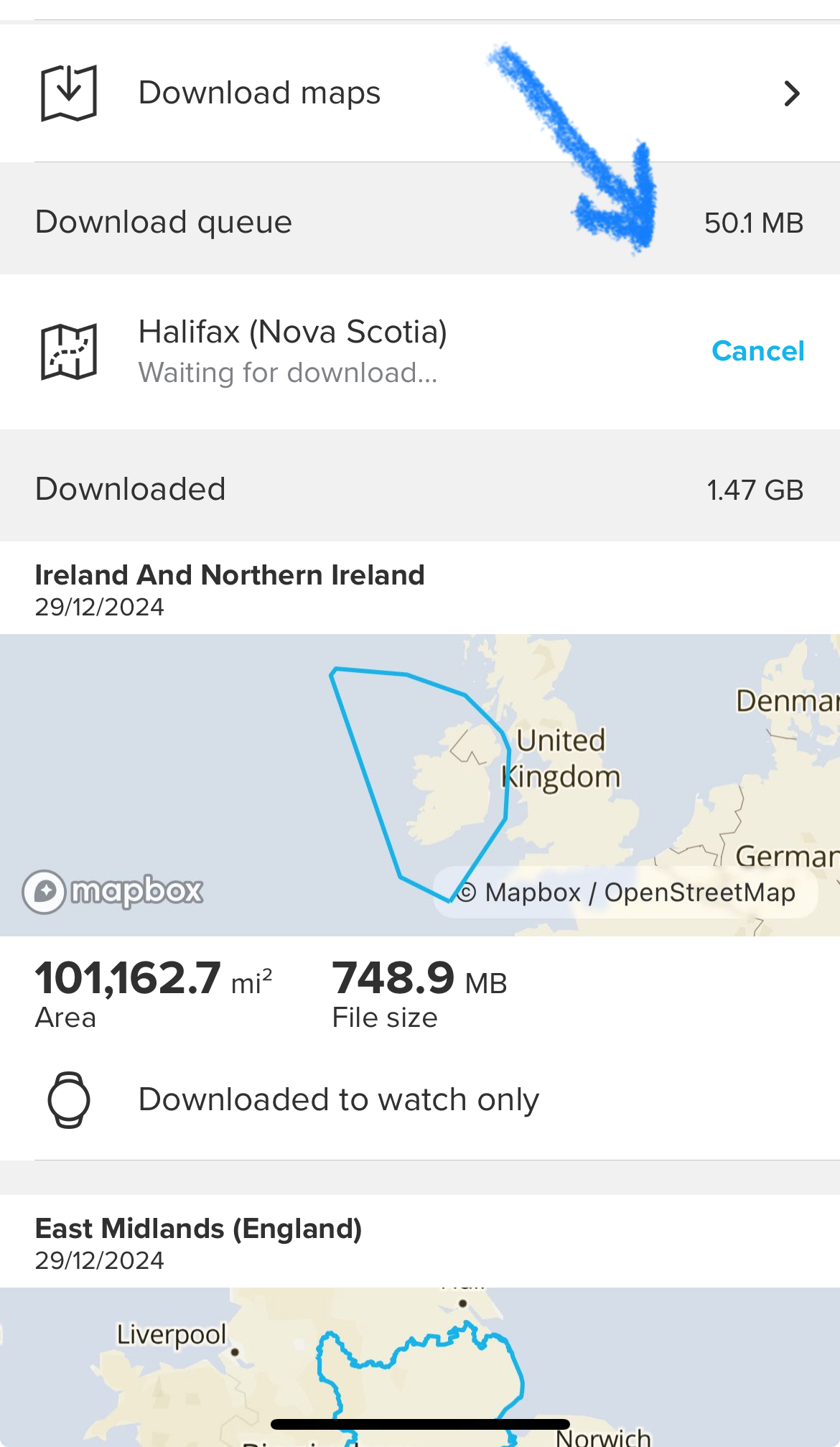

            PS: It’s a relatively small map. Screenshot with download + previously downloaded maps:

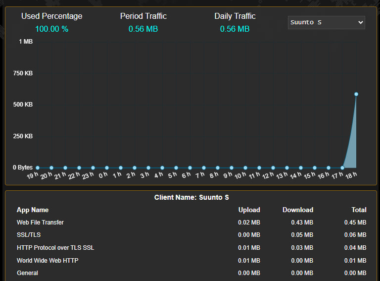

                I fixed the Wi-Fi earlier, the problem is precisely the lack of progress when downloading
                • МихаилМ Offline
                  Михаил @2b2bff
                  @2b2bff hi
                  It all started with nothing happening when selecting cards, it turned out the watch “forgot” WiFi. The connection didn’t work.
                  I read the forums and found out how to roll back the watch software. So:
                  Iteration 1
                  Version 2.39.20, WiFi 5, connection configured
                  The router sees the connected watch
                  ! but the boot process is frozen (see screenshot below)
                  Iteration 2
                  Version 2.39.20, WiFi 2.4, connection configured
                  Iteration 3
                  Version 2.39.20, WiFi 2.4, connection configured + VPN
                  I chose the smallest card for the test
                  ![alt text](photo_2025-05-21_18-24-14.jpg image url)
                  In more than an hour, the watch downloaded less than a megabyte
                  МихаилМ 1 Reply Last reply Reply Quote 0
