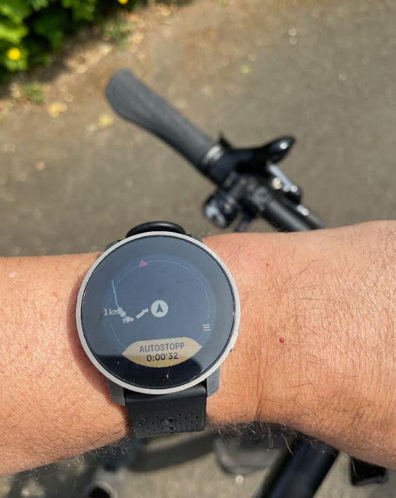

                      Okay, did a test ride. On the route screen it zoomed out two 500m, 1km, 5km. Latest software update is installed. The white dots show the breadcrumb the blue line the planned route.
                      If there is no auto zoom on the SRS it seems there is a difference at that point.
                      Should be added to the SRS too.
