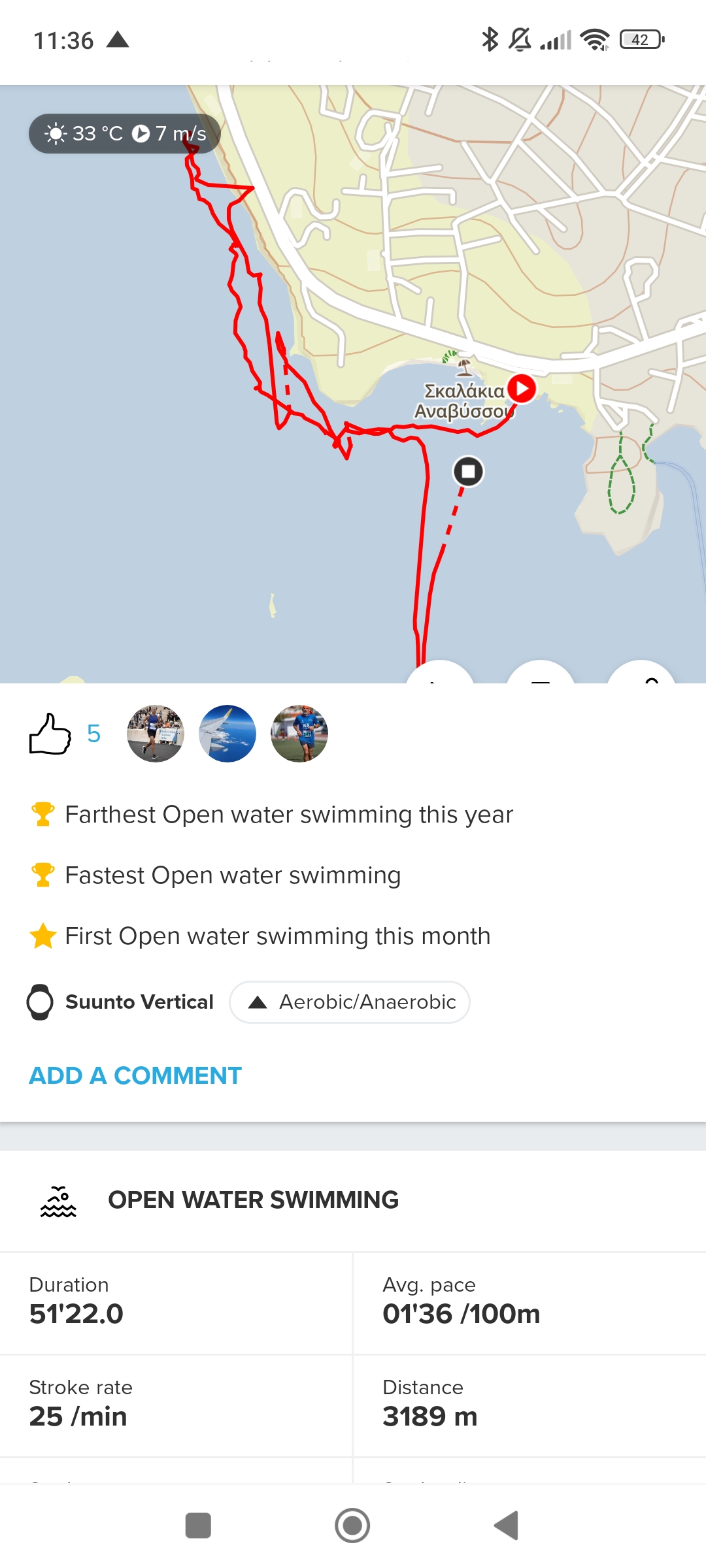

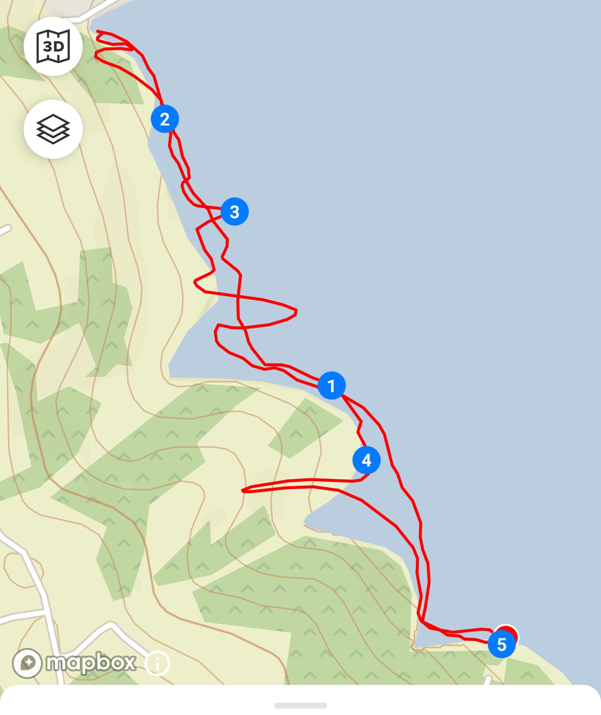

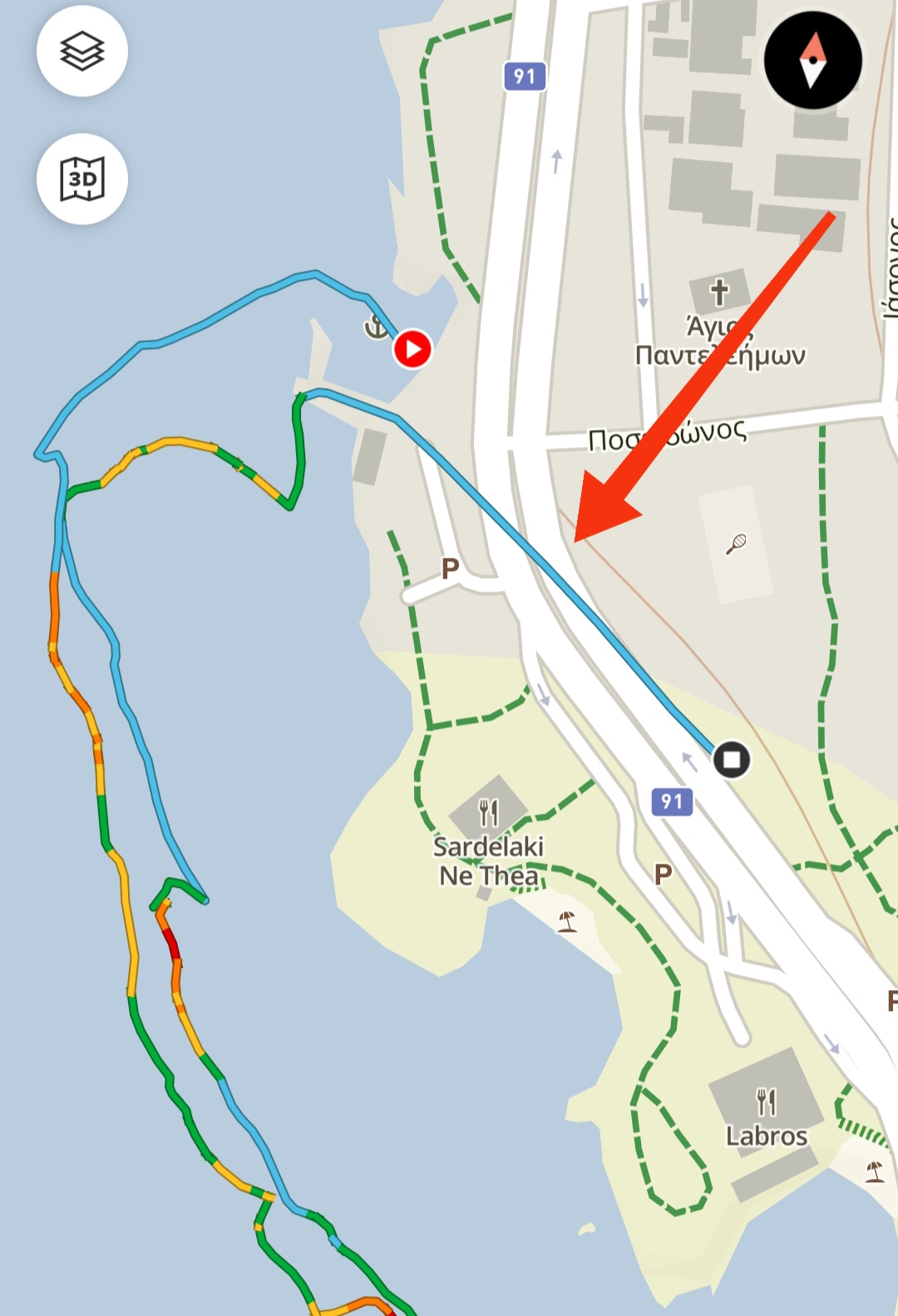

      After the latest update, I’ve noticed increased GPS sensitivity in Open Water mode, resulting in significant drift.
      It feels like the watch locks onto a satellite and then gets “dragged” along even when I’m completely stationary.
      In previous firmware versions, even when my hand was underwater for a few seconds or when I pressed pause, I never had any issues — everything worked perfectly, and the recorded distance was always very close to reality with minimal deviation.
      Of course, I always follow the proper pre-activity GPS lock protocol to ensure optimal signal before starting.
      (https://www.suunto.com/en-gb/Support/faq-articles/lifecycle/how-to-get-more-accurate-open-water-swim-tracking/)
      Has anyone else experienced similar behavior?
      I’ve done a soft reset and even deleted and recreated the sport profile, but I still see the same result.
      All other activity modes on the watch work flawlessly — it’s only Open Water that seems affected.
      (Hard reset it’s a solution? I want to avoid it)
      Thanks 🙏🏻
      Screenshot_2025-07-07-11-36-05-691_com.stt.android.suunto.jpg Screenshot_2025-07-07-11-35-44-576_com.stt.android.suunto.jpg

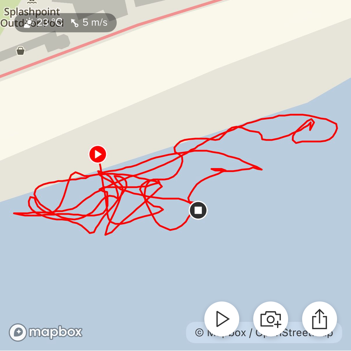

        I noticed this behavior as well, and I wrote about it in another thread about one week ago… but as usual, they told me that everything is fine and I have to wait longer to find more satellites 😂 @Egika 🙈 how long will we have to wait to find satellites?Some minutes or some hours?
        I noticed that the behavior is worse than last year…

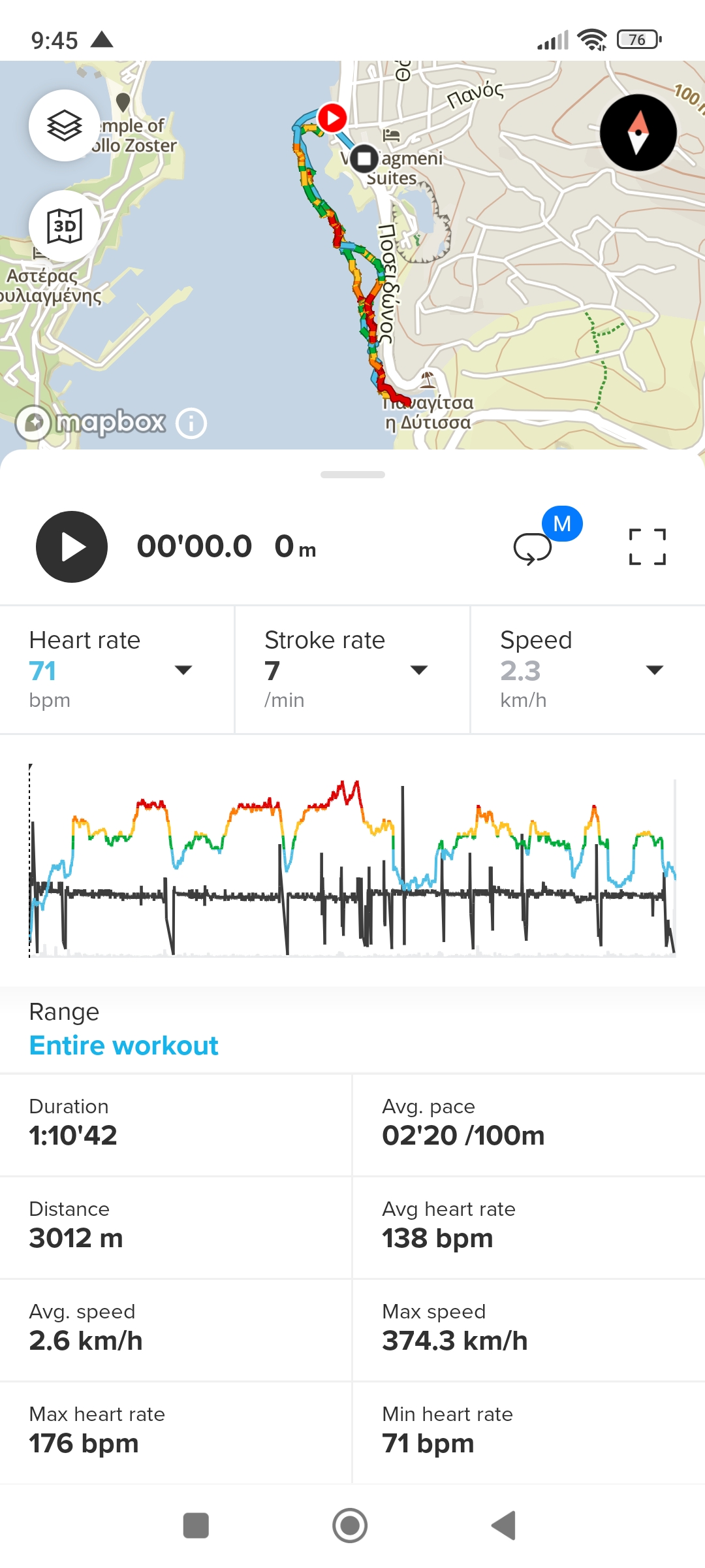

            • gerasimosG Online
              gerasimos Bronze Member @Pavlas

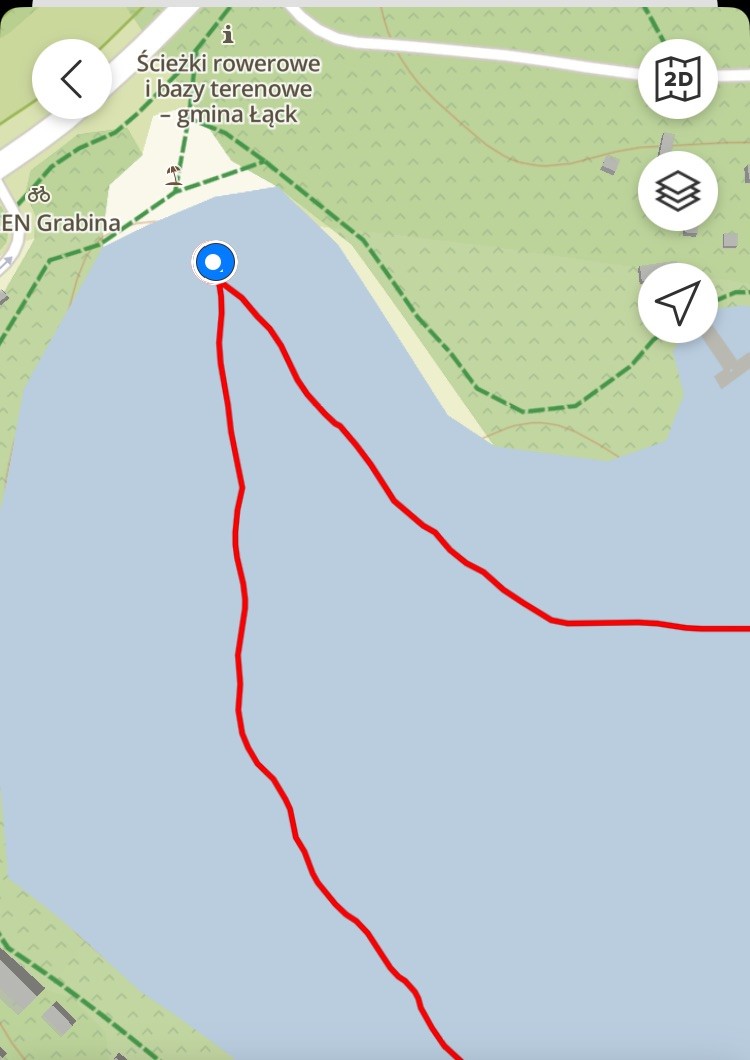

              @Pavlas I’ve reached 125km/h i am a ferryboat 😆
              By the way it’s the first time which i have GPS drifting in the water.
              Even when I’m trail running through very challenging and narrow gorges, the GPS performance is flawless.
              So I believe the issue is specific to the Open Water activity mode

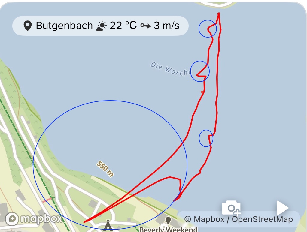

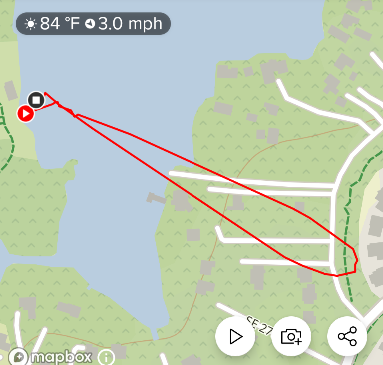

                        Unfortunately I have the same problem with my Vertical Steel Solar.
                        The GNSS is great in land activities, but in Open Water Swimming is criminally bad.
                        In my last swim I achieved a top speed of over 90 km/h.😬
                        Before the swim I have followed all the necessary steps for a good GNSS signal (update with Android App, and waited 5 minutes on land before starting the swim).
                        The old Ambit 3 Peak was perfect for swimming.
                        I’m really disappointed with the Vertical in this segment, currently it is practically unusable for any swimming metrics.
                        gerasimosG 2 Replies Last reply Reply Quote 4

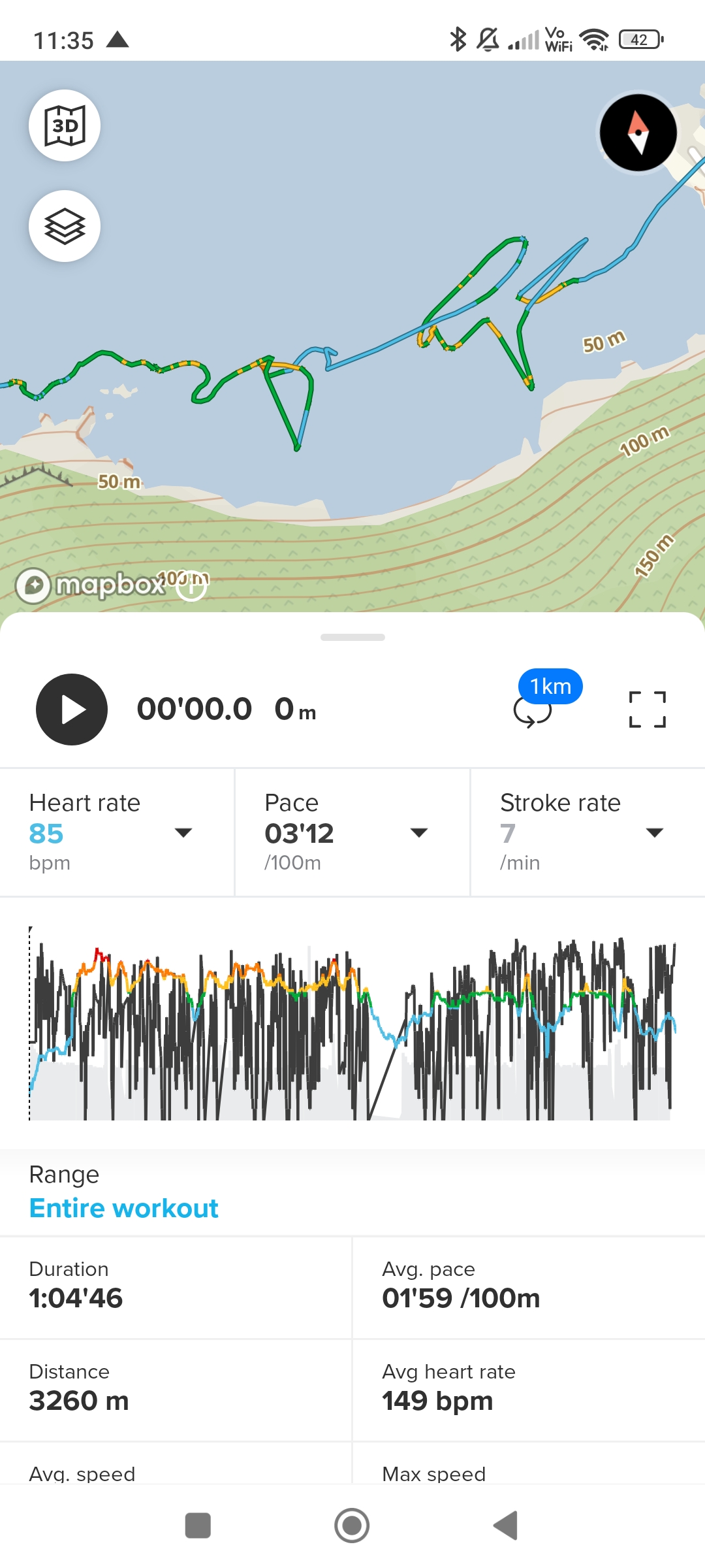

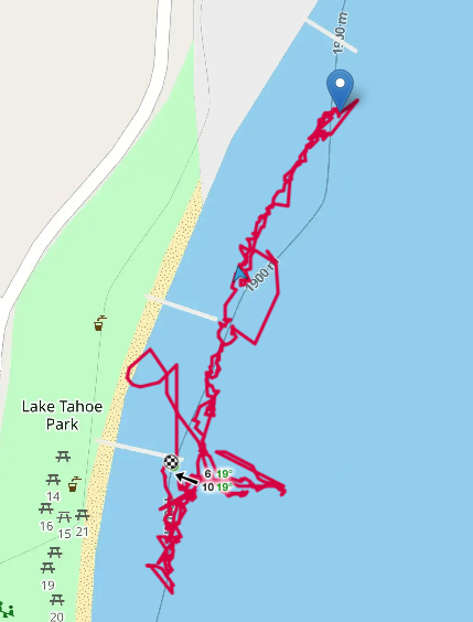

                                Fifth test in open water activity
                                1. I changed the watch to the other wrist (from left to right) in case symmetry during freestyle swimming was the issue.
                                2. I followed buoys in the sea that were in a straight line (500meter in one way).
                                3. GPS signal strength was between 75–85%.
                                4. Weather conditions were excellent – clear sky.
                                5. Brief stops with the hand completely out of the water for about 1 minute, to allow the signal to stabilize.
                                6. Never pressed paused
                                7. Before starting the activity, I waited 5 minutes after the GPS indicator turned green, for better locking, and of course synchronized with the app.
                                — Unfortunately, still very poor results (after last upgrade), even after a soft reset / profile deletion and creation of a new one same results and with default openwater profile.
                                Next step: Hard reset and test again…

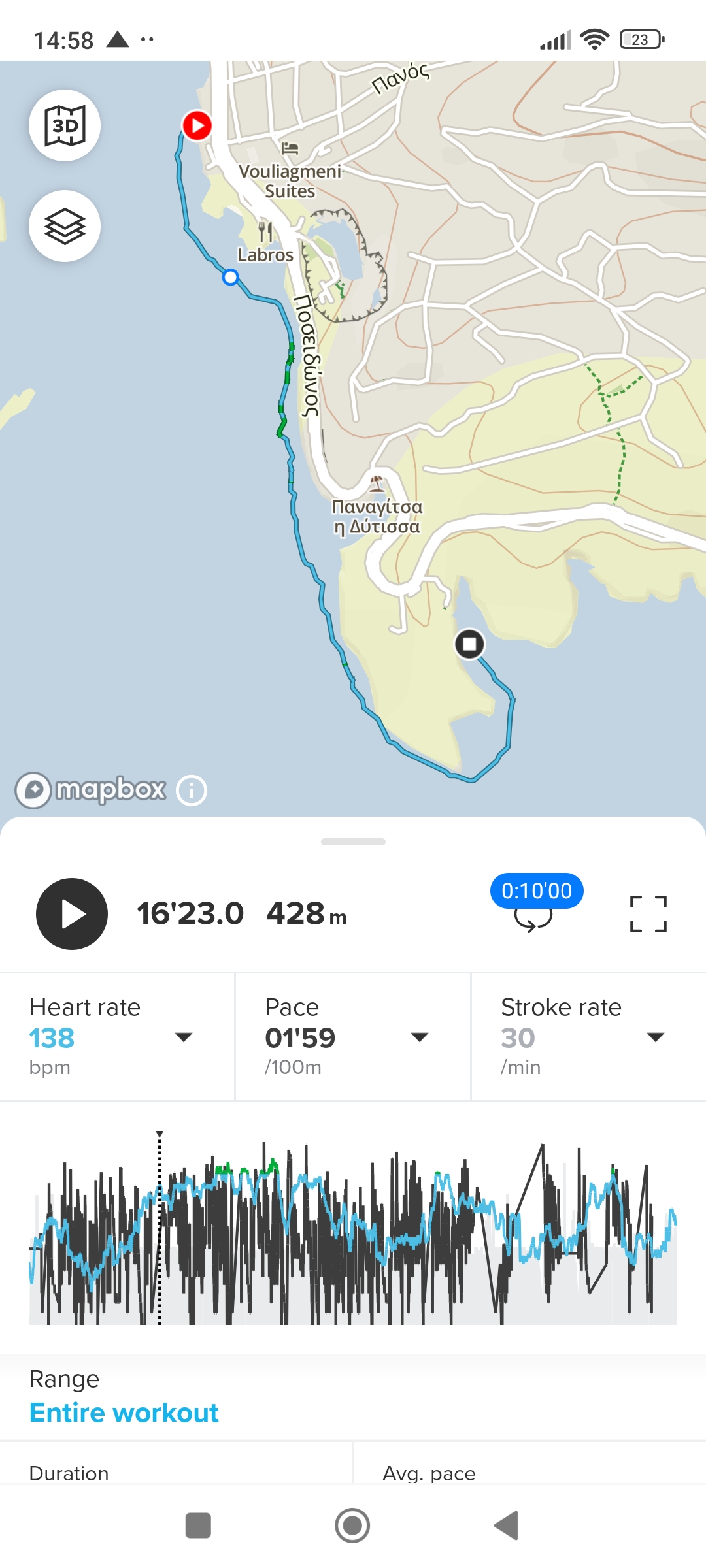

                                      @Artus-Diver this such a small deviation in the GPS is (in my opinion) absololutely nomral in a sea or lake enviroment
                                      Suunto Vertical Ti
                                      Suunto S9 gen1
                                      Suunto Ambit3 peak

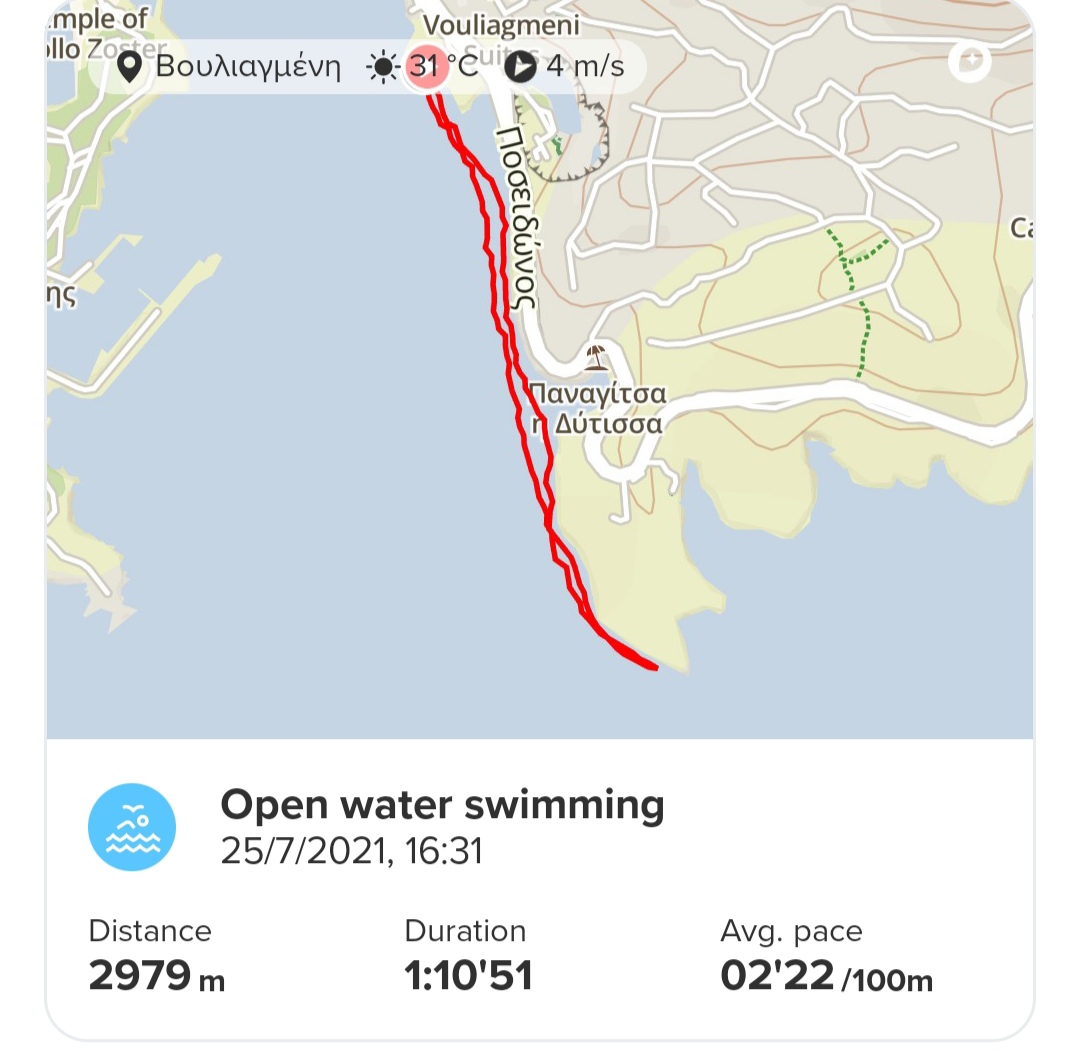

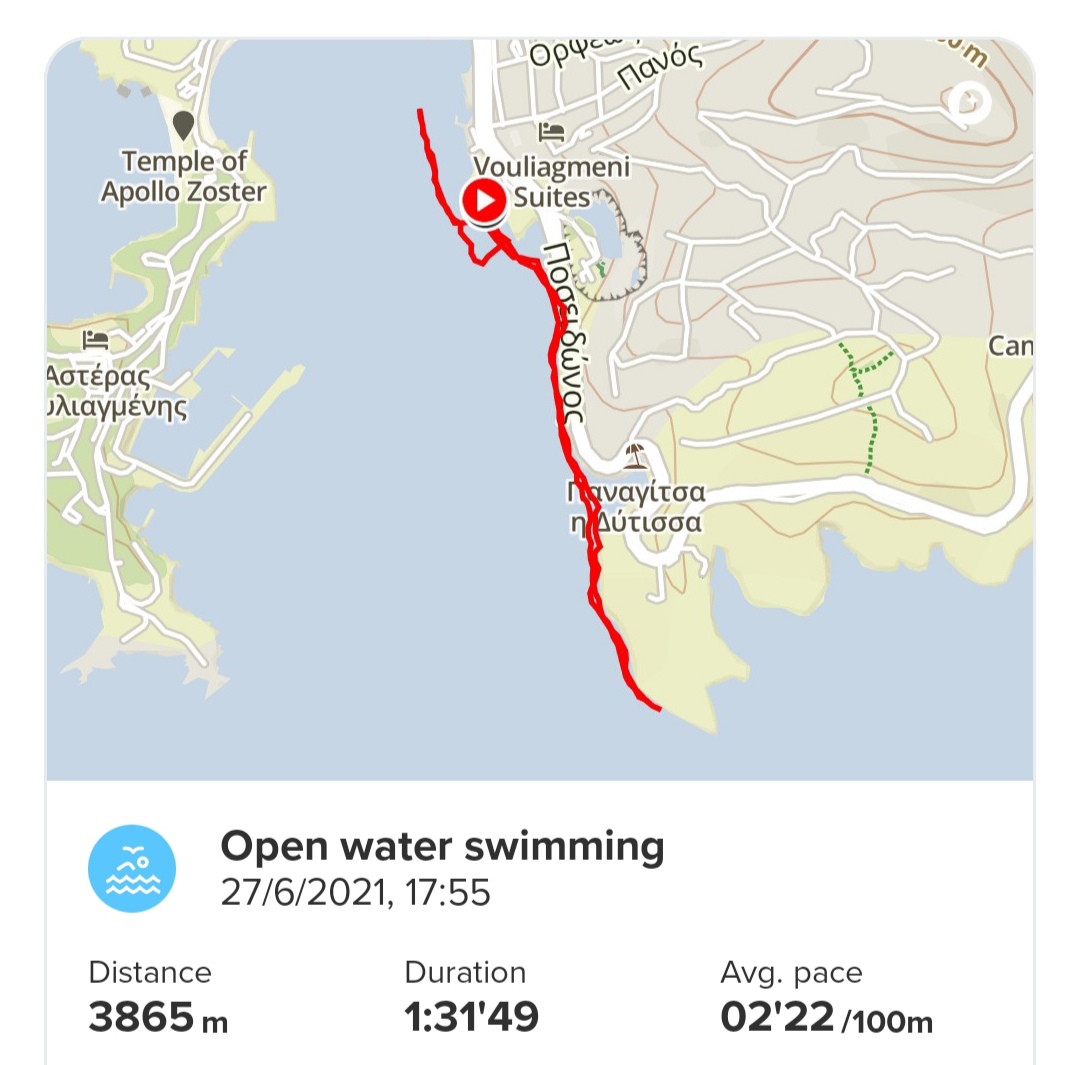

                                        Artus Diver @gerasimos
                                        @gerasimos

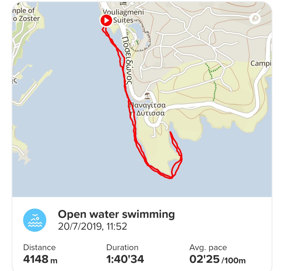

                                        Of course, as I mentioned, I don’t have a major problem, but comparing my previous tracks from before the update, they look much better.
                                        I think Suunto should investigate this.
