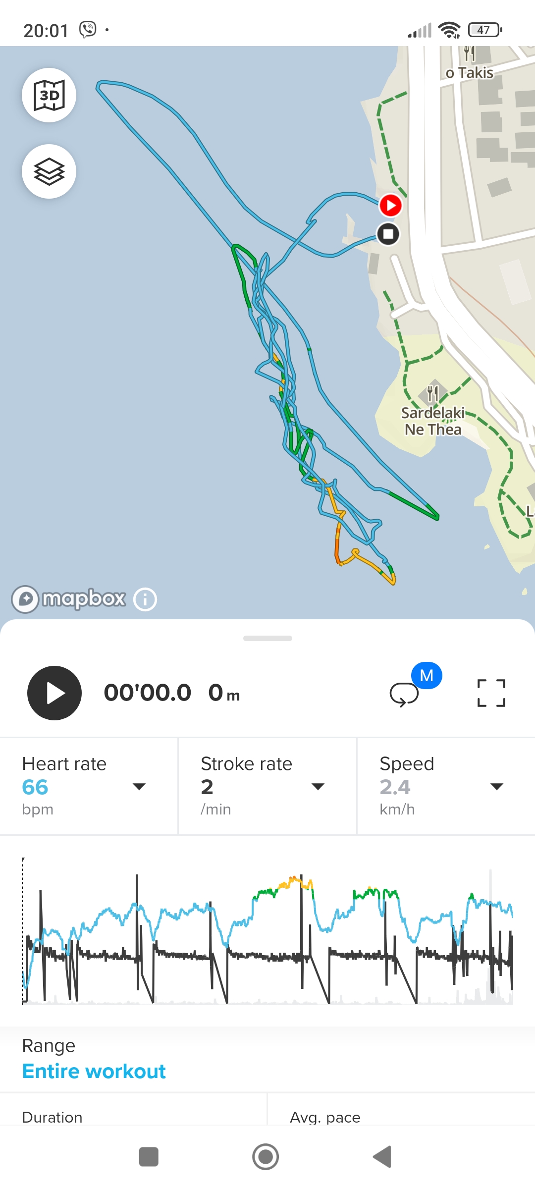

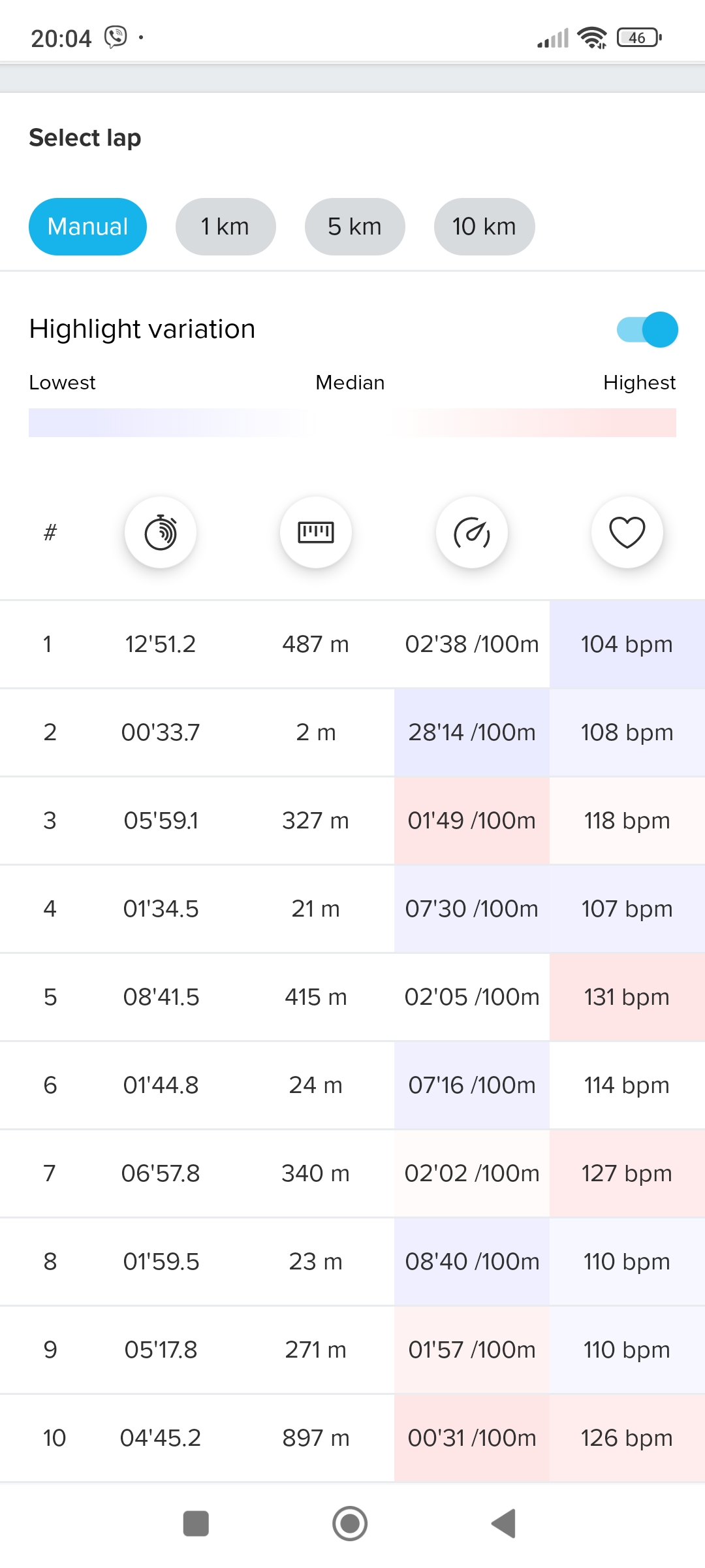

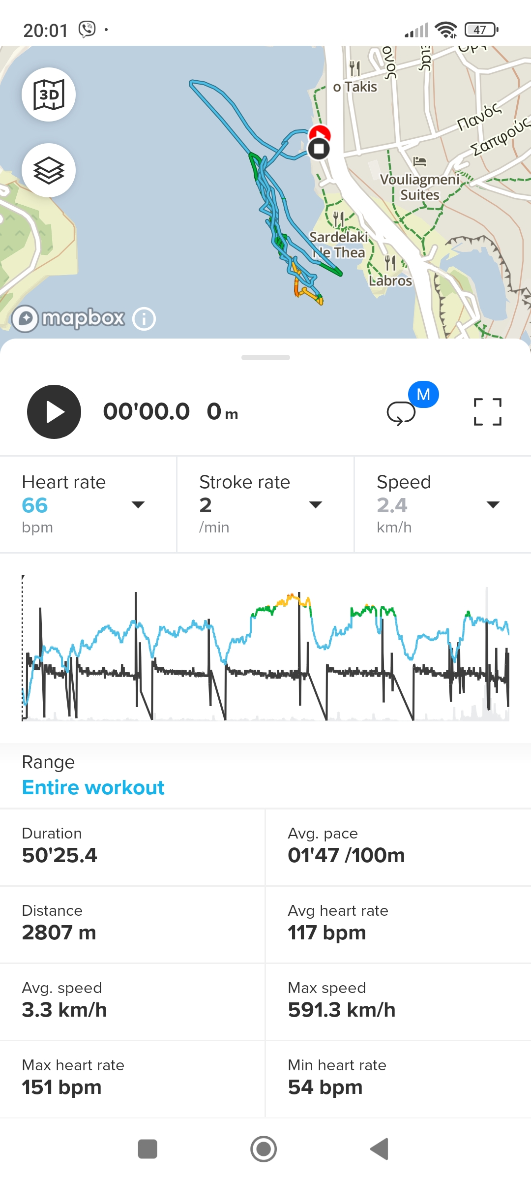

                                    • gerasimosG Online
                                      gerasimos Bronze Member @Theo Lakerveld
                                      @Theo-Lakerveld
                                      After a Factory reset, I followed the entire protocol for optimal GPS signal acquisition, just like I always do.
                                      There was absolutely no improvement — the same drift and many signal reflections over a distance that is exactly 500 meters in a straight line, marked with buoys.
                                      I was pressing lap time as a reference to record the distance, and the discrepancies were 200 to 300 meters every time I completed this route.
                                      Weather conditions were perfect — clear skies, and my hand stayed out of the water for 30 seconds of rest before starting the next set.
                                      -Hard reset didn’t help-
                                      I’m starting to believe this is a serious firmware issue and unfortunately can only be fixed with a new update.
                                      Otherwise, the watch has a severe limitation in this specific function, which is unfortunately very important for my training.
                                      Also I’ve achieved again 591km/h I think it’s a very solid performance for my swim freestyle technique 🙃
                                      However, the watch continues to function perfectly in all other activities, with highly accurate GPS and absolutely no issues.
                                      Screenshot_2025-07-19-20-01-39-109_com.stt.android.suunto.jpg Screenshot_2025-07-19-20-01-29-558_com.stt.android.suunto.jpg
                                      Suunto Vertical Ti
                                      Suunto S9 gen1
                                      Suunto Ambit3 peak
                                      Ze StuartZ Theo LakerveldT 2 Replies Last reply Reply Quote 0
