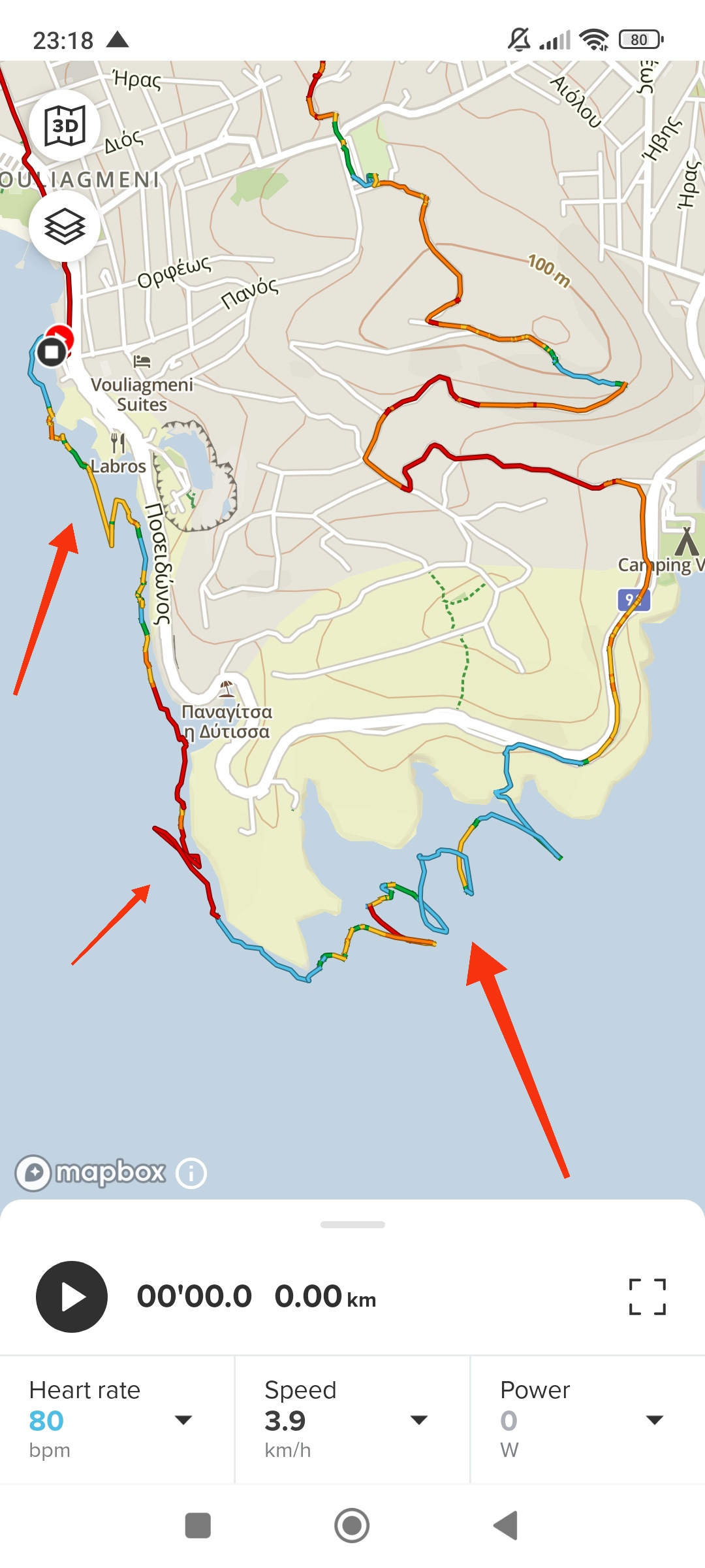

      I also did a test today with significantly better performance and minimal reflections using the open water mode.
      I was swimming side by side with a SUP that recorded exactly 1.1 km using a Garmin Fenix 7 while I recorded exactly 1.2 km with open water swimming, which is a perfectly acceptable discrepancy.
      At the same time, I did a hike to the top of the island and then returned to the shore with the SUP, completing the activities.
      The GPS in all cases was excellent compared to yesterday.
      However, I’m not sure if the GPS gets confused or causes reflections when there are many speedboats, boats,jetski etc., in the area here in Greece have a lot of—maybe that’s what throws off the watch.
      1. https://maps.suunto.com/move/gerasimosmitropoulos/687d05325bb5463b5908f20c
      https://maps.suunto.com/move/gerasimosmitropoulos/687d055e40105778ecb0b066
      The part where the GPS looks tangled is because I was inside a cave.

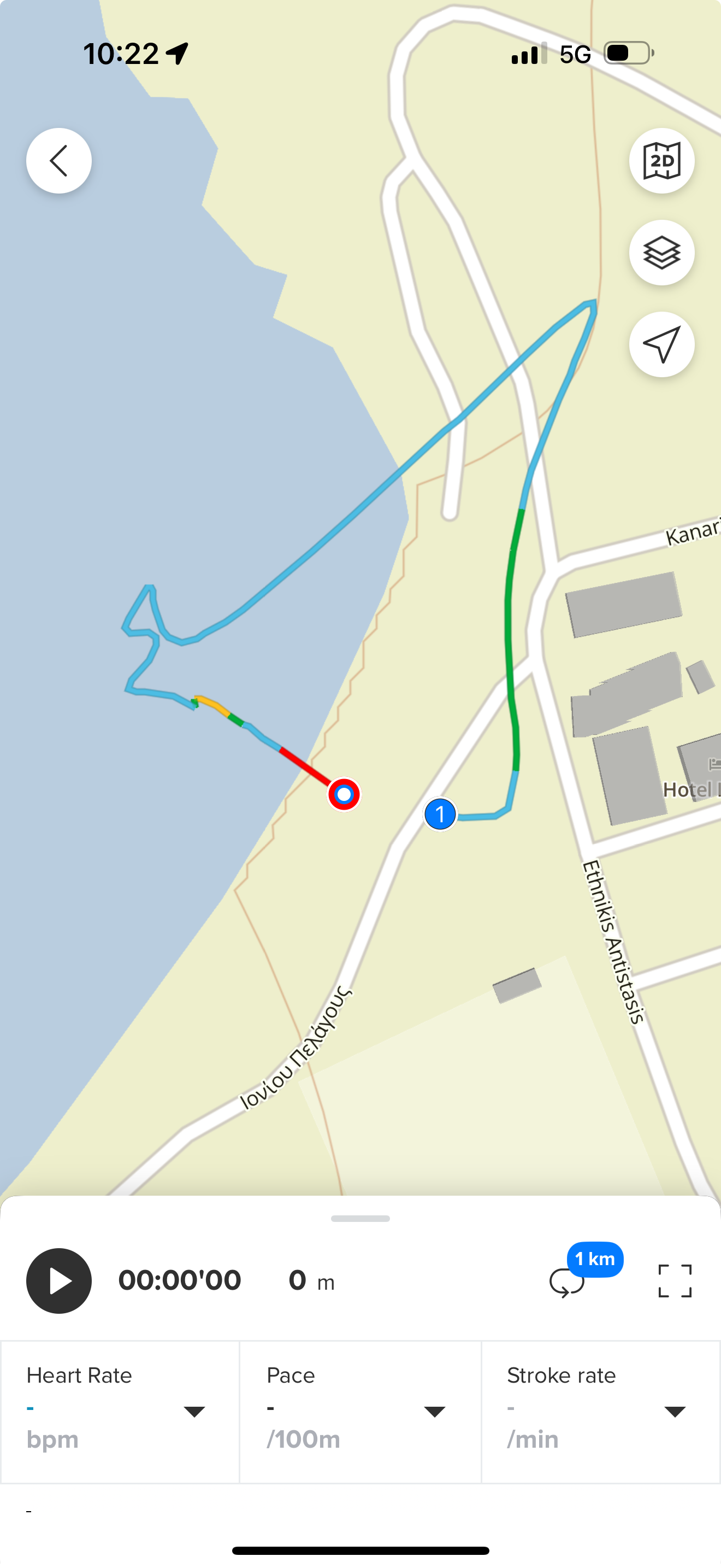

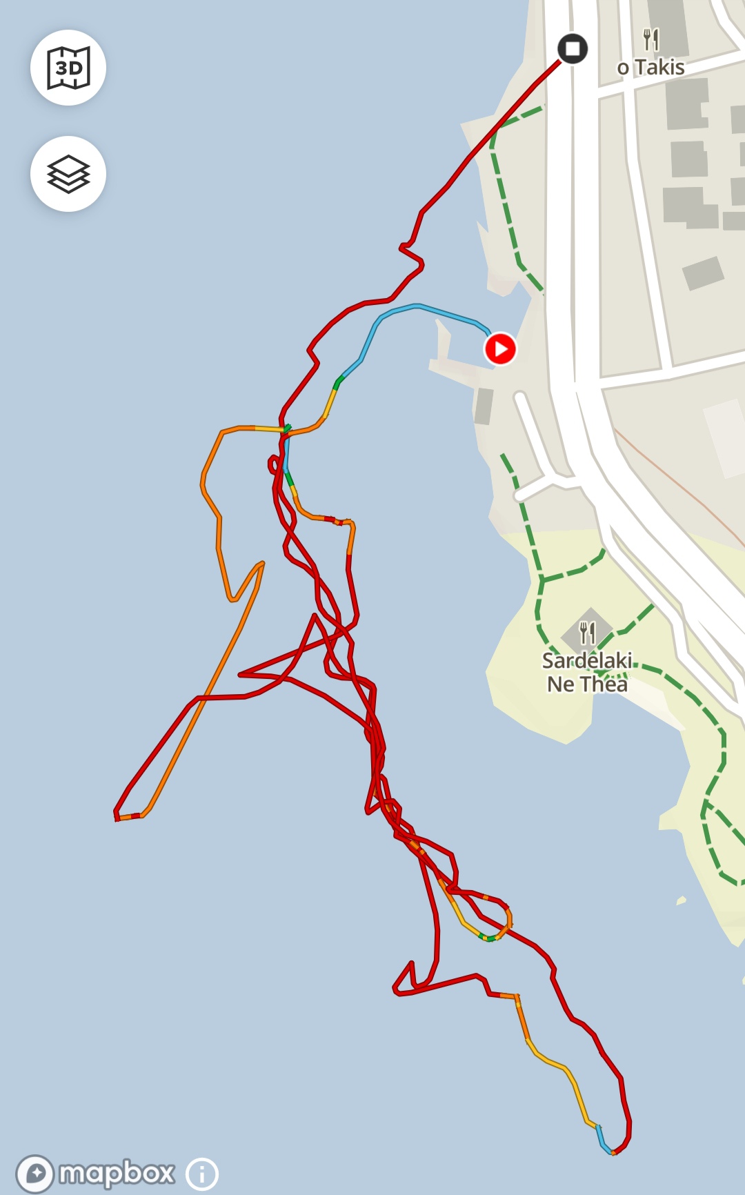

            I did another test with a multisport activity — open water swim and trail run — but unfortunately, the results for the open water tracking were disappointing.
            I swam a distance of approximately 2,850 meters, but it recorded over 4,700!! meters due to excessive GPS drifting. (…a significant discrepancy compared to the actual distance.)
            Of course, before starting the activity, I followed the entire protocol to ensure the best possible GPS accuracy.
            However, once I started the trail run, the watch functioned perfectly in every aspect, as it always does!

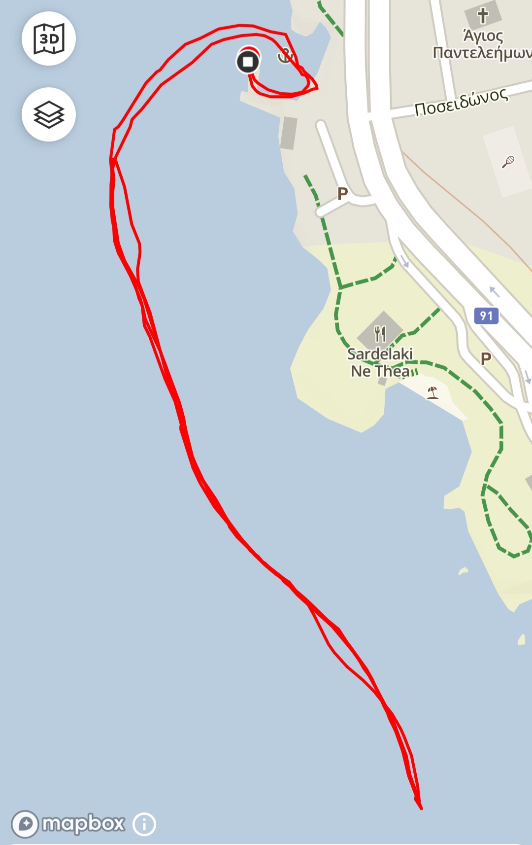

                        I recently repeated a test on the same open water swimming route I had done before, where I had previously tracked the session with the watch on my wrist. This time, however, I placed the watch inside my swim buoy instead of wearing it, and the GPS tracking was flawless — very accurate throughout the session.
                        This confirms that the Vertical(at least in my case) performs significantly worse when it’s worn on the wrist and goes in and out of the water. Some deviation is always expected in open water, but the level of inaccuracy I’ve been seeing lately — especially after the most recent firmware update — is far beyond what I’d consider acceptable.
                        The only downside of placing the watch in the buoy was that I couldn’t record stroke count, SWOLF, or heart rate, since I didn’t have a second watch on my wrist. I was just wearing a basic Casio for time / stopwatch.
                        -That’s the end of my tests (after soft reset, hard reset, protocol sequency for best GPS, correct swim technique, etc …)
                        i hope an GNSS upgrade in the next software update.

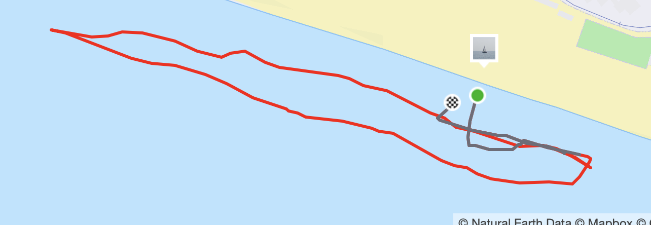

                              In case anyone has forgotten what a good OWS track looks like, I used… another watch yesterday. I was using my FORM goggles, with their swim straight feature (shows a compass heading live as I swim, so I can be confident of swimming in a straight line).
                              My inflammatory post aside, has everyone logged this with Suunto support, with a reference to this thread?
