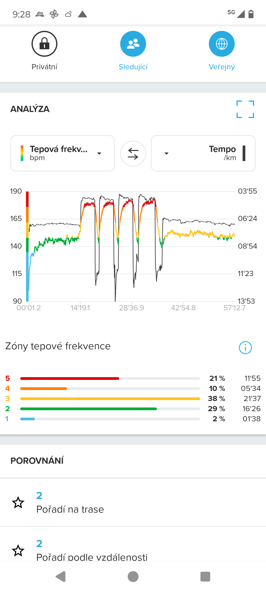

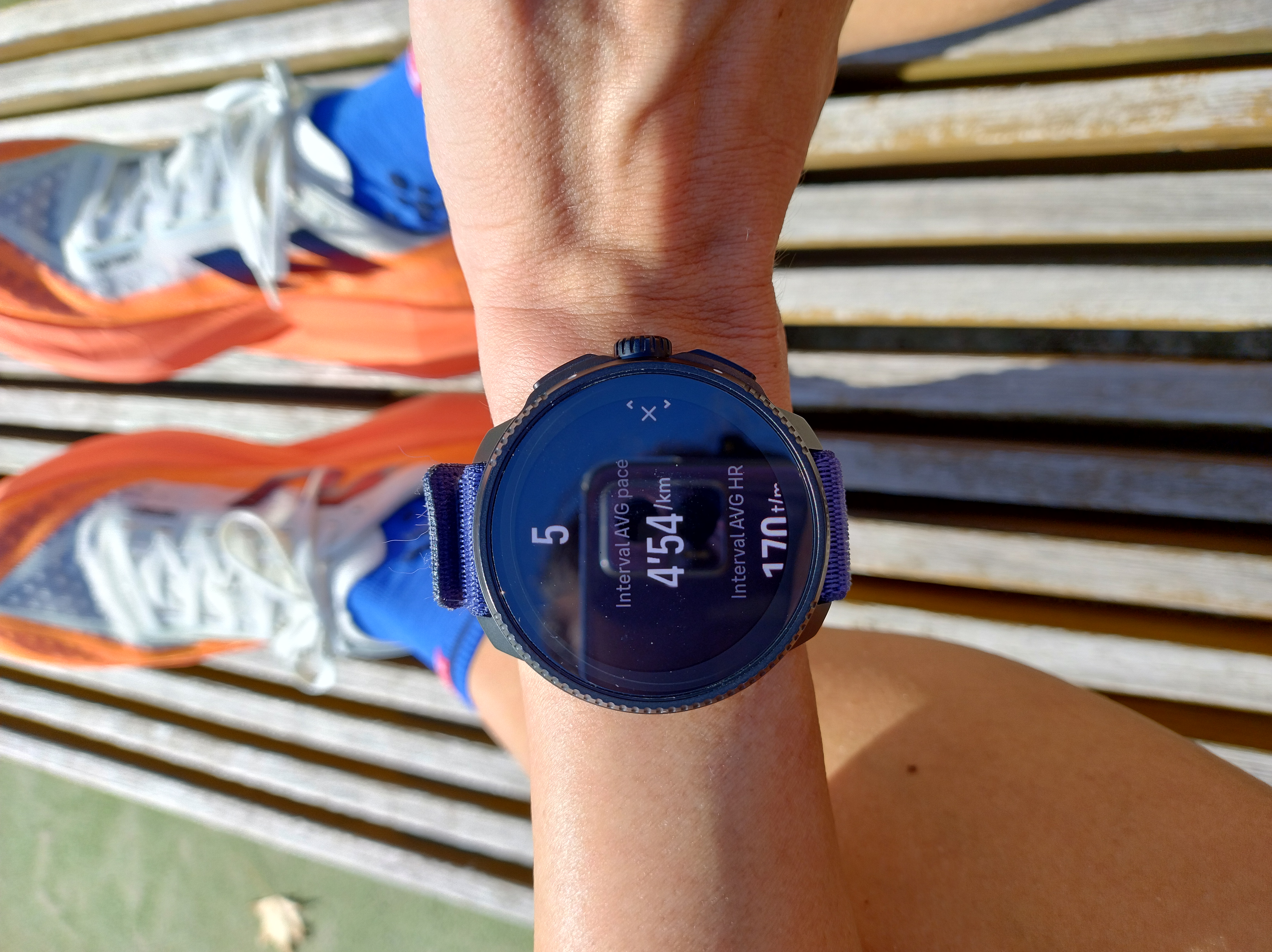

      hi, I want to ask about the VO2 max values. I’ve had the watch since April of this year. I switched from Garmin. Last year, in my best form, running at a pace of 6.50, heart rate of 145, Garmin gave me an estimate of VO2 max of 49. Now I’m in much better shape, with a pace of 6.30, average heart rate of about 138-140, and my VO2 max is 45. At the end of April, I also took a threshold test with the watch, where I got a pace of 4.56, average heart rate of 176, which was also the estimated lactate threshold. I set it to the beginning of zone 5. I run, mostly zone 2, but also tempo runs and interval training. Today I completed a 2 km warm-up training, then 4x4 minutes at a pace of about 4.34-4.37. I even set a record for 1 km. I’m attaching photos. then cool down 3km I don’t understand why my vo2 max doesn’t go up at all, because I’m in the best shape right now. Can anyone give me advice on how to increase it? I’ve already thought about cutting the warm up and cool down.1000016738.png 1000016737.png 1000016736.jpg Thank you for your knowledge. It’s frustrating when I can actually see that I’ve improved and it doesn’t change at all. It’s clear that if I go trail running it will go down, but I don’t understand the rest.
