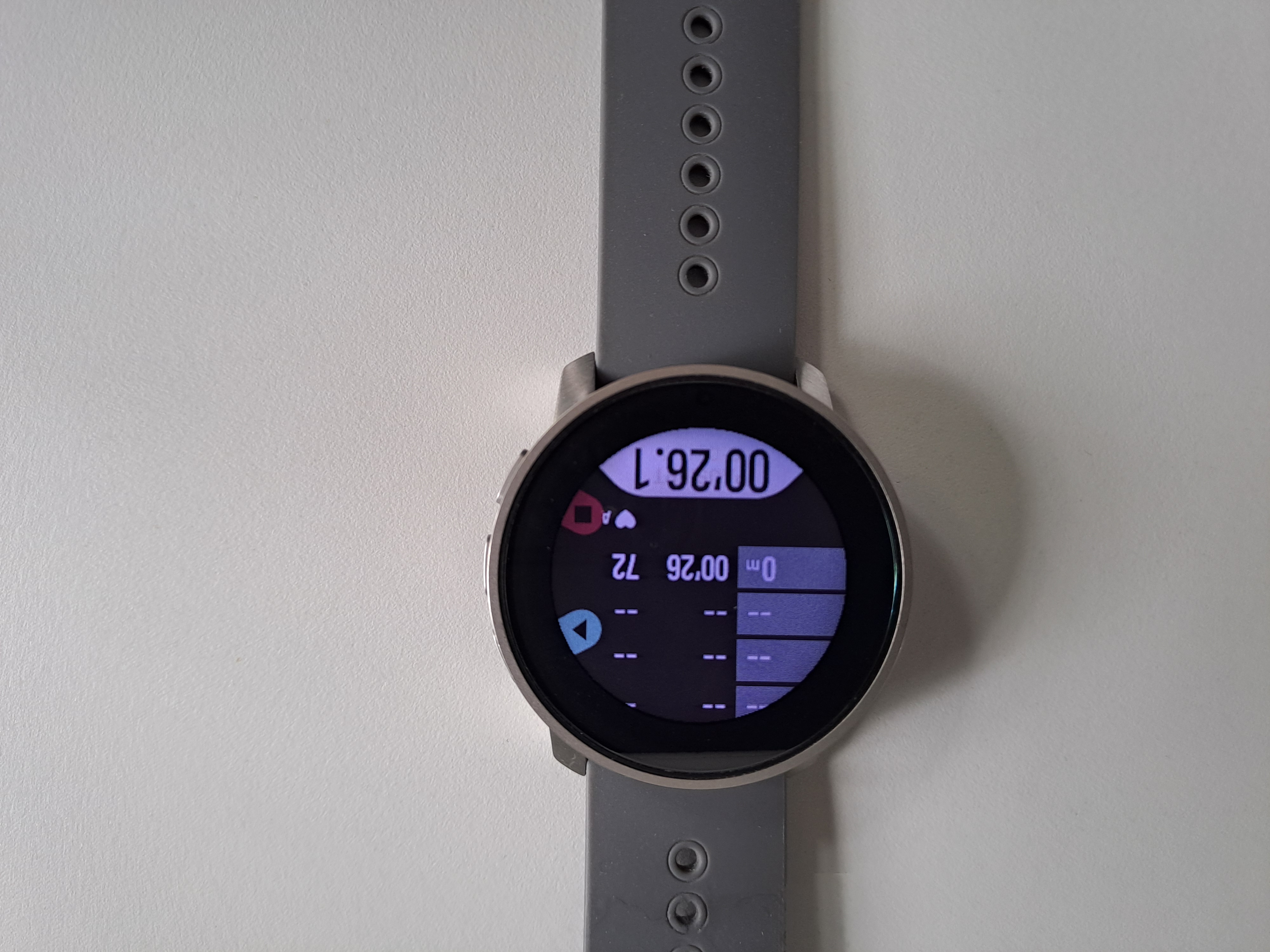

      I ask for help because I’m not able to call the submenu as described in the manual when I’m in autostopp mode. It shall be possible to call the current day time / battery load by pushing the upper pop up button (soft). Neither the button appear nor I can push somewhere else?

        The manual is not correct, to display time and battery you have to press the middle button instead the upper one.

          @wotus : thx - but doen’t help.
          Got a display shown lap times ??
          L M 2 Replies Last reply Reply Quote 0
            larrybbaker @UweMt
            @UweMt keep scrolling?

              MKPotts Bronze Member @UweMt
              @UweMt
              You are reading the manual for the 9 Peak but the watch you are showing is the 9 Peak Pro, which has a significantly different menu system.
              When the watch is paused, to see the time use the middle button to cycle to a data screen that has the time at the top. To see the battery level, either:
              1. press and hold the bottom button, which will take you directly to the control panel screen, which shows the charge %, or
              2. press the bottom button once and then select control panel from the menu, which then takes you to the same place.
                You can also do 1) to see the battery charge without pausing the recording.
              I don’t use autopause but this is how it works with the 9 Peak Pro after manually pausing, so I expect it’ll be the same in autopause.
