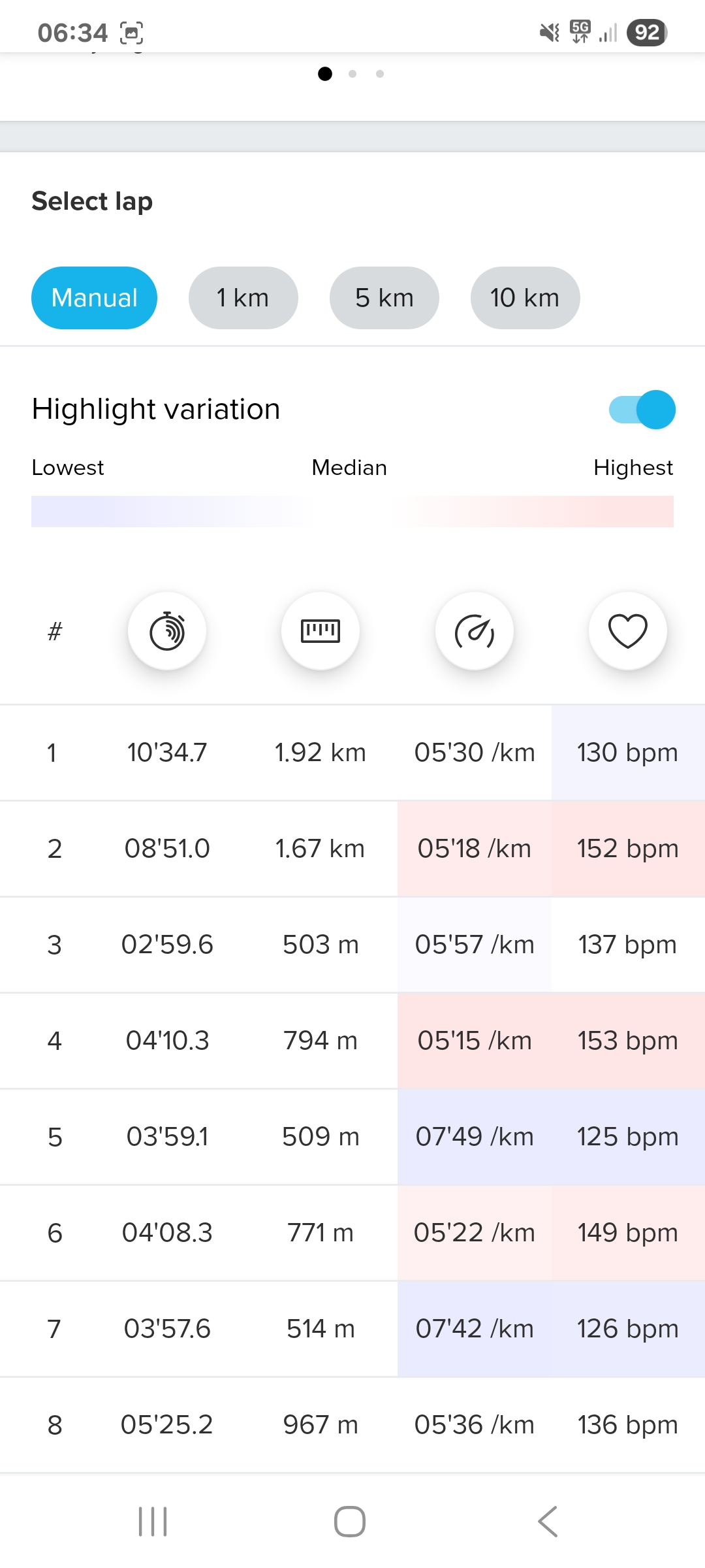

                  I did a run yesterday on the treadmill
                  2km@5:21
                  2km@4:25
                  0.4km@7:30
                  1km@4:08
                  0.4km@10:00
                  1km@4:08
                  0.4km@10:00
                  1km@5:21
                  All of it was done on 1% climb and I have a Norditrack commercial 1750 (not that it matters)
                  Here is how suunto recorded the pace:
                  As you can se only the first and the last interval are near the pace (as the last run was in that neighborhood), everything else is way off.

                    @Ketoohs said in Treadmill - adjust distance bug or useless feature:
                    And you know why?
