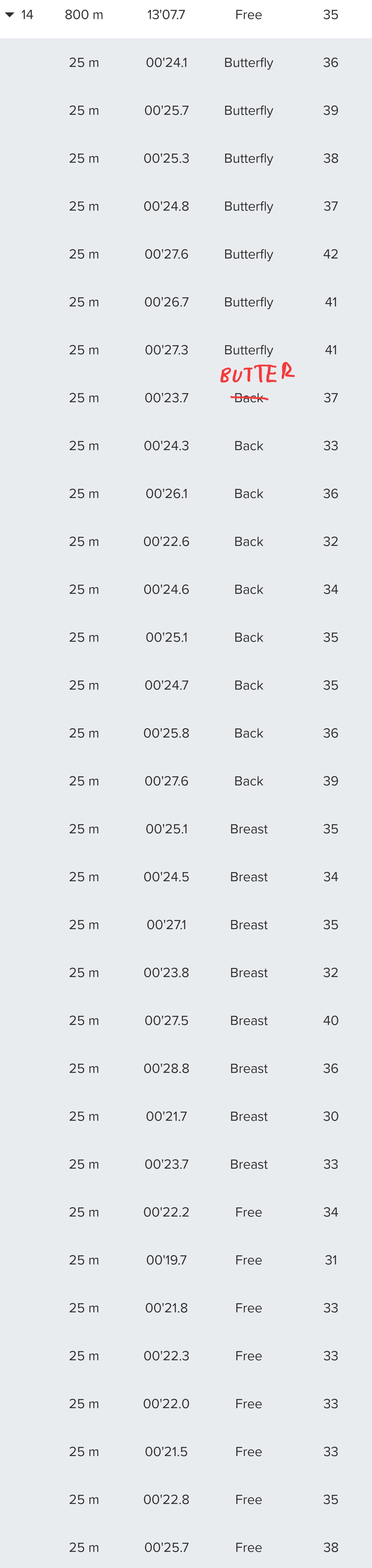

                            Александр Даниленко @Ars Vitae
                            @Ars-Vitae as far as I was checking style detection in Suunto (using from autumn 2023) style detection was always terrible. Completely.
                            After last update I was surprised in this aspect. At least it works now for me better than before, but still there is room for improvement.
                            For example, here I did 800m Medley swimming (so it was 200m by eash stroke). Only one mistake:
                            It is Suunto Race S
                            Ars VitaeA 1 Reply Last reply Reply Quote 0

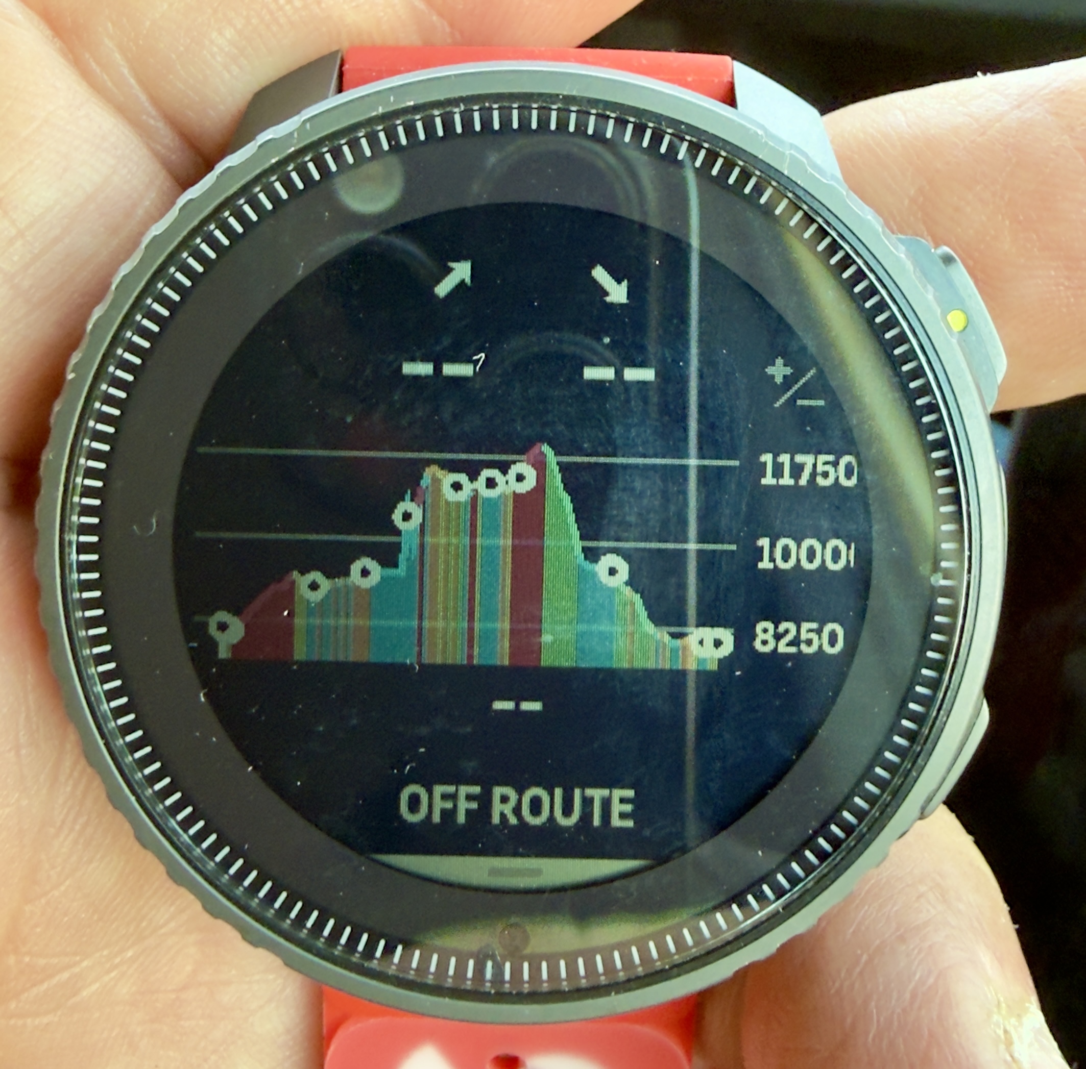

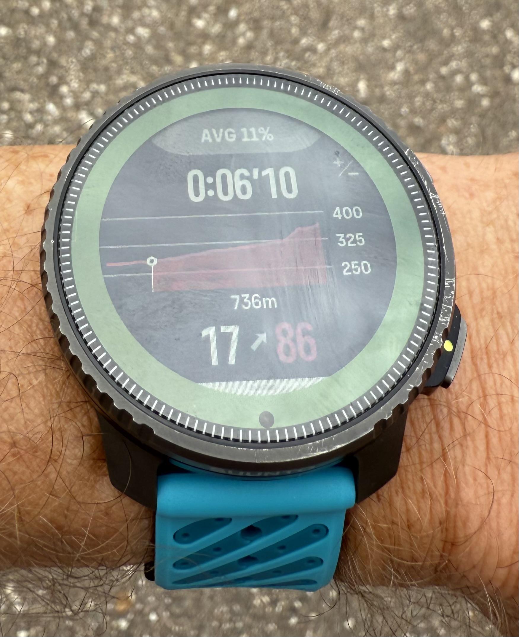

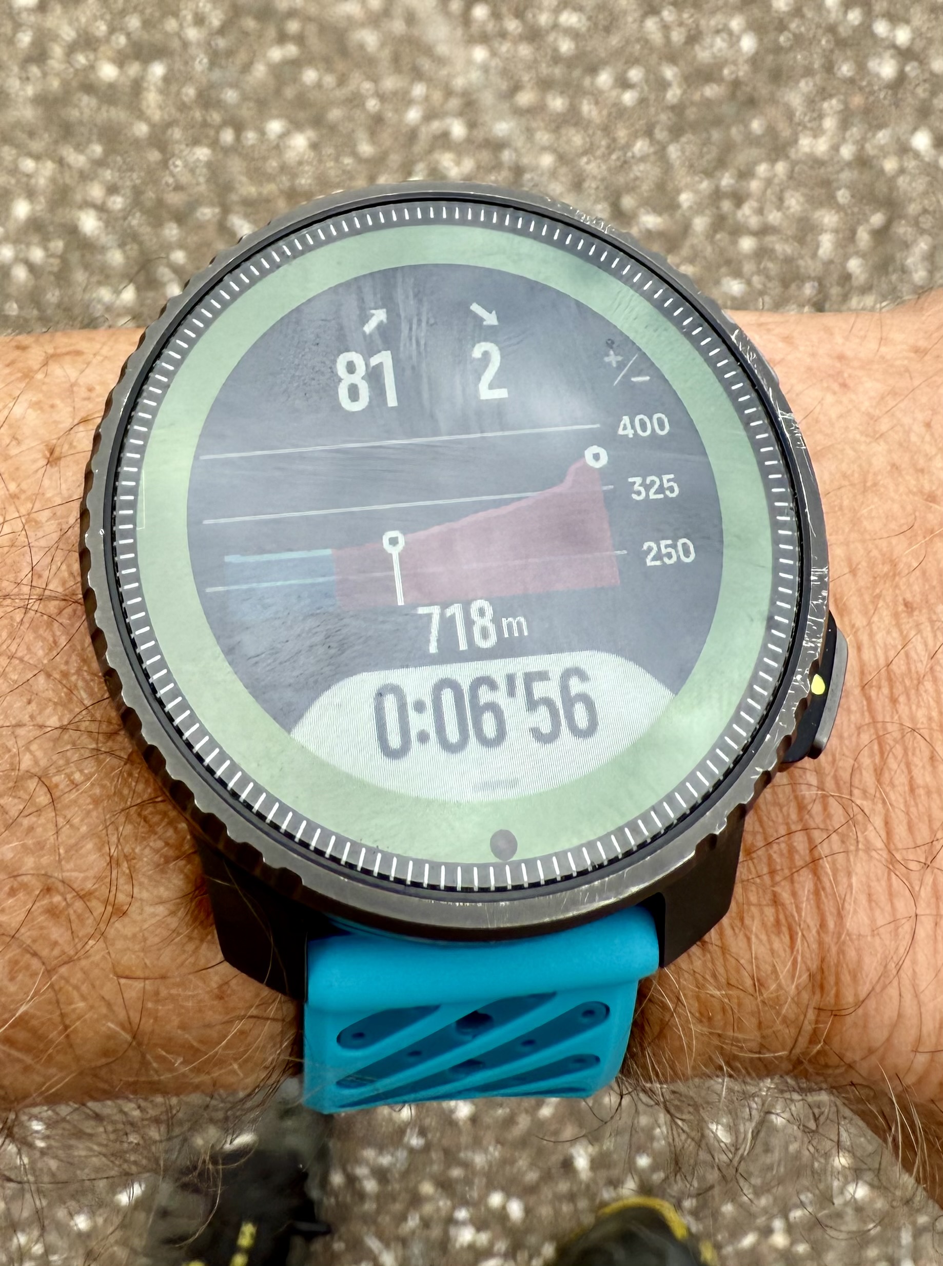

                              sky-runner Platinum Member @Tieutieu
                              @Tieutieu said in Software Update 2.44.46 (2025 Q3):
                              Climb guidance on routes with waypoints => no possibility to zoom in into current segment and so no %of climb displayed anymore in this case. huge regression/miss.
                              This is how it was designed - as soon as there is at least one waypoints, climb guidance switches to the new mode where the overall profile is broken into segments by waypoints.
                              I agree that there should still be a way to zoom into individual climbs or descents. That should work OK if the two climb guidance modes are visually distinct enough so that users aren’t confused.
                              • Ars VitaeA Offline
                                Ars Vitae Silver Members @Александр Даниленко
                                @Александр-Даниленко Lucky you. I counted at least 9 mistakes on 1,500 meters (I didn’t count all the complicated drills but it still counted several lengths with mistakes).
