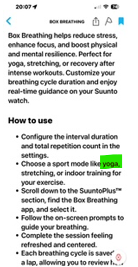

          sartoric Moderator
          It’s in the app description
          “choose a sport like yoga, stretching, or indoor training”
          then you’ll find the S+ app

              Mattg576 @sartoric
              @sartoric
              Thanks, I’ve just looked in Yoga & it is there👍
              Rather odd that you can’t use it in Meditation which is in the same group of sports mode as Yoga & probably the mode most likely to be used with it…

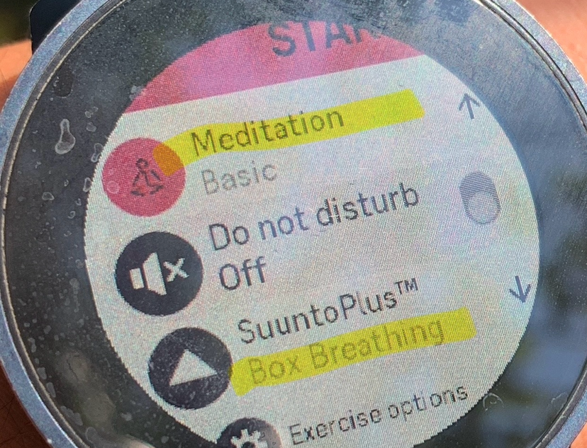

                  sartoric Moderator @fv4500
                  @fv4500
                  I see it too but you can’t choose it from the list or disable it.
                  maybe it’s a default of that sport, maybe a bug 😁

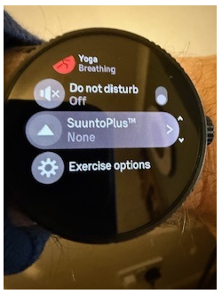

                    • Francesco PaganoF Offline
                      I used the Box breathing app when it came out with Yoga sport mode, now
                      • I can’t select it with Meditation sport mode (custom and default).
                      • I can’t un-select it with Yoga (it’s enabled, but it doesn’t appear in the SuuntoPlus list of Apps). This is a custom mode.
                      Additionally, I created a workout in intervals.icu for breathwork. Workouts normally go under Suunto Guides. I can’t select any Guide with Yoga and Meditation (default and custom), but I can use it with the old sport mode Yoga/Pilates.
                      At the moment the list of sport modes includes Yoga/Pilates, Yoga and Pilates, plus Meditation, and clearly something is not working for those that were released later. At least they don’t seem to include Guides.
