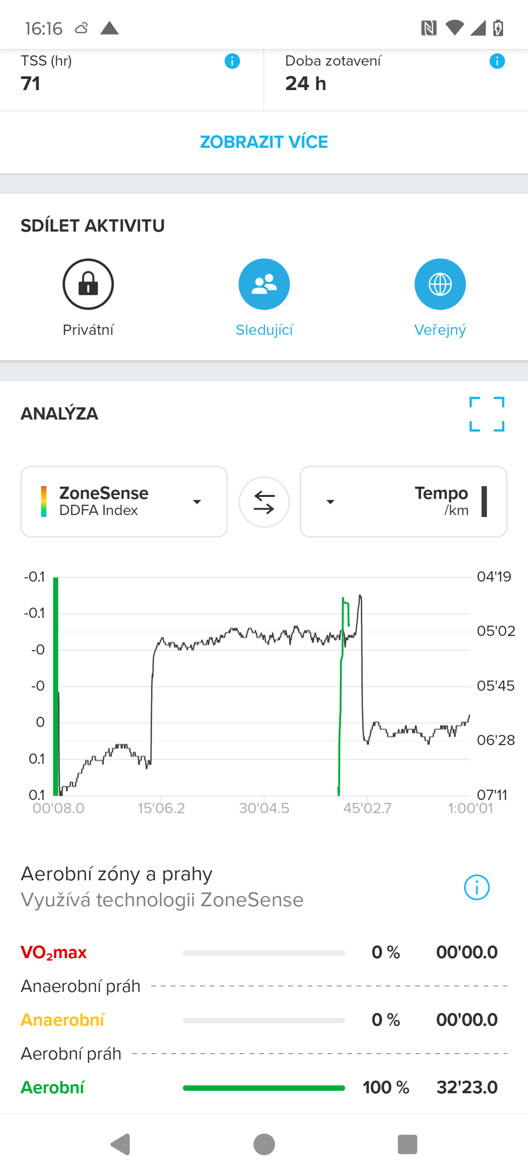

      hi, I need some advice. my chest strap broke, I currently have a polar H9. I have a new battery in it. but I don’t know if there is a fault in the chest strap or if the chest strap is simply disconnecting from my watch. today I went for a 2km warm up then a 6km tempo run and then about 2.5km cool down. my heart rate was measured incorrectly on the first kilometer, around 90 beats, which is unrealistic. the subsequent tempo run my heart rate was around 170-175 beats according to my feeling, but when I looked at the watch it was so bad 3.4.5 km is total bullshit. in the app when you look at the laps the heart rate is so totally unrealistic, what surprised me is that in Strava my heart rate is good. Zonesense also didn’t measure anything. I’m sending you screenshots from both the suunto app and the diet. I don’t know where the error could be. I suspect that the watch is disconnecting the heart monitor! Thank you for your advice

        @Miroslava ZS not measuring anything suggests a very unstable R-R stream. If you see a wide cloud of points for the R-R data (I use runalyze to check that) you can try to clean your strap. If it is an old strap, maybe it reached its end of file.

              @isazi thanks for the observation but the polar h9 is new both the sensor and the belt, so that’s why I don’t understand it, but I gave it to a friend to take a look at because it’s very strange behavior. that’s why I wrote here that where could be the problem. so far my old h10 has worked beautifully for me and so has zonesense. I also want to ask does zonesense still only work with a chest belt? I read somewhere that it should also work with optical sensors
