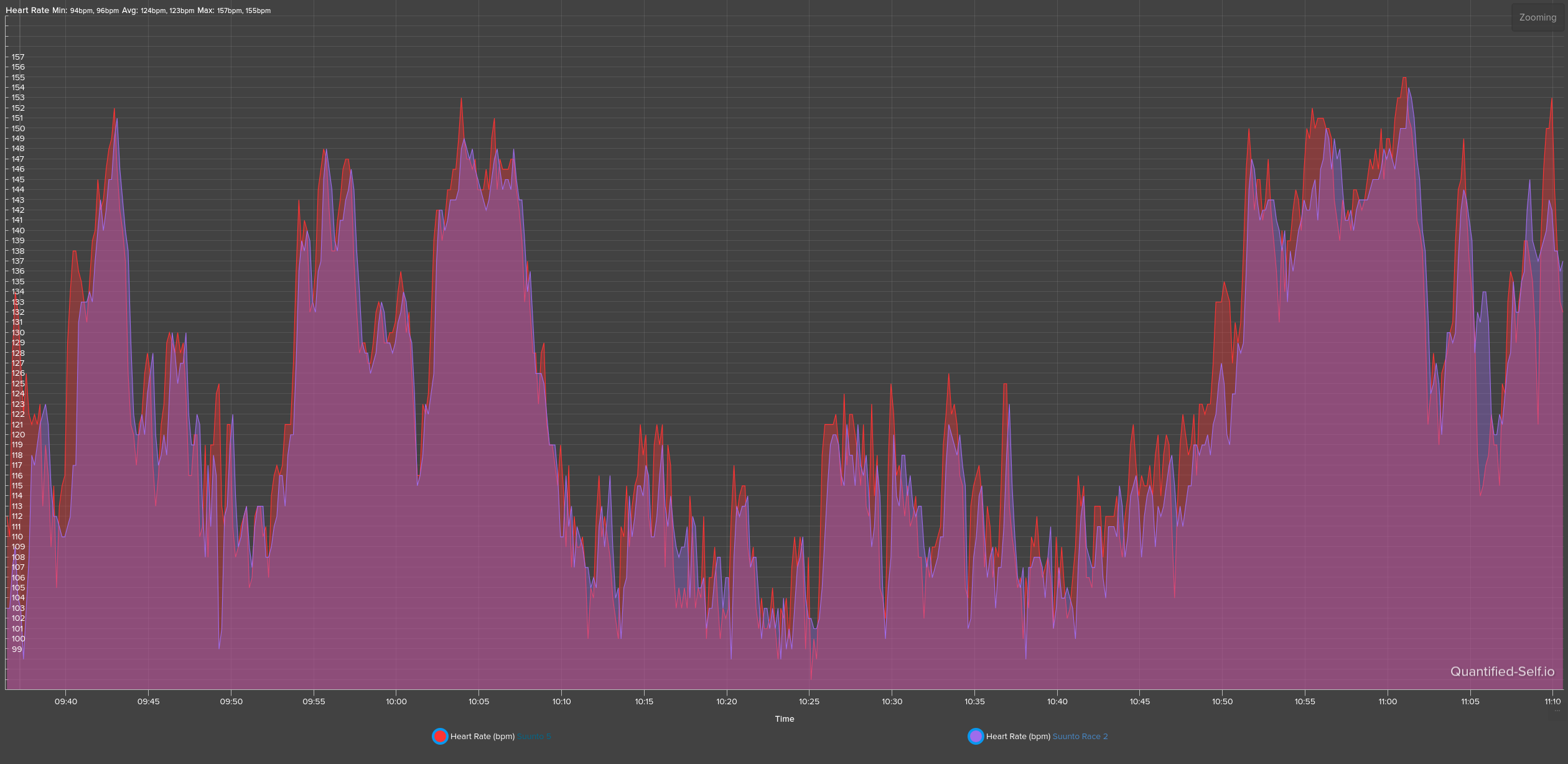

      Today I did bike ride, almost all it was done on asphalt road. Here is comparison of Suunto 5 (using Suunto Smart Heart Rate Belt), and Suunto Race 2 OHR sensor.

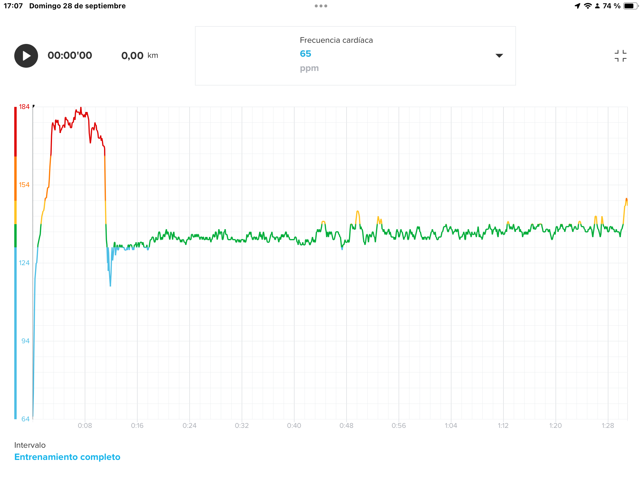

        Yesterday during a long run. Constant pace all the way.

          Ok so I am not alone with those crazy high bpm in the beginning of each easy run…

              @sorinus try to wait minute or two after watch lock on HR before starting your excercise.

                    @Matteiva my test from bike ride turned out good. Comparing to chest strap. I will do similar for walking activities. I am suspiciouse there is possible cadence lock when watch is not tight on your wrist. But i will see after comparison with chest strap. Hope i will find time to test this week.

                      With old Suunto 5 i hade from time to time crazy high HR measurement using OHR sensor. At least this didn’t occured yet on Race 2. So big improvement in that for my.
