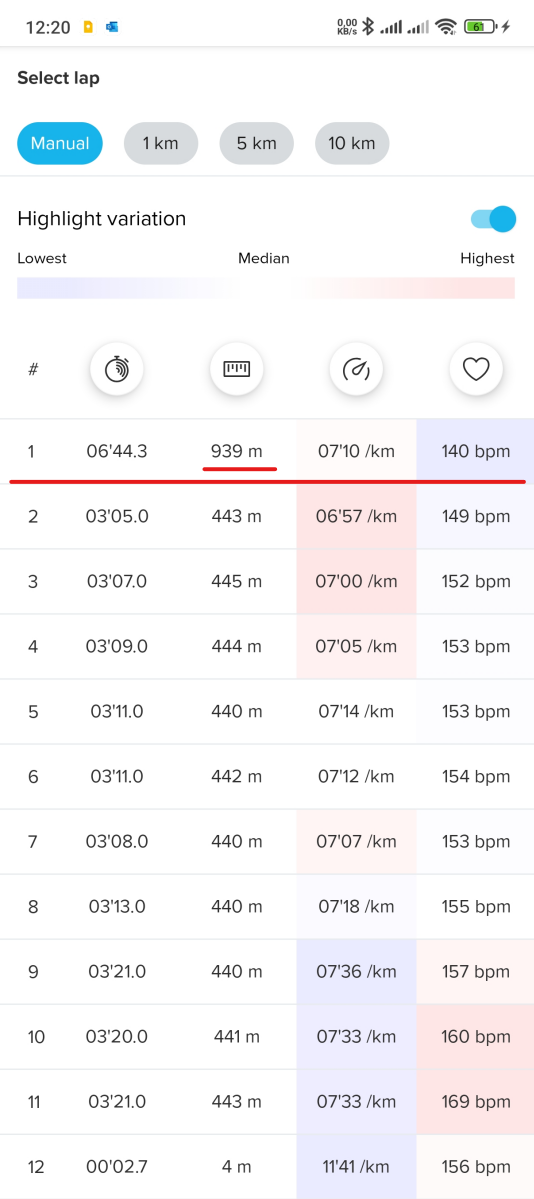

      Hello,
      I use the SUUNTO Plus Loop pace app and I noticed one flaw.
      When I go running on a circuit, I start running from my house and run about 500 meters to the stadium. There, I manually start the automatic interval distribution. A new interval is created when I pass a certain point.
      However, the first lap of the circuit is connected to commuting at the stadium. I don’t know why this is the case, and it doesn’t make much sense to me. Shouldn’t an interval be created automatically when intervals are started manually?
      The first interval consists of commuting and the first lap.
      Suunto Core (17y)
      Suunto Vertical Ti
        smopi
        Hi @segi_pn I have the same problem on my Suunto Vertical with the latest FW version.
        segi_pnS 1 Reply Last reply Reply Quote 1
        • segi_pnS Offline
          segi_pn Bronze Member @smopi
          @smopi Yes, I have the Suunto Vertical too. I had this problem with previous FW versions as well. But only now have I gotten around to writing this post.
          Suunto Core (17y)
          Suunto Vertical Ti
