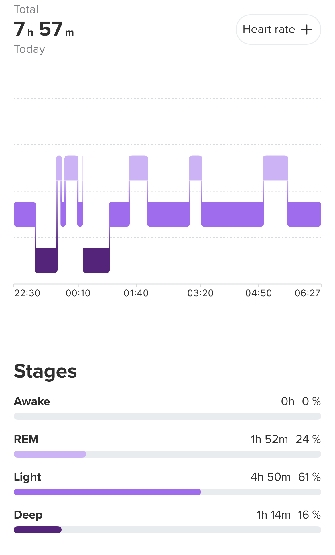

        @gogapo not sure if it needs to calibrate but for me it measured first night with R2 like this: 52390045-c11b-4f6e-b76f-832aef0dc849-image.png
        It looks normal to me. I was awake for few minutes when i checked time in night watch didn’t catch that but previouse suunto didn’t either too if i don’t stand up and walk.
