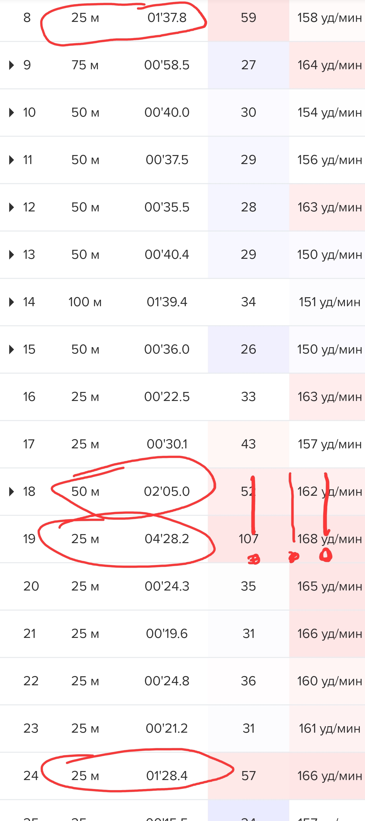

                            • Александр ДаниленкоА Online
                              Александр Даниленко @pavel.samokha
                              @pavel.samokha
                              @Dimitrios-Kanellopoulos
                              Again new update brings new bugs to the watch 😡
                              With this new update my Race S count swimming intervals really badly pretty often:
                              1. When I swim, then stop, for some reason they don’t stop counting the time of the distance, which leads to really weird time estimations of the intervals making them unrealistically long. For example here - no way I was swimming 25m 4.5 minutes:
                              2. Same problem, but under different angle. For example, if I swim 2×100m with 1 min rest between sometimes watch show me 200m interval with overall time (100m time + 1 min rest + 100m time). So the watch just don’t see the rest time, thinking I am still swimming during the rest.
                              Before the update there was never ever such a problem.
                              Suunto, do you have any test engineers??? I am using your watch already more than 2 years. From that time you didn’t bring anything new to swimming, just made new bugs additionally to the tones of bugs you previously had:
                              1. Removed red arrow, which shows you moment when you stop, on the clockwatch anymore, which makes clockwatch a useless screen in the swimming.
                              2. Broken structured workouts where you can’t see the name of the interval, but just its order, like 1/8, 2/8, 3/8…
                              3. No button manual lap timecounter in the swimming (if you don’t swim and press lap button it shows you 0 time always).
                              4. Broken drills mode - the person, who did that SuuntoPlus app doesn’t know how Suunto watch work in swimming and that they don’t count distance and time of the distance if you dont move you hands, like it supposed to be in many drills, which are included in your list of the drills.
                              5. If I connect polar verity sense for swimming to Race S, now it vibrates every time when polar is connected to the watch, i.e. every 2 strokes, when the watches are above the water. To deal with this I have to use “Dont disturb mode” every swimming session. (P.S. Built-in to watch HR sensor is useless in swimming, showing temperature on the Mars).
                              6. If you create custom swimming mode and set there on the screen to show “Rest time”, it will show overall rest time within whole training. This is completely useless information during the training. Instead we need rest time between intervals, like in the “Swim time” suunto app…which is also kind of useless, because it starts counting the rest time only after the watch will calculate the swimming time, i.e. 5-10s after the actual stop. Same thing about “Send Off” app.
                              And it is not everything - I wrote it without even looking to my notes…
                              Every time Im hoping that Suunto will fix something in swimming, but you do opposite withing all these 2 years, bringing new bugs, which makes it completely disappointing.
                              Ahhh, ok. The only thing which was improved - style detection. It was terrible before, now it is ok, but still far from being perfect.
