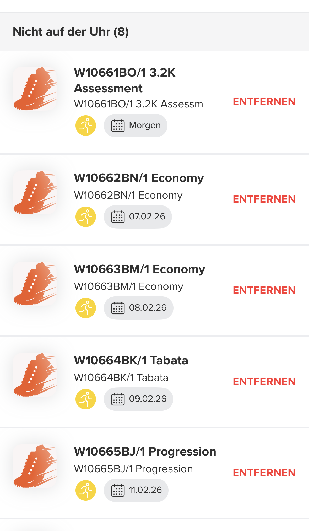

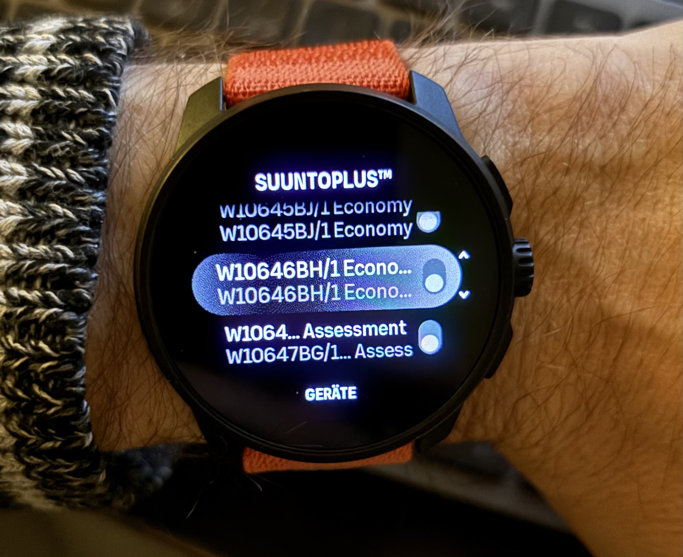

      I had this issue before, but in connection with “My Plan”. Now I only use TrainAsOne and it happened again. All Guides are in the “not on watch” section in the Suunto App. On the watch I have older Guides and even a Guide scheduled for today, that has been replaced by another Guide by TrainAsOne. The Replacement cannot be synced from the Suunto App.
      12s restart didn’t change anything. App restart didn’t change anything. A manually created interval session can neither be synced.

                    The Guides on the watch are all older (numbers are smaller):
                    I tried to reinstall the App, 12s reset the watch. Once it actually did work, with a couple of 12s resets and pulling within the app to resync.
