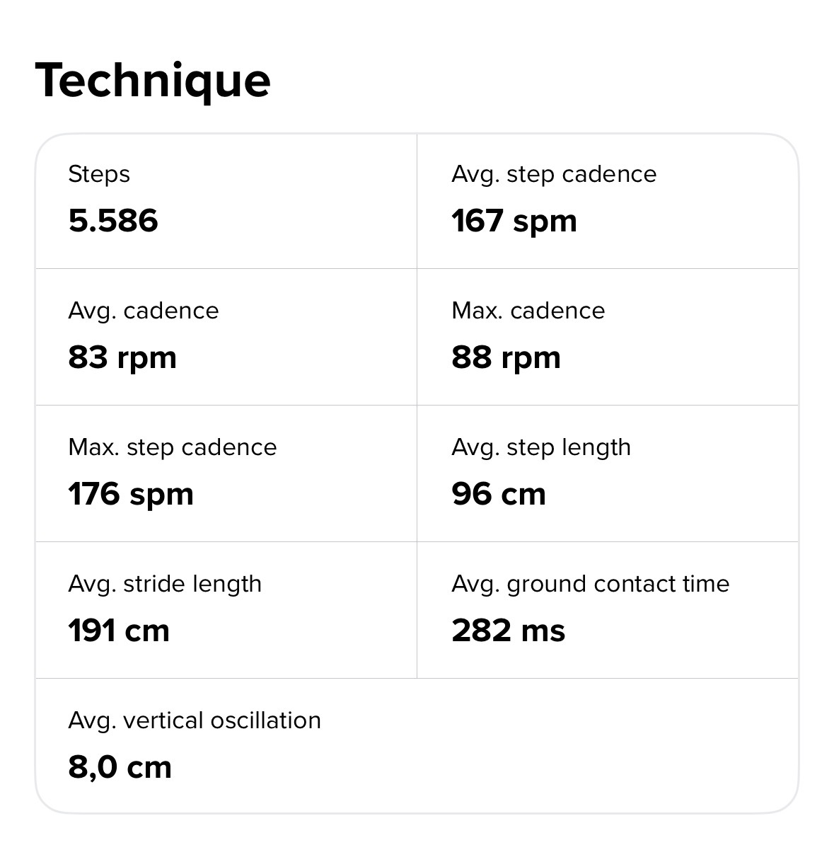

      I’m seeking your assistance with an issue I’m encountering regarding the running dynamics on my Suunto SV2. With updating my device to the Q3 software version, Suunto Update 2.48.16, I noticed that there will be the new running dynamics for ground contact time and vertical oscillation metrics and I would love to use them…
      But when I analyze my runs, I can’t find any information about these metrics in the workout analysis section. There are no charts or details provided in the „Technique“ part. I’ve tried adding the new metrics to my screens, but this doesn’t seem to resolve the issue (and that should’t be needed; I prefer to have fewer screens during my runs and analyze the data afterward).
      I’m at a loss as to what steps I can take to obtain these metrics. Could anyone please provide me with some guidance on how to fix this problem?

                  @Egika Tried it for about 90m. Doesn’t change anything. No metrics for the default profile…
                    bobbyfw03 @Egika
                    @Egika Thanks for your support. Since I’m relatively new to Suunto, I did my first hard reset and now it works. Im not that amused to setup my watch and all the custom sport profiles again but now I can use the metrics. Thanks again!

                                    bobbyfw03
                                    I’ve done further investigation and can confirm that the issue is because of footpod connection. I’ve done several tests with my sv2 und the race2 of my wife. What I’ve done:
                                    1.Hard reset
                                    2. run in basic mode and standard mode > vertical Oszillation and ground contact time are visible
                                    3. connect a footpod (in this case npe Runn)
                                    4. treadmill activity > no metrics recorded
                                    5. disconnect footpod (general disabling for outdoor and treadmill runs)
                                    6. start basic and customized outdoor/treadmill runs > no metrics are recorded
                                    7. soft reset / new app pairing
                                    8. issue persists
                                    9. started with 1. again without footpod > works fine. After that: same procedure from 2.-8.
                                    So for my testing it’s definitely about the footpod which seem to entirely block the metrics.
