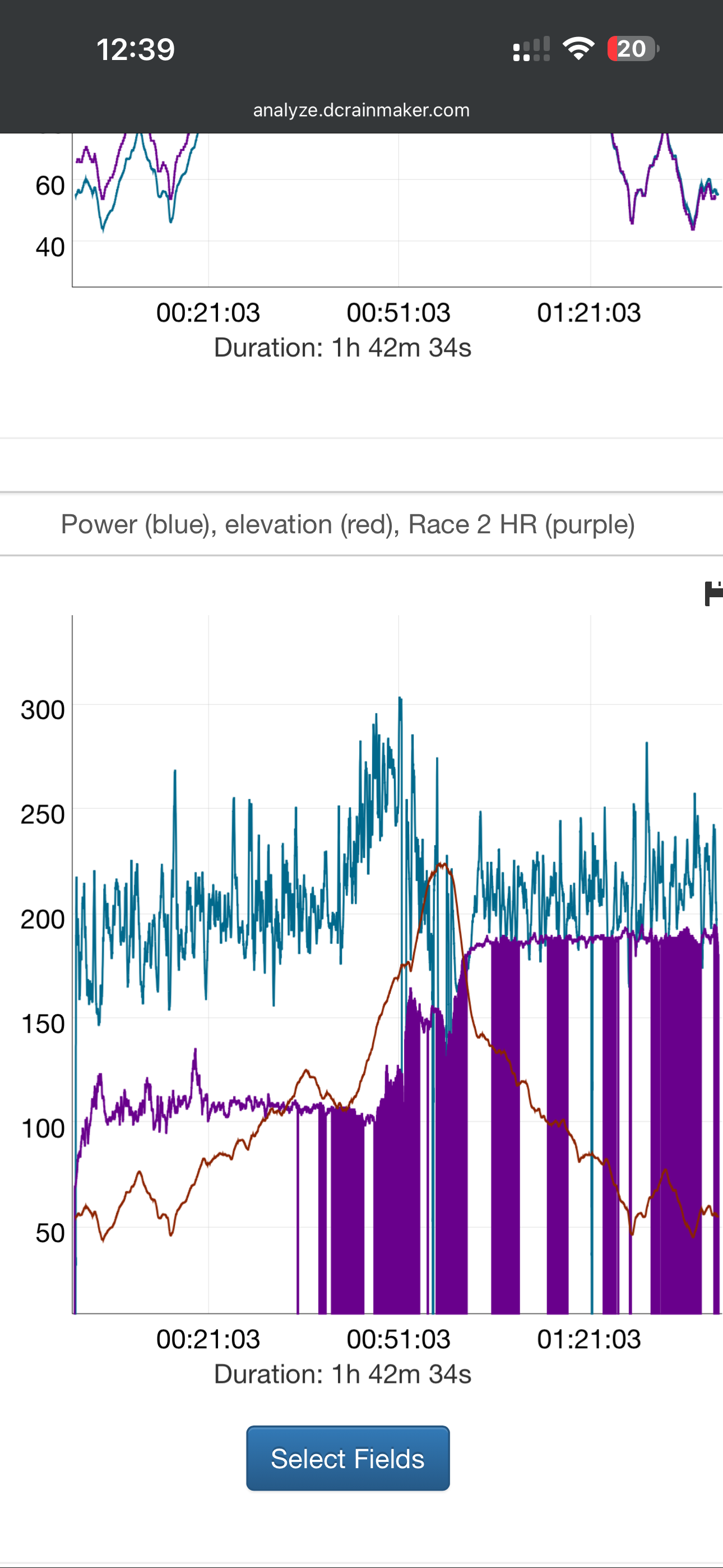

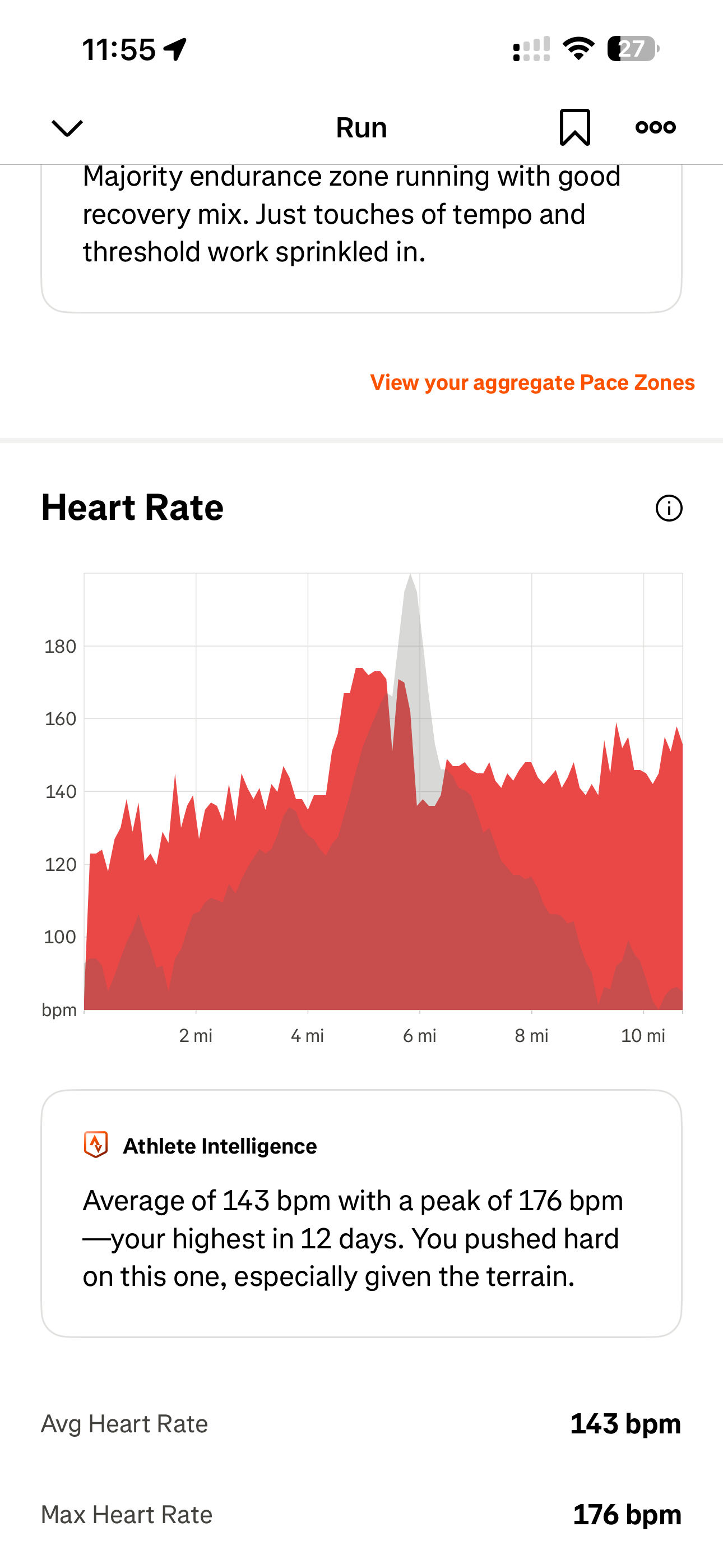

      My understanding was that Suunto had finally resolved their heart rate issues with the Race 2. My watch is updated to the most recent firmware but heart rate accuracy is possibly the worst I ever ever seen. Over a 1 hour 40 minute run, at most only 3 or 4 minutes was within 25 bpm of an external sensir.
      I did a 10 mile run, first 5 miles were climbing, then a 300 foot hill effort then the final 4 miles were downhill.
      Throughout the ascent, the Race 2 heart rate ‘stuck very low’, hiverng around 100-110 bpm. Actual HR was my usual easy / high range (measured with an external HRM on another watch. After the hill effort the Suunto Race 2 heart rate finally began to climb but got stuck very high, around 190-195bpm (my max as a runner nearer 60 than 50 is 181).
      Honestly heart rate monitoring via wrist seems totally broken -
      alt text

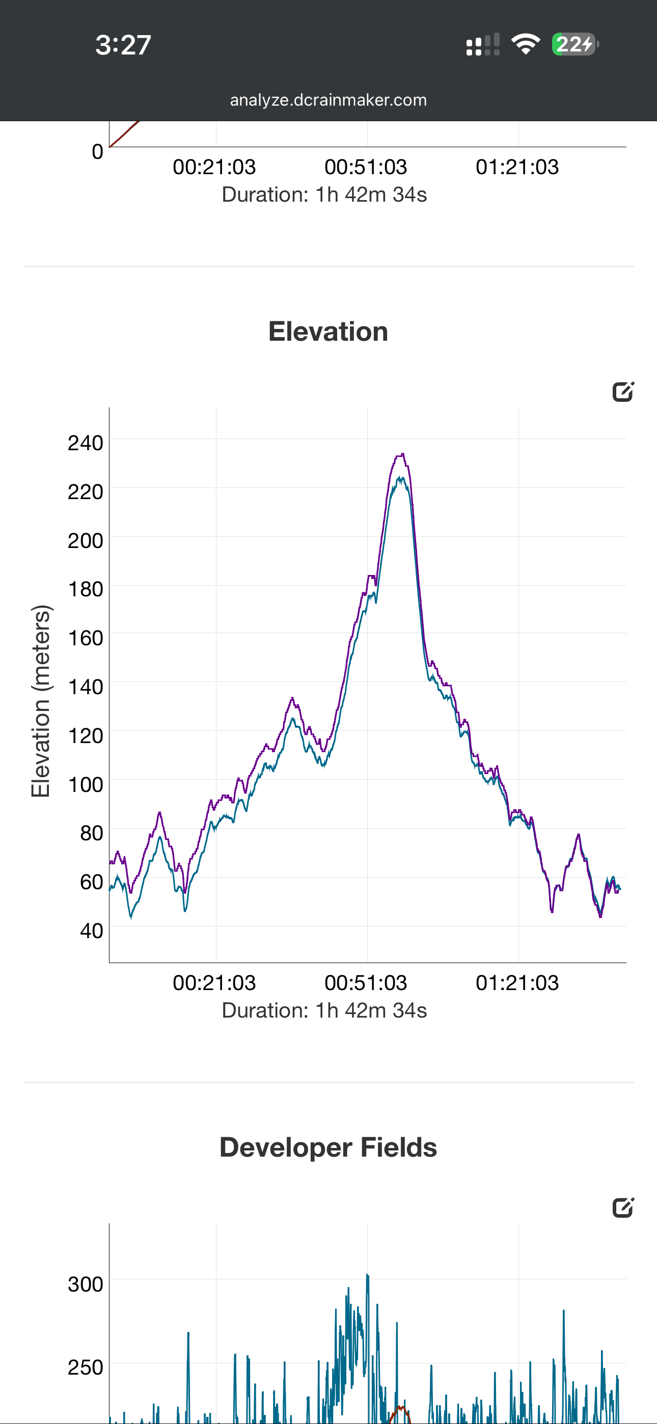

      This shows the elevation profile and actual HR from the watch
      alt text
      I have also uploaded a running power / elevation plot whicb shows very clearly Suunto heart rate is just not reflecting effort correctly.

        @cumbrian-runner It seems a little hard to say that" its awful" based on one singular run…
        Did you wear your watch on the usual wrist ? Did you tighten it correctly ? Which strap did you use ? Do you even know if another watch would have given you a better result ? Yes, what you have shown happens, but no, considering that pretty much everyone agrees that the HR sensor is “pretty OK now” that looks a lot like a “you” problem.
        And 0.2 miles less over 11 miles is 1.8% error relative to other untrusted sources (because no, other watch or a foot thing do not count as a reliable distance measurement), so I count that as “perfectly aligned”, did you check the gps track to see where the “undercounting” came from ?

            The data proves its completely wrong - it’s irrutablf given the other watch was connected to an external HR and its clearly not reflecting effort when HR is plotted against running power.
            Imagining other watches may or may not give different results seems unproductive to me, and is not useful go speculate.

              @larrybbaker thanks for showing interest. elevation seems fine.
              I didn’t comment on it as unlike heart rate or distance its hard to validate accuracy.
              Its only heart rate that is obviously hugely massively wrong and distabxe somewhat short.

                      @cumbrian-runner OHR is highly dependent on the individual. For me Race2 OHR works well with steady runs and poorly on intervals. I almost always use a belt because I want better HR data.
                      I often wear Race2 on one wrist and Vertical on the other. I get nearly identical distances and altitude gains/losses with both. I can share many instances of data if you wish.
