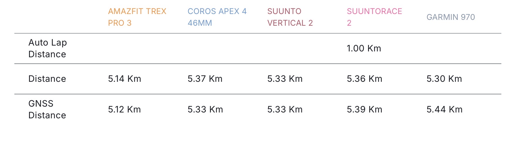

          • JoaquinJ Offline
            Joaquin Moderator
            @jjpaz @dreamer_ Interesting test

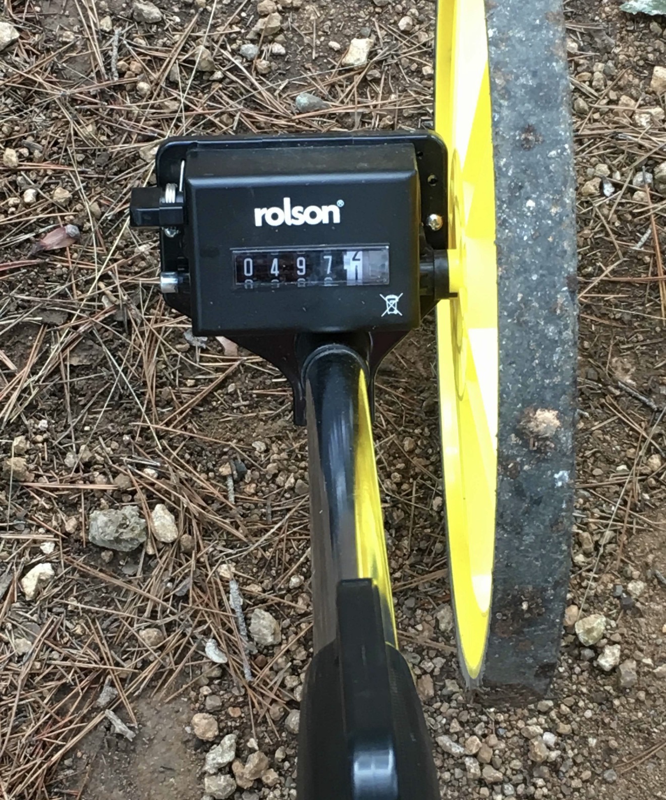

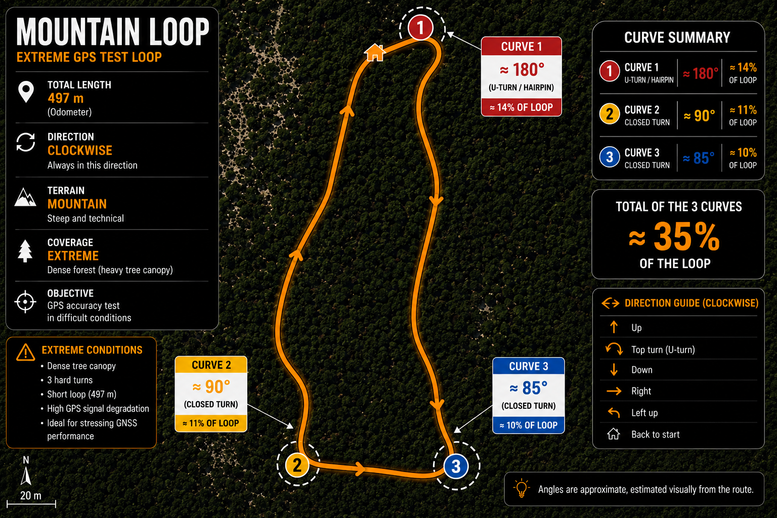

            This test was performed on a very short and technical mountain loop under dense tree canopy.
            Loop characteristics:
            • Wheel measured distance: 497 m
            • Total laps: 11
            • Expected real distance: 5.467 km
            • Clockwise direction
            • Dense forest coverage
            • Repeated technical turns including one ~180° hairpin and two additional closed turns
            The loop contains:
            • Curve 1 → ~180° hairpin
            • Curve 2 → ~90° closed turn
            • Curve 3 → ~85° closed turn
            These repeated direction changes make this route extremely demanding for GNSS filtering and track reconstruction.
            One important detail:
            all watches were worn in different wrist positions, so small variations are completely normal. Watches placed slightly higher on the arm usually record slightly more distance due to arm swing and antenna orientation.

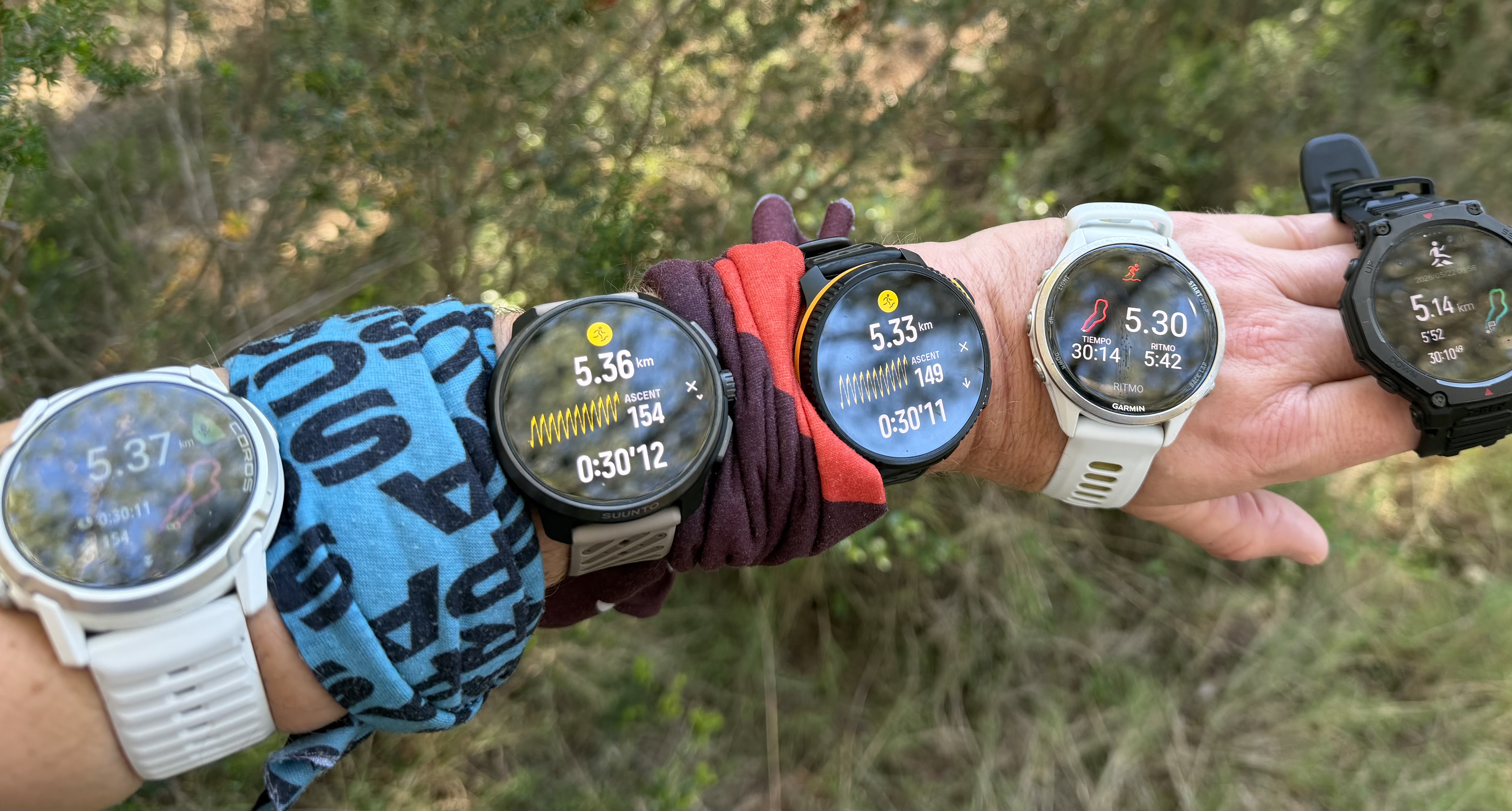

            Results:
            • COROS Apex 4 → 5.37 km (-1.8%)
            • Suunto Race 2 → 5.36 km (-2.0%)
            • Suunto Vertical 2 → 5.33 km (-2.5%)
            • Garmin 970 → 5.30 km (-3.1%)
            • Amazfit T-Rex Pro 3 → 5.14 km (-6.0%)
            A very interesting detail appeared when comparing GNSS raw distance vs filtered activity distance.
            This is where you can clearly see the work of each brand’s algorithms trying to reconstruct the “real” trajectory under dense canopy conditions.
            GNSS Distance represents the raw satellite accumulation, while Distance is the final filtered value after each brand applies its own correction, smoothing and trajectory reconstruction algorithms.
            The most impressive result here was the Suunto Vertical 2:
            • 5.33 km GNSS Distance
            • 5.33 km final Distance
            An almost perfect match between raw GNSS data and filtered output, showing extremely confident trajectory processing in this test.
            COROS and Suunto Race 2 also stayed very close between raw and filtered values, while Garmin showed a more aggressive correction approach:
            • 5.44 km raw GNSS
            • corrected down to 5.30 km final distance
            With the exception of the Amazfit, the distance difference between the other four devices is completely normal considering the different wrist positions and the extremely difficult GNSS conditions during the test.
            ENJOY!!!
            Technical & Product Specialist – Suunto Iberia
            I jjpazJ C 3 Replies Last reply Reply Quote 10
            • I Offline
              isaac.net @Joaquin
              @Joaquin Thank you very much for your testing efforts. Is the software version used the same one available to users?
              On the other hand, it’s good that the watch performs well when making corrections under extreme conditions, but it would be important to focus on what’s being discussed in this thread, where the correction causes errors under ideal conditions, which I believe is the most common scenario for a Race 2 user, and where the result should be perfect after the corrections.
              JoaquinJ 1 Reply Last reply Reply Quote 0
              • JoaquinJ Offline
                Joaquin Moderator @isaac.net
                @isaac.net not, working on it 😉 of course, we must do more and more Tets but looks promising
                I 1 Reply Last reply Reply Quote 3

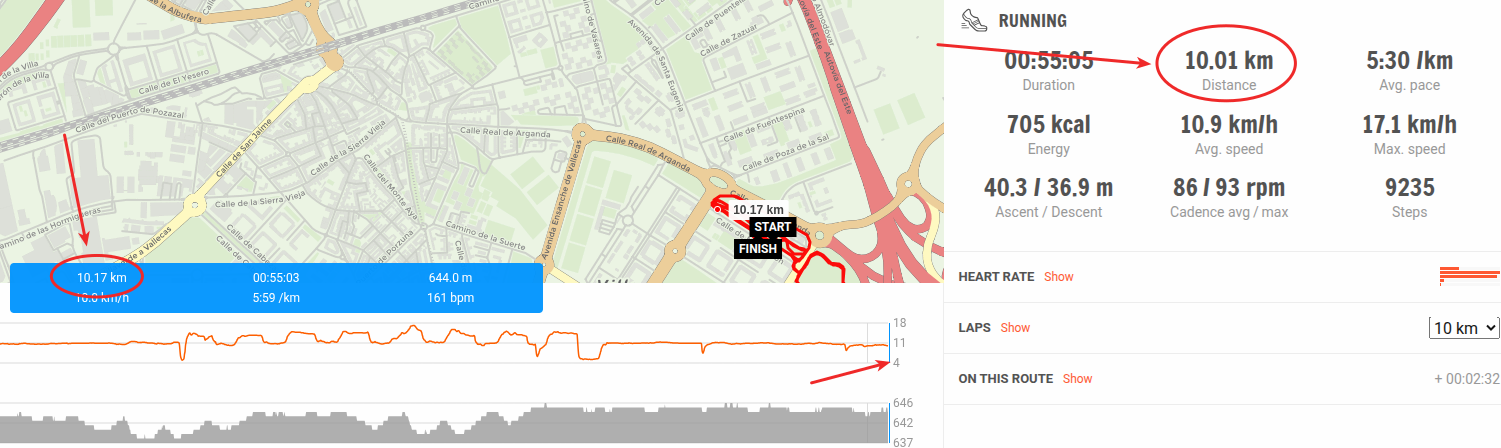

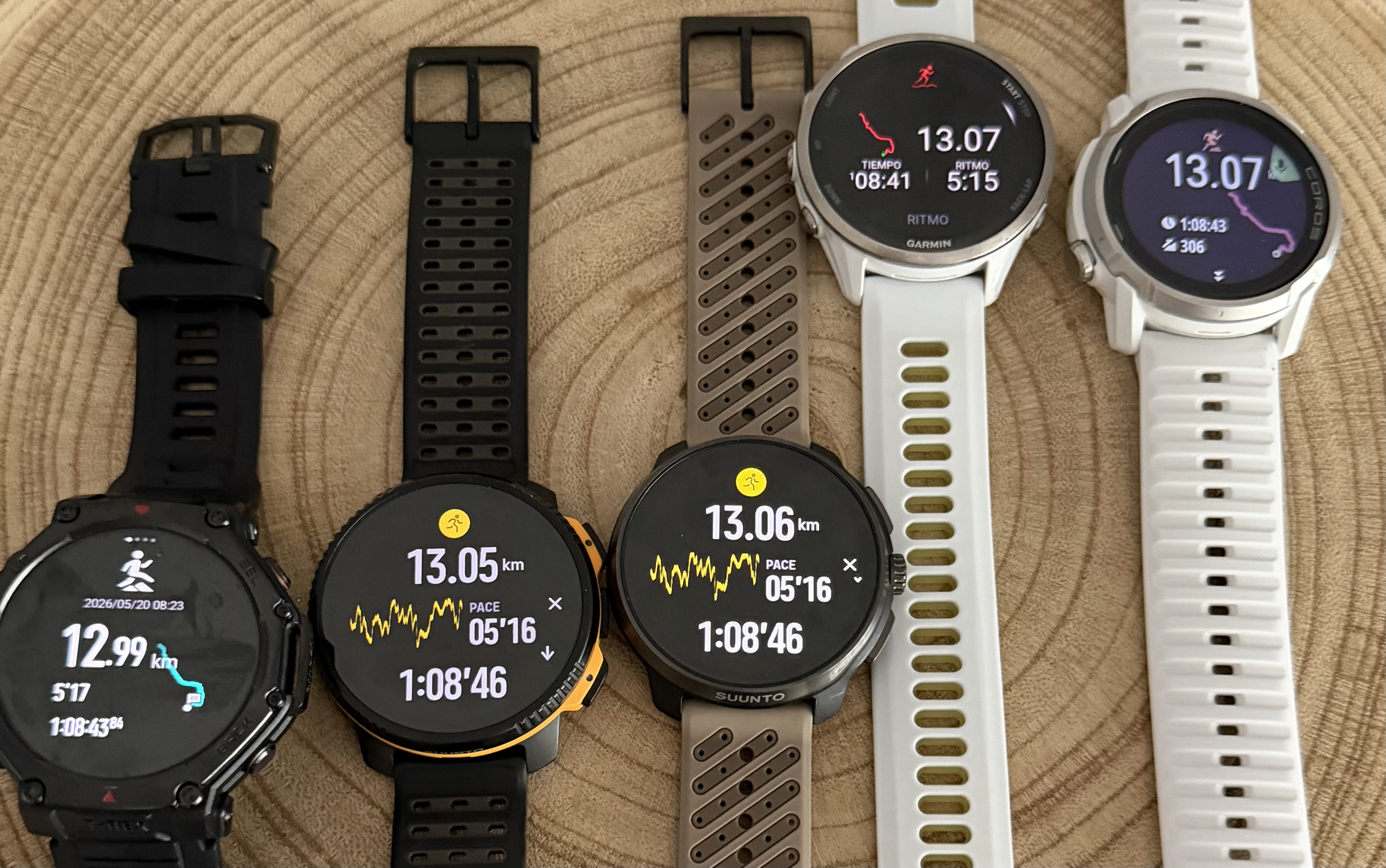

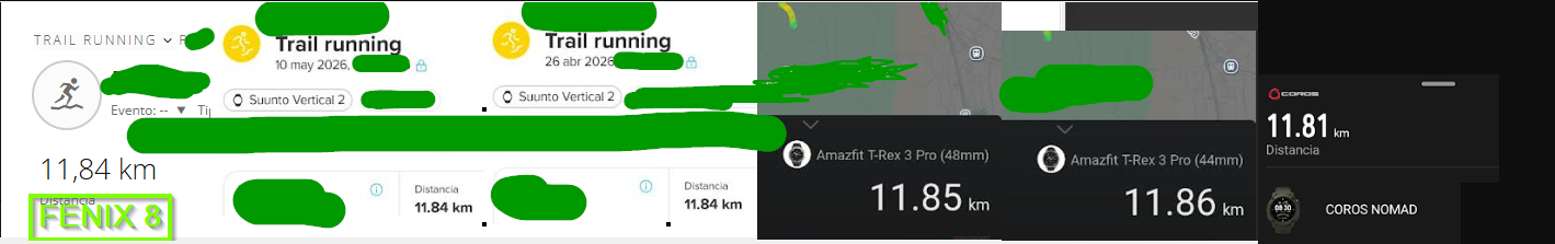

                      I can’t confirm the Race 2 now but I’m posting this because I can confirm the Vertical 2 in the track I was talking here:
                      https://forum.suunto.com/topic/15071/several-navigation-issues-feedback/39
                      alt text
                      All watches in exactly the very same wrist position, but different days. It’s pretty interesting to see how I’m having so similar distances considering I’m running in different days. But in the other hand, it’s a track I know really well. There’s road but trail with several tree zones with dense forest.
                      Suunto Vertical 2 Titanium Sage, Suunto Run
                      JoaquinJ 1 Reply Last reply Reply Quote 3

                          • C Offline
                            chus1962 @Joaquin
                            @Joaquin Wow, great work!

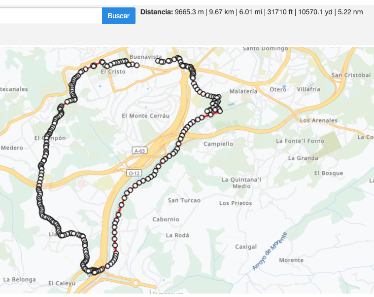

                            Just out of curiosity, how did you get the GNSS distance?
                            Any program that processes a GPX file will do some kind of filtering to calculate the distance, and it will give a lower value than if I simply take the GPX points, calculate the distance between them, and add them up (which is what I understand to be the actual raw distance).

                              • JoaquinJ Offline
                                Joaquin Moderator @chus1962
                                @chus1962 internal tools but is not the important here 😉 Users will only see the total distance processed, so it is only useful for internal engineering and software analysis.

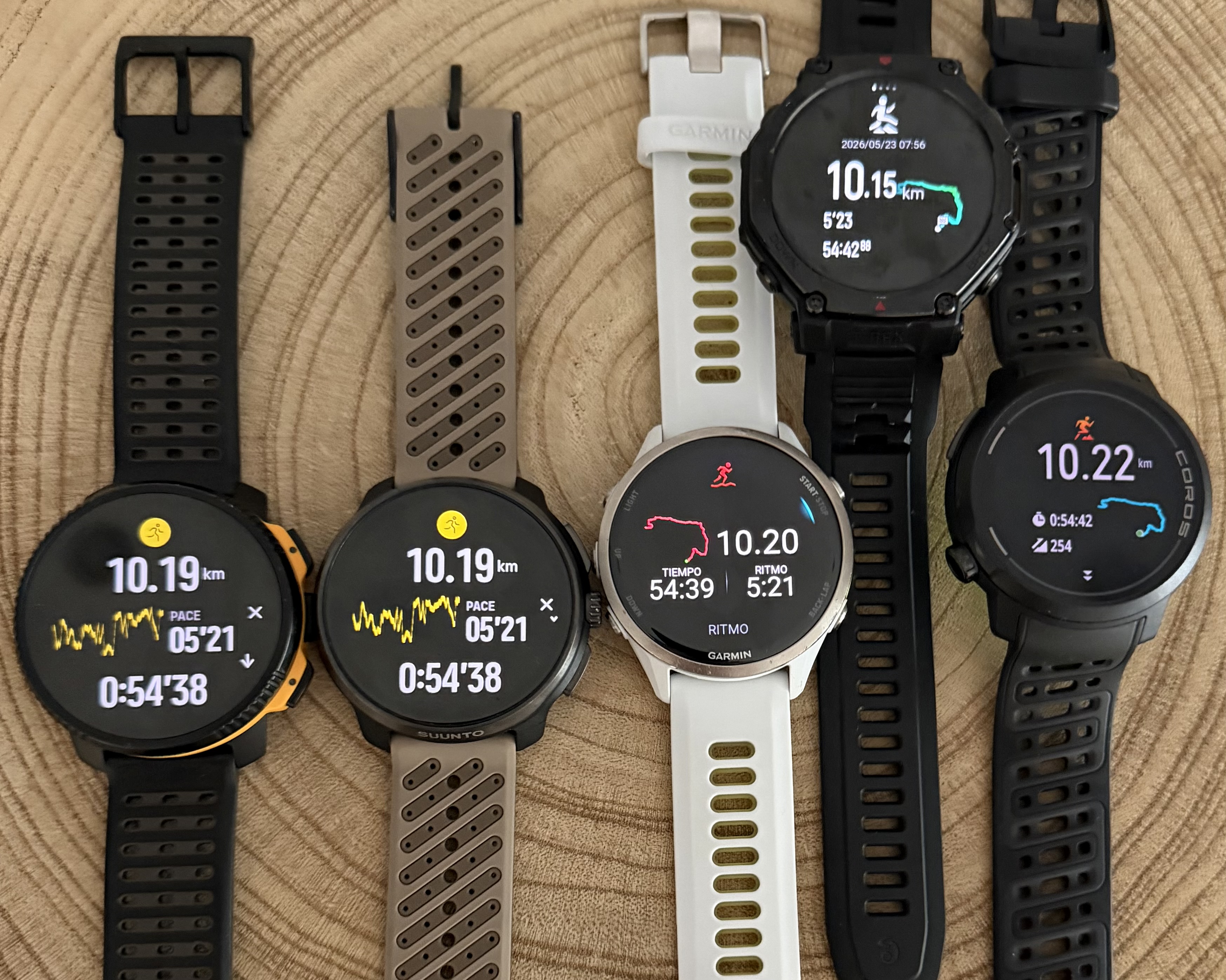

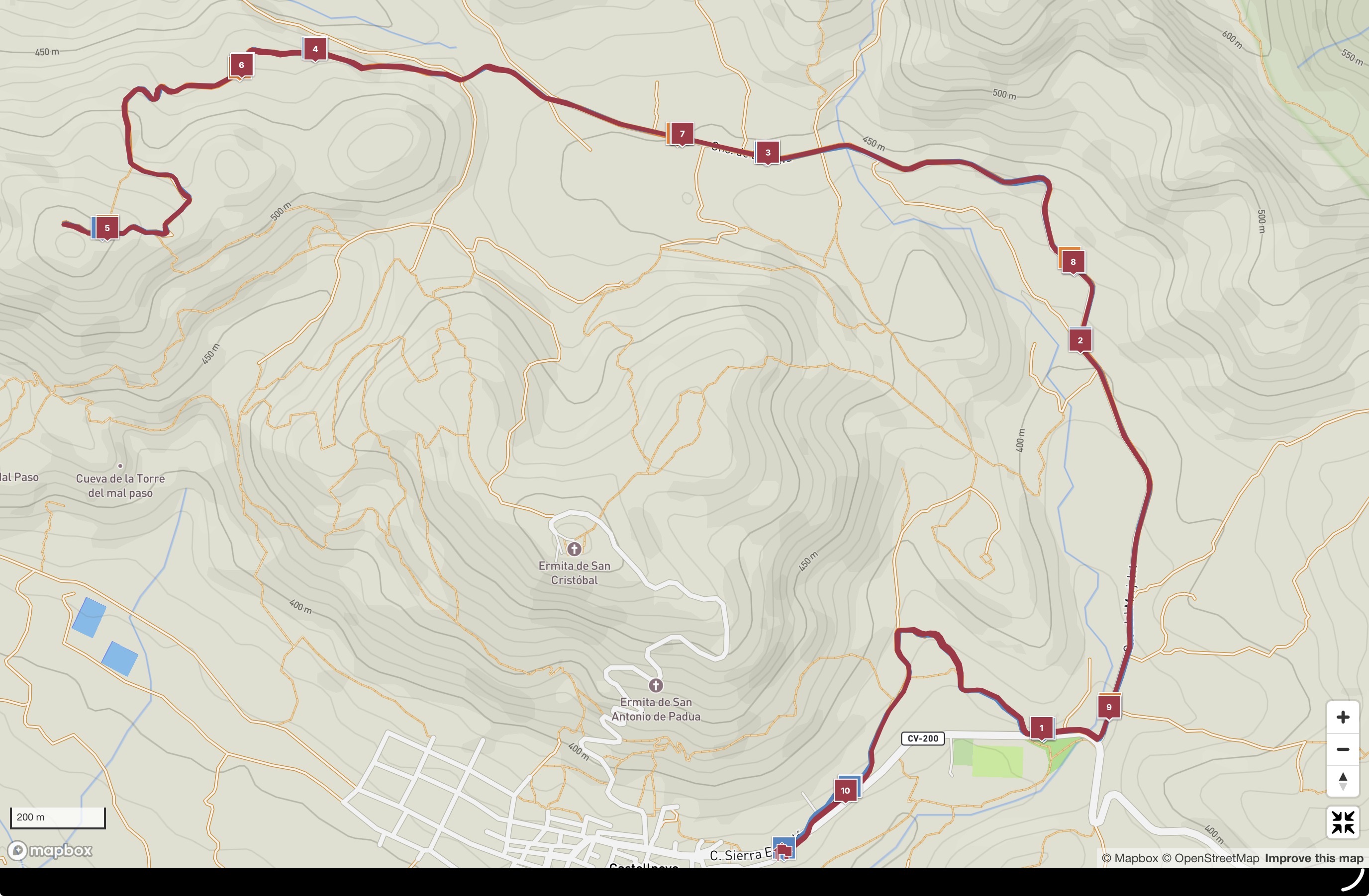

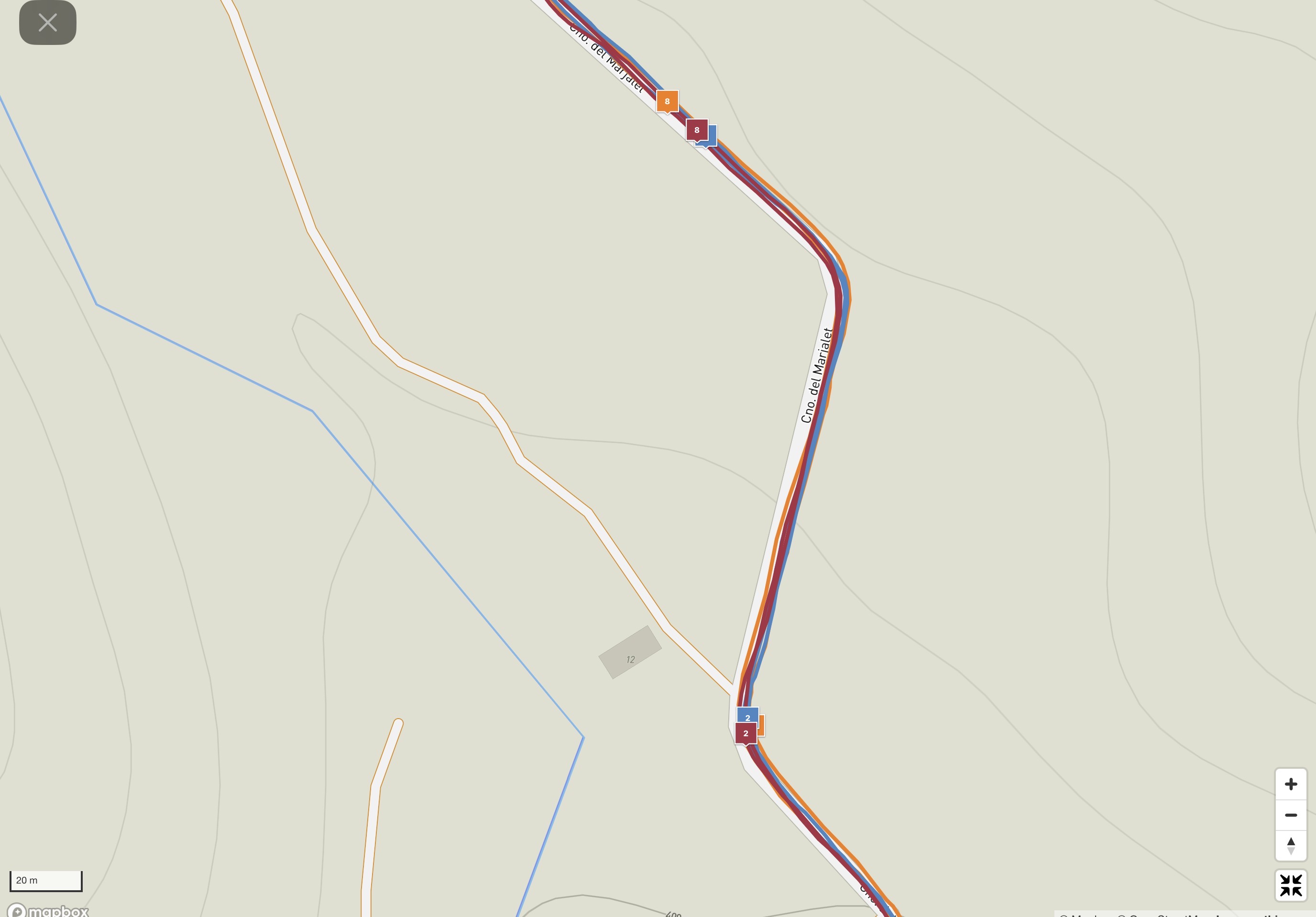

                                    • JoaquinJ Offline
                                      Joaquin Moderator

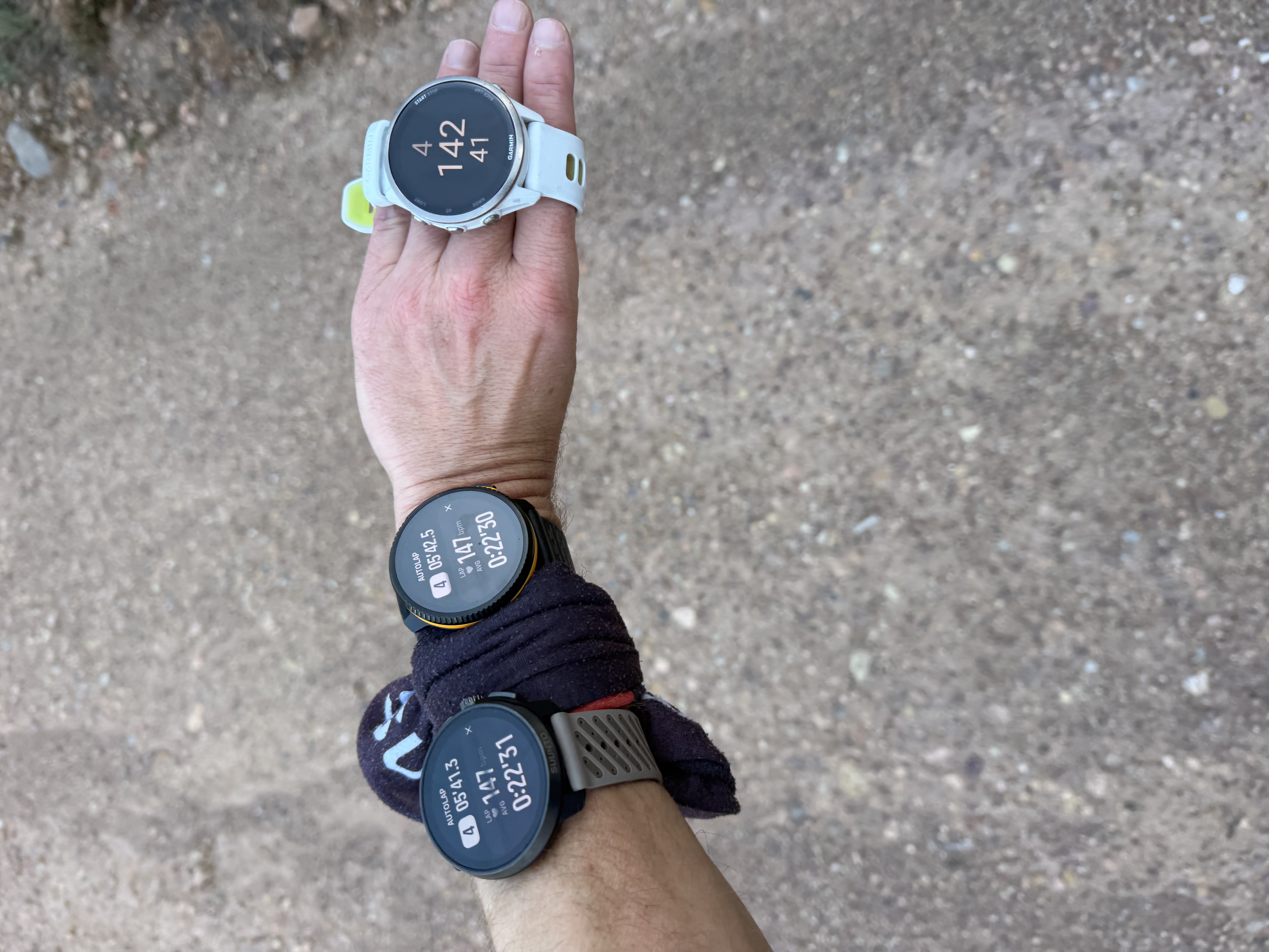

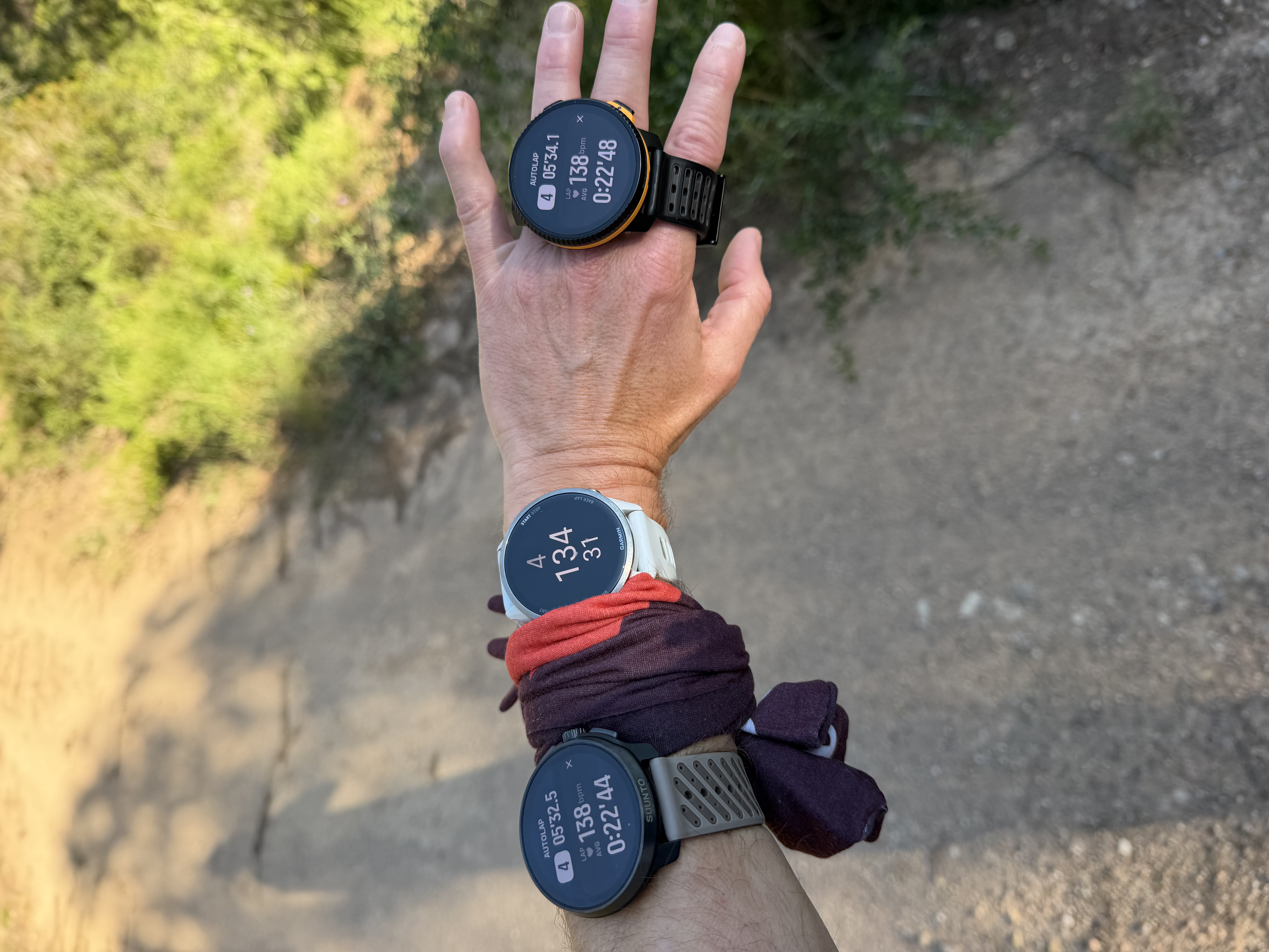

                                      @dreamer_ I did an easy out-and-back route to the hill near my house and also changed the watch placement compared to yesterday’s loop. Here you can clearly see what we discussed yesterday: when you are not constantly repeating a technically difficult section like my loop, the differences become almost negligible — BUT THEY ARE STILL THERE.
                                      I used the Pace Pro and the T-Rex 3 Pro on my right hand. Since it was an out-and-back route, theoretically the distance should be identical.
                                      You can also clearly see how the kilometer markers overlap almost perfectly on the V2, R2, and 970, which is honestly a very good sign regarding GPS consistency and distance measurement. The overlap between those devices is excellent.
                                      The out-and-back format is actually very useful for this kind of testing because it removes many variables and makes small GPS deviations much easier to spot. In normal conditions most users would probably never notice these differences, but for people who regularly test devices or spend a lot of time in complex terrain, they are still visible.
                                      This is exactly why continuing to improve GPS filtering, track smoothing, and altitude handling remains so important, especially for mountain users and people training in difficult environments.
                                      P.S. I know you enjoy testing devices, so try the T-Rex 3 Pro with the latest software version and you’ll understand why it is so important for us to keep working on good GPS and altimeter performance 😉
                                      dreamer_D I 2 Replies Last reply Reply Quote 4
                                      • dreamer_D Offline
                                        dreamer_ @Joaquin

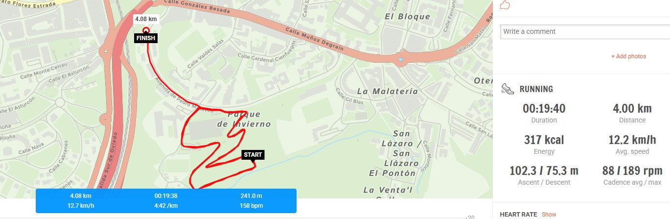

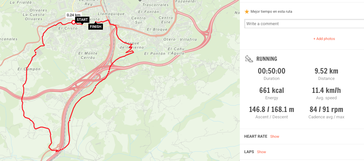

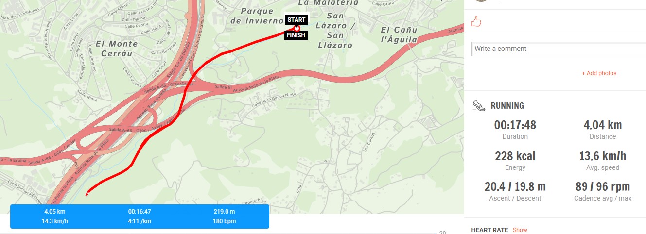

                                        @Joaquin I completely agree with your posts. In fact, today I tested my wife’s Run and even in my track, I’m finding the Run more similar to the Vertical 2 than the T-Rex 3 Pro. Not only the GPS but specially things like the altimeter, where even a watch like the Run is clearly better than that watch.
                                        I did not notice that since you posted your loop tracks, the differences were just too small to even have a look at them
                                        It is a fantastic finding and super nice work. And one thing, these posts makes you think how nice are the quality testings you are doing.
                                        JoaquinJ 1 Reply Last reply Reply Quote 1
