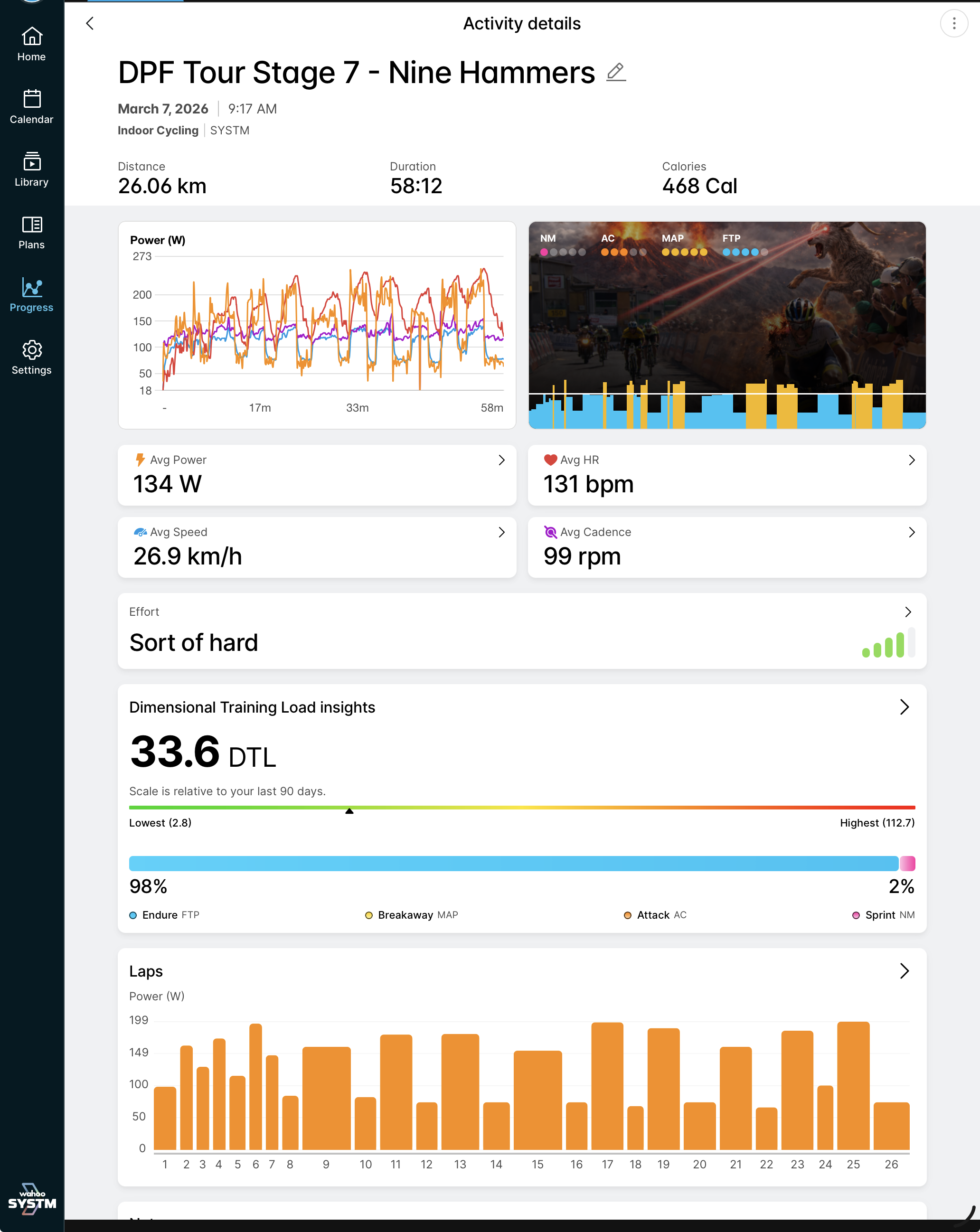

          As a counter point, when you’re running on a treadmill you’re not moving either, but still have a pace and distance based on your cadence and stride length. Elevation nuances also apply here, even though you can set an incline on the treadmill.
          And yeah, the power and cadence (sometimes HR) is honestly the only thing I really care about. I was just curious why that metric was missing. I assumed it has something to do about tire dimensions and gear ratios, but remain confused when doing a virtual ride in Zwift and speed is present in the data.

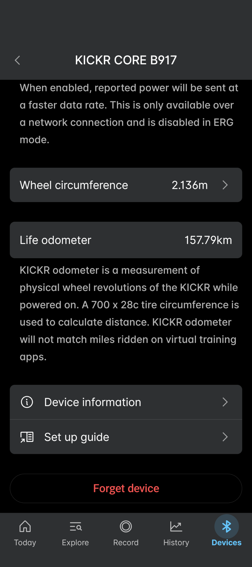

                @raven According to the app, the trainer does have an odometer based on tire circumference.
                KICKR odometer is a measurement of physical wheel revolutions of the KICKR while powered on. A 700 x 28c tire circumference is used to calculate the distance. KICKR odometer will not match miles ridden on virtual training apps.
