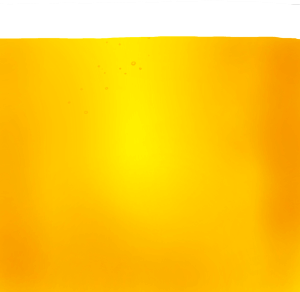

      If you desire to use very detailed graphics, such as fine gradients, here’s the next tip for you: consider dithering. Here’s an example of a problematic image:
      A yellow/orange gradient

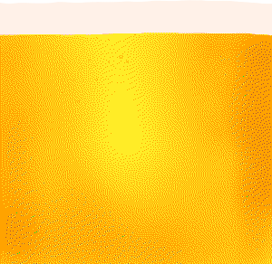

      Deploying this image to your watch may introduce colour banding, which ruins the smoothness of the gradient. Here’s a version with reduced colours and dithering applied to it:
      The same gradient but dithered
      On a Suunto Race 1, for example, the difference is night and day – the latter image’s colours flow smoothly with no hard lines.
      We do not endorse any particular tool, but the above image was improved using TURBO DITHER. You can play around with different algorithms, factors, scales and palettes to find the best solution for your situation. A custom palette derived from the original image is usually optimal.
      Finally, remember that large images may be quite heavy for some watch models. The final size in bytes is dependent only on (1) which image type you choose in the manifest and (2) the resolution of the image.
