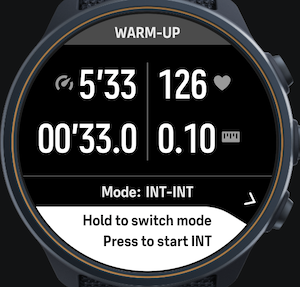

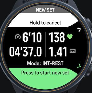

      Hi everyone,
      I’d like to share an update of my SuuntoPlus app Manual Interval+, built for runners who train using the Lap button and want a clear, consistent interval screen for any kind of workout.
      I originally designed the app because many of my own interval sessions don’t follow a strict “work / rest” pattern — for example short accelerations inside longer blocks, variable‑pace intervals, fartleks, or pyramid workouts. With many existing manual‑interval solutions, the screen automatically switches to a “rest” view as soon as you press Lap, which can hide useful metrics even when you’re still running.
      I also wanted a simple way to review the previous interval’s data without losing context.

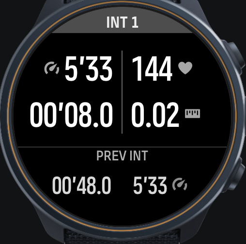

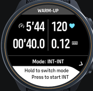

      INT‑INT mode – free manual intervals
      Designed for unstructured or mixed sessions.
      • Every Lap starts a new interval
      • No predefined effort or rest phase — you stay in control
      • The app never assumes a rest phase
      • A Previous Interval (PREV INT) panel is always available
      Well suited for fartleks, variable‑pace intervals, and free‑form sessions.

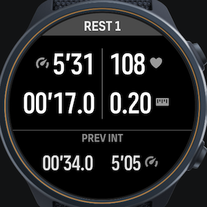

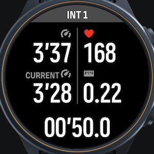

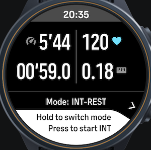

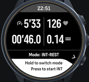

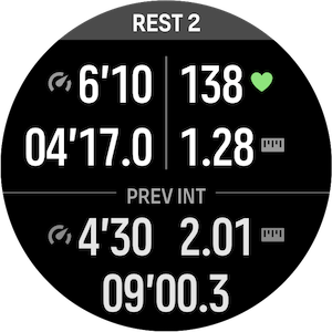

      INT‑REST mode – structured intervals with recovery
      Designed for classic interval sessions with clear effort/recovery phases.
      • Each Lap toggles between INT (effort) and REST (recovery)
      • Clear sequence: INT 1, REST 1, INT 2…
      • During INT, all key metrics are visible for pacing
      • During REST, PREV INT is emphasized to review your last effort
      Well suited for track repeats and structured workouts.

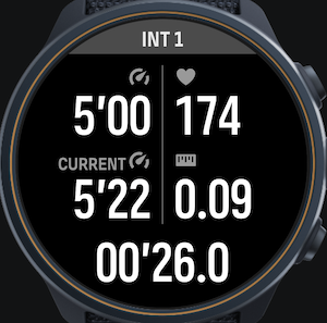

      NEW: INT‑FOCUS mode – stay focused, review after
      Designed to keep your screen clean during the effort.
      • During the interval, you see only the current‑lap metrics — no distractions

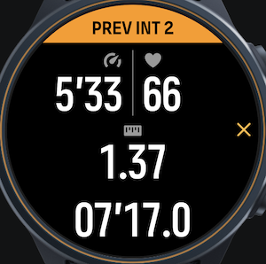

      • When you press Lap, a brief pop‑up (8s) shows the full summary of the previous interval:
        • Time
        • Distance
        • Average pace
        • Heart rate
      • Then the screen automatically returns to the live view for the next interval
      • You can also tap the screen to display previous lap data on demand (if touch screen enabled)
      Ideal when you want to stay fully focused during the effort while still getting quick feedback after each lap.
      Main features
      • Manual Lap‑based control, no predefined workouts
      • Tenth‑second lap timing (useful for track work)
      • Interval/rest numbering with duration, pace, HR, distance
      • Previous Interval always accessible, without breaking your flow
      • Improved PREV INT readability (larger font, clearer layout)
      • Optional touch interaction to switch PREV INT data
      • Ability to restart an interval set anytime (long press upper button)
      • Heart icon reflects ZoneSense intensity (if available) or HR zones otherwise
      • No pre-configuration required
      Compatibility
      Tested on the simulator across all Suunto watches, and in real conditions on my Suunto Race S.
      Feedback from other devices is very welcome!
      Thanks a lot for all the feedback I’ve received so far — it directly helped improve the app (PREV INT readability, reset feature, and now INT‑FOCUS).
      I hope Manual Interval+ proves useful to some of you.
      Happy to hear your thoughts or ideas after trying it!
      Thibault

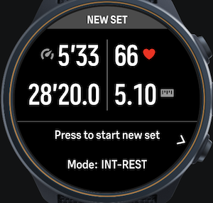

            I have one suggestion: the ability to reset the interval counter.
            In my case, I’d like to do a specific workout with manual intervals based on two sets of 5/3/1 reps. Without being able to reset the counter, it becomes quite difficult to keep track of which rep I’m on, especially when fatigued.
            Maybe a long press on the top button could be used to reset the counter?
            This way, I can choose to reset the counter either after each sub-block or after each set, making it easier to keep track.

                      v1.4 is out and introduces the reset of interval counter suggested by @anthony-guillemette,
                      Let me know what you think!
                      Anthony GuillemetteA 1 Reply Last reply Reply Quote 1

                            @Thibault-B. Thank you so much for this quick update. But, unfortunately, when I long press the top button it activates the multisport mode. So, it doesn’t work
                            Thibault B.T 1 Reply Last reply Reply Quote 0
                            • Thibault B.T Offline
                              Thibault B. Bronze Member @Anthony Guillemette
                              @Anthony-Guillemette works correctly on Suunto Race S.
                              Note that you need to start an INT first (does not work in warm-up - since there is nothing to reset -). What watch model do you own? Do you run latest version of the app?
                              Anthony GuillemetteA 1 Reply Last reply Reply Quote 0
                              • Anthony GuillemetteA Offline
                                Anthony Guillemette Bronze Member @Thibault B.
                                @Thibault-B. I didn’t say nothing… I tried again this morning and it works fine. The app update may not have synced to the watch yesterday. Can’t wait to test it during my next training 🙂

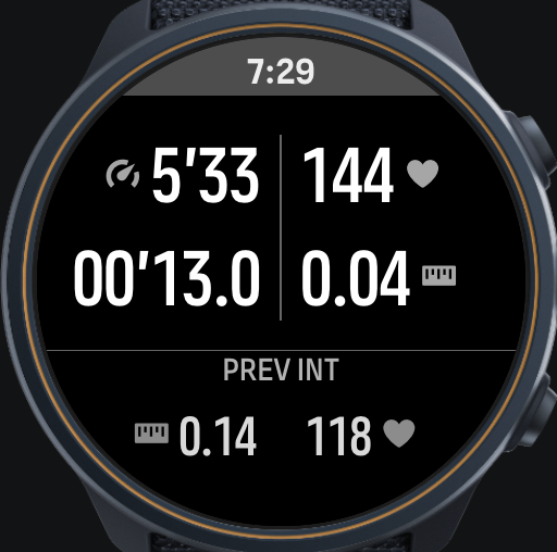

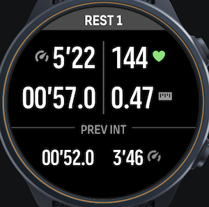

                                  I finally reached a solution I’m happy with for the PREV INT panel: bigger text, three values shown at the same time, and rotation between distance and average HR. Check out version 1.5!
                                  I’d love to get feedback on how this feels, especially on older watches like the Vertical 1, 9 Peak Pro, or older, and using light theme.

                                    @Thibault-B. Amazing - thanks a lot for the improvements of the readability! At the moment I can’t think of anything else to improve. But probably you or other users will come up with something 🙂
                                      Bouli
                                      @thibault-b. Good job !!! I test the last version today. It seems perfect all information I need size … thanks !
