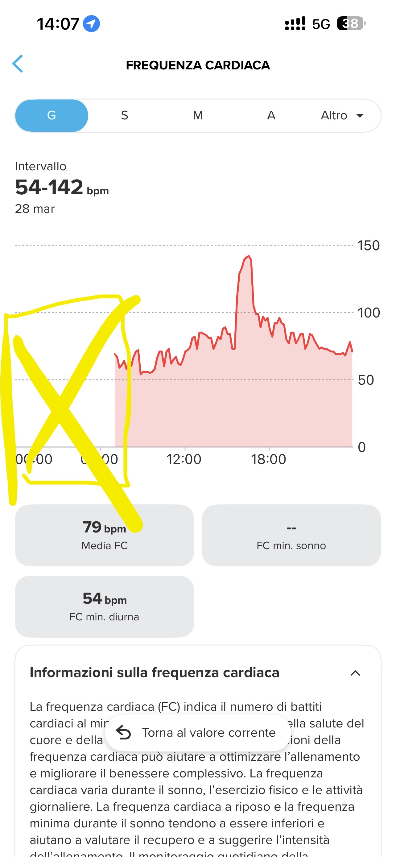

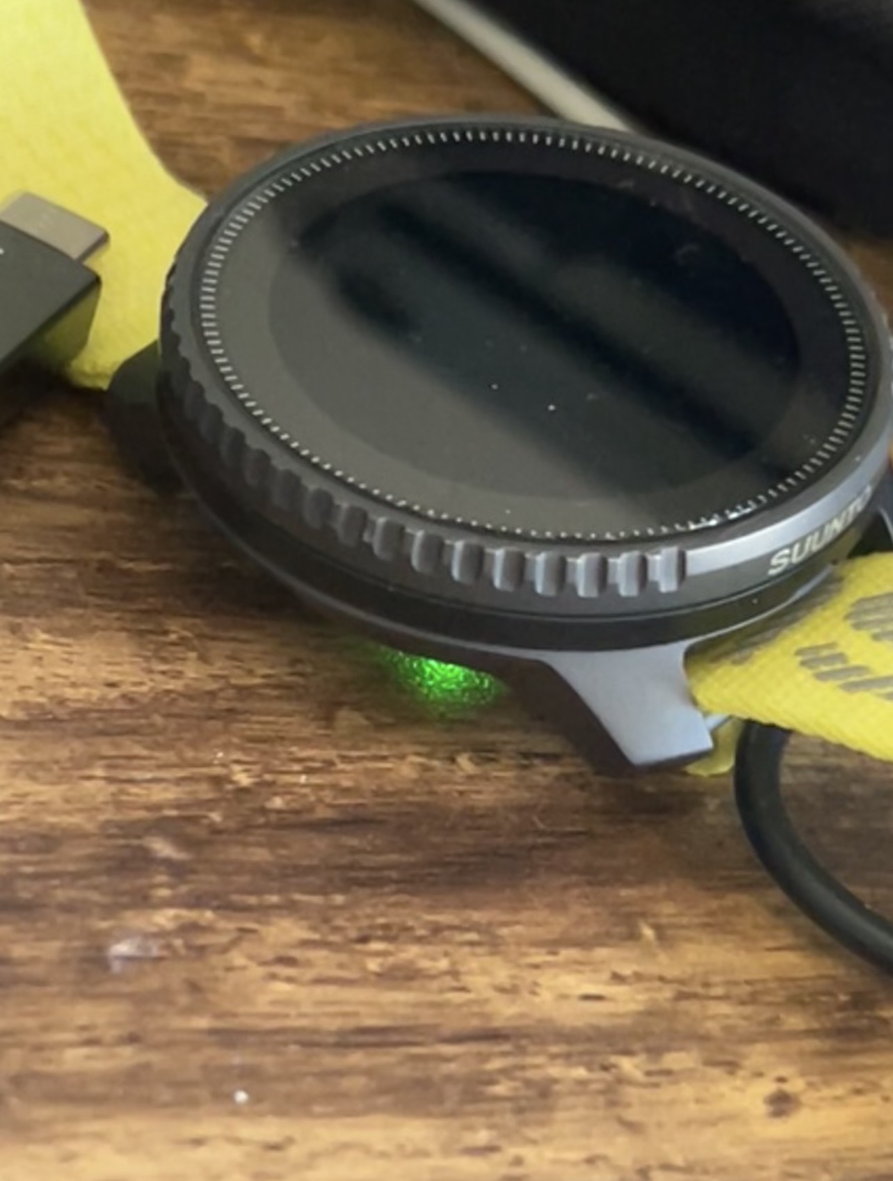

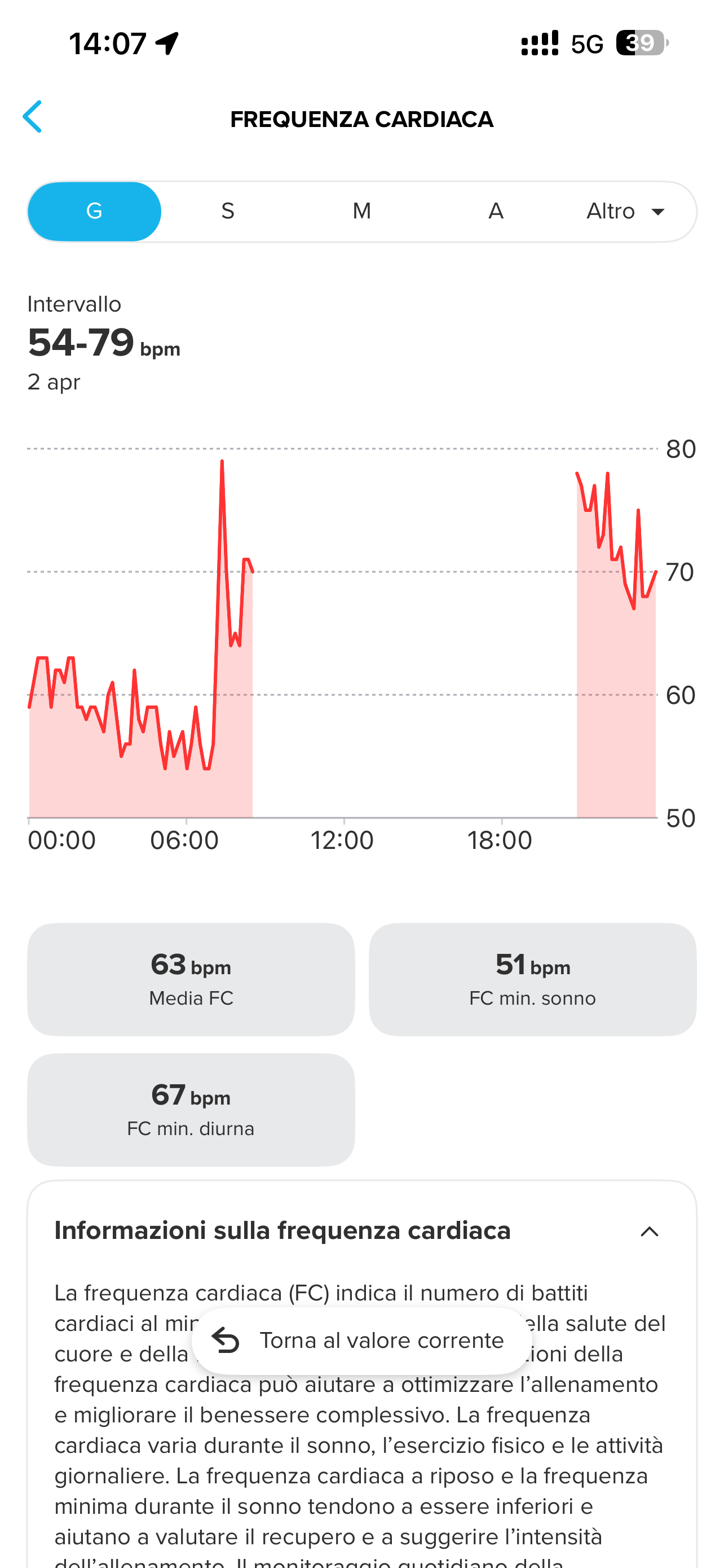

          @BrunoH sensor crash:

            I have been studying, testing, and comparing optical sensors for 10 years. I know very well how they work and I understand the difference between a malfunction and a reading error.
            I did not report a reading error. I did not report suboptimal conditions. I did not report inaccurate heart rate readings.
            This report is about a crash/shutdown at rest without any clear reason. The sensor suddenly turns off without warning, even though the conditions in which it was previously working have not changed.

                  @Egika It may well be a contact-based detection system, but it behaves oddly.
                  It works for hours, then suddenly turns off and stays off until I physically remove the watch from my wrist.
                  My guess is that, while trying to correct a reading error, the sensor logic may crash and fail to recover. Possibly some kind of overflow or state-handling bug. It does not seem to reactivate until the watch changes state from on-wrist to off-wrist and back again.
