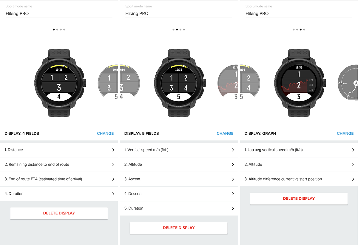

              I find very useful to have the vertical speed, I started using that parameter with my old Suunto Vector, it helps me to keep the right pace on long climbs. Once you learn what’s your good reference value (for example 8 / 9 m/min, that is 480 / 540 m/h) you can manage your effort along the route depending on its length and elevation gain. With the last update you can also select that parameter as one of the 5 data field that can be shown directly on the map tooth.
              Here is my hiking customization (completed with S+ Climb):
              cpinkyC 1 Reply Last reply Reply Quote 3

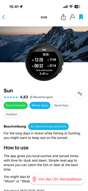

                  Thanks! What is the Sun S+ feature? Do you using sunset time to determine how much time left you have to hike or whats the purpose? I feel like I generally know the sunset time enough / don’t think about it. Not arguing, just trying to understand if I’m missing something lol
                  EgikaE M 2 Replies Last reply Reply Quote 0

                      @cpinky S+ you can check out in the app.

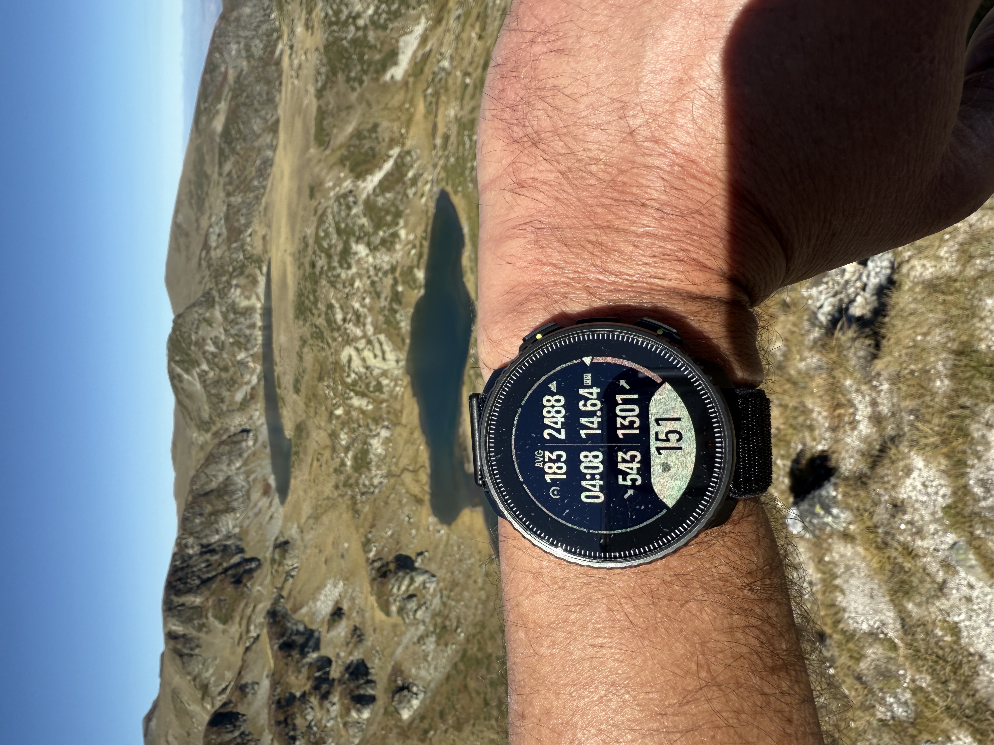

                            That’s my first custom screen, I have two more.
                            In the first field I have vertical speed m/h, not the average one. And in the 7-th field I always have the HR. Previous day during fw update my V1 factory reset and I had to set it up quickly for the next day custom hiking mode (I never use stock sport modes), so field 1 on first screen and field 7 on second custom screen are set wrongly.
                            S9PP / SV1 / SV2

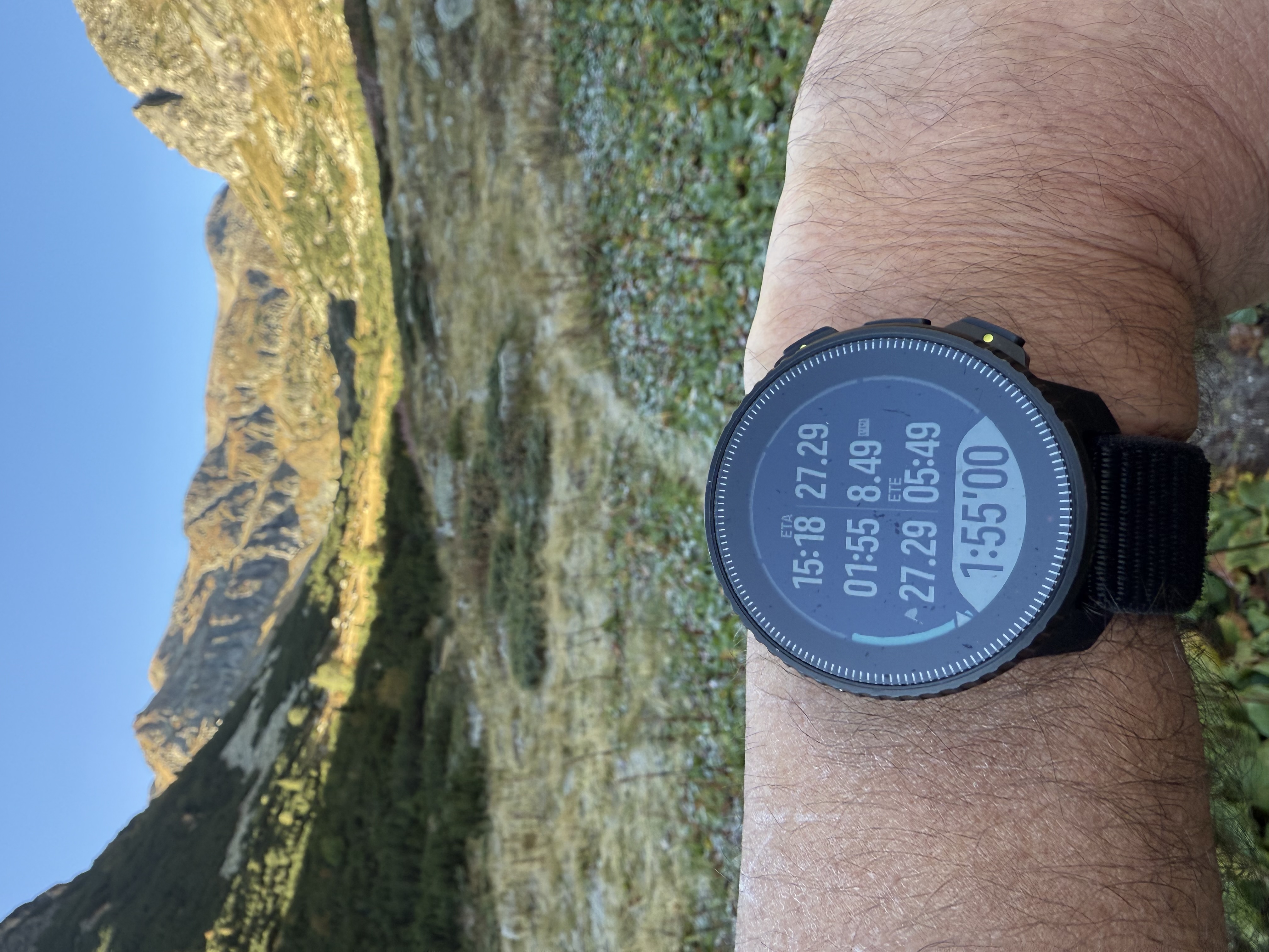

                            • HighlandsH Offline
                              Highlands
                              Second one
                              S9PP / SV1 / SV2
                              cpinkyC 1 Reply Last reply Reply Quote 1
