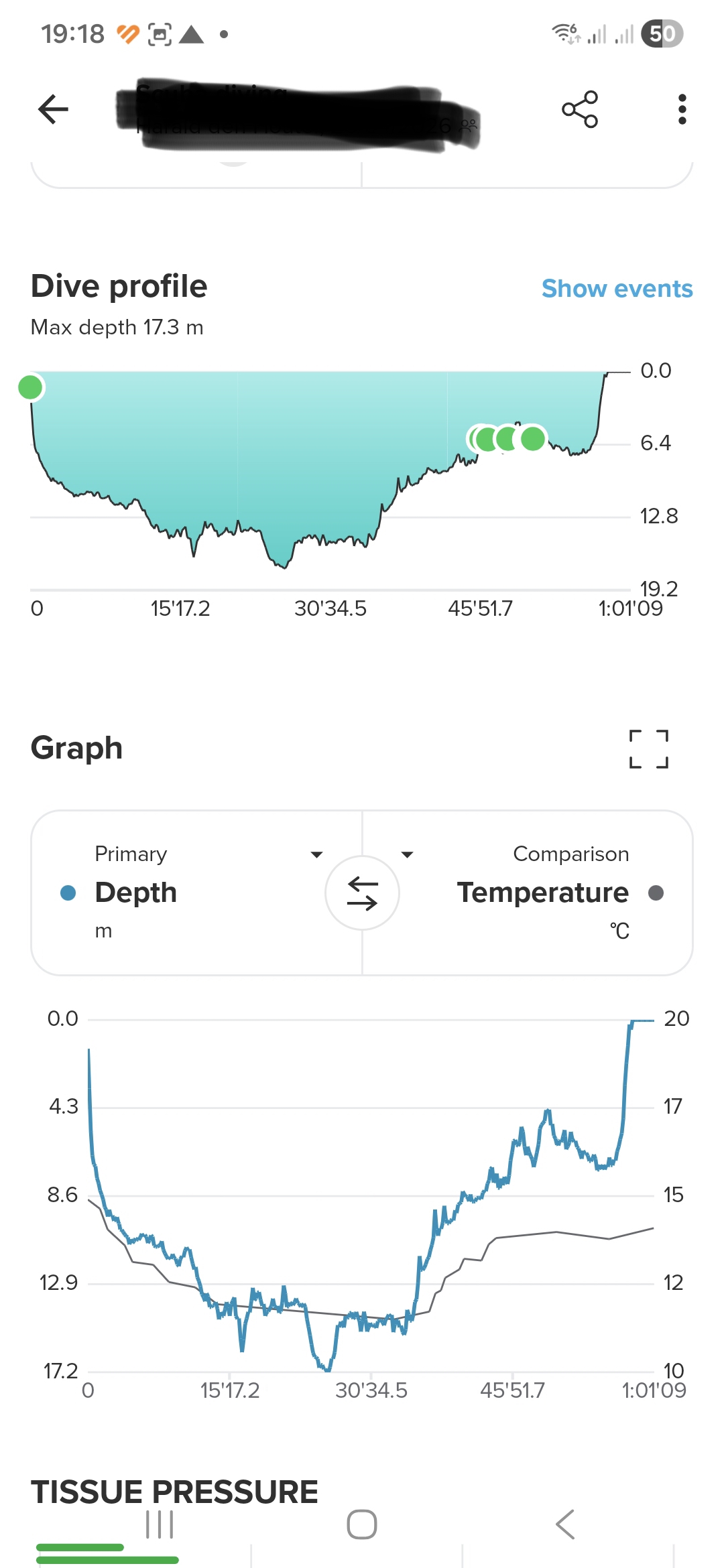

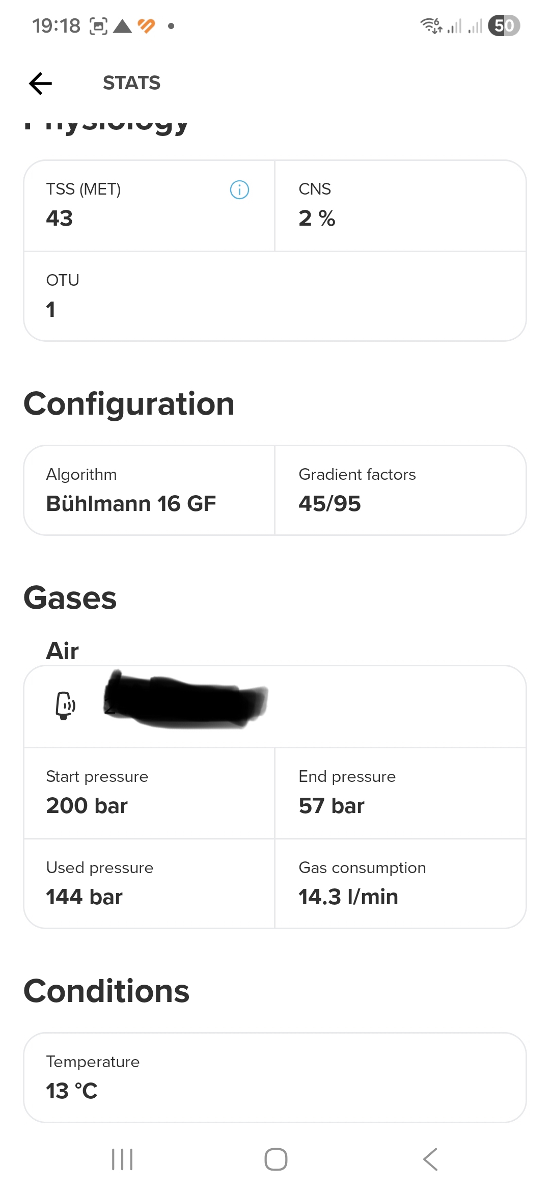

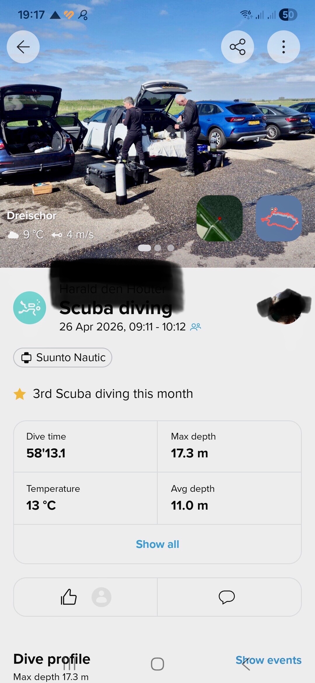

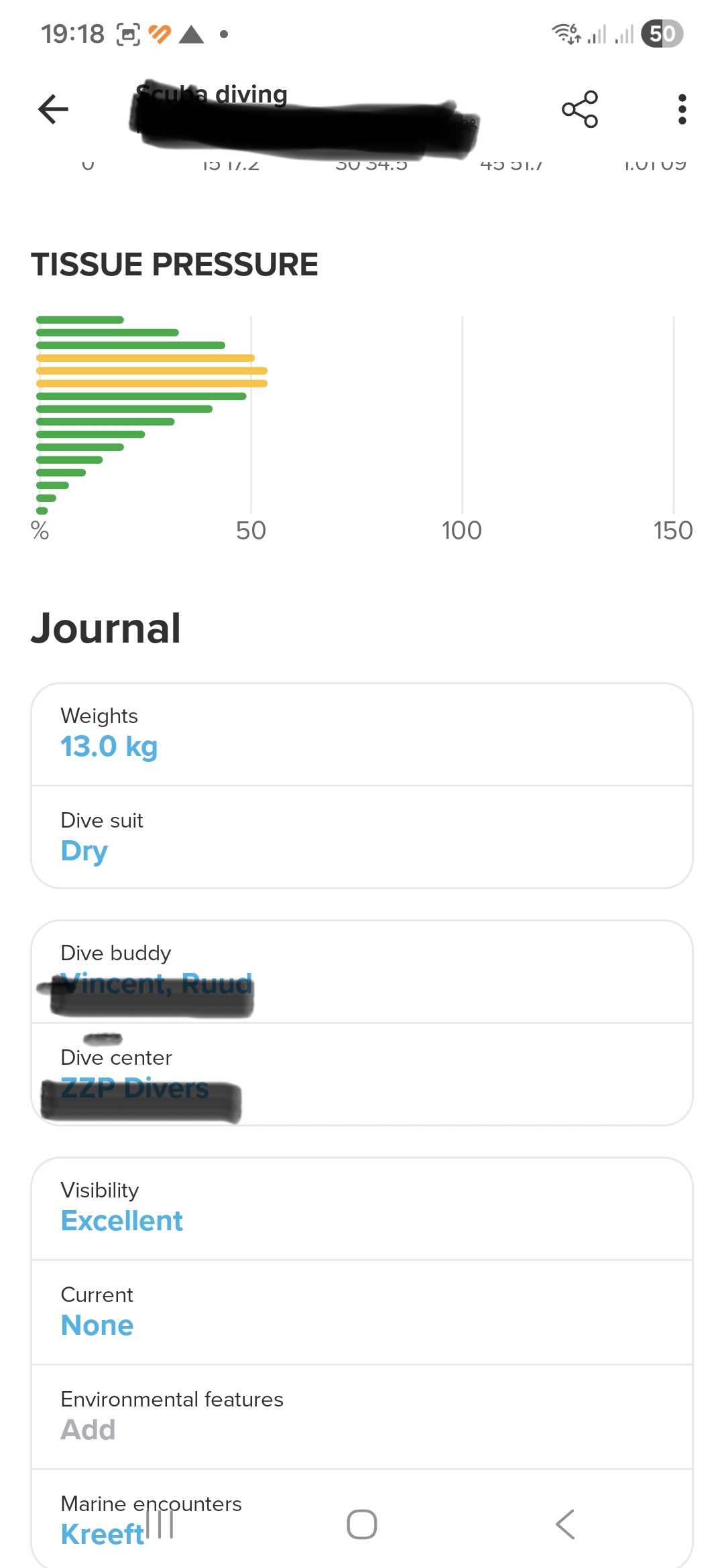

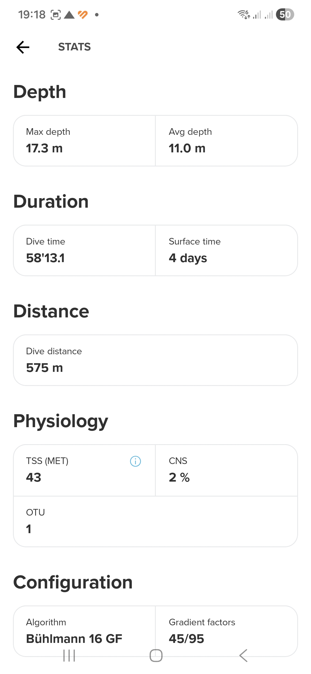

        Hi, All is possible, except videos.
        Screenshot_20260429_191757_Suunto.jpeg Screenshot_20260429_191810_Suunto.jpeg Screenshot_20260429_191817_Suunto.jpeg Screenshot_20260429_191853_Suunto.jpeg Screenshot_20260429_191859_Suunto.jpeg

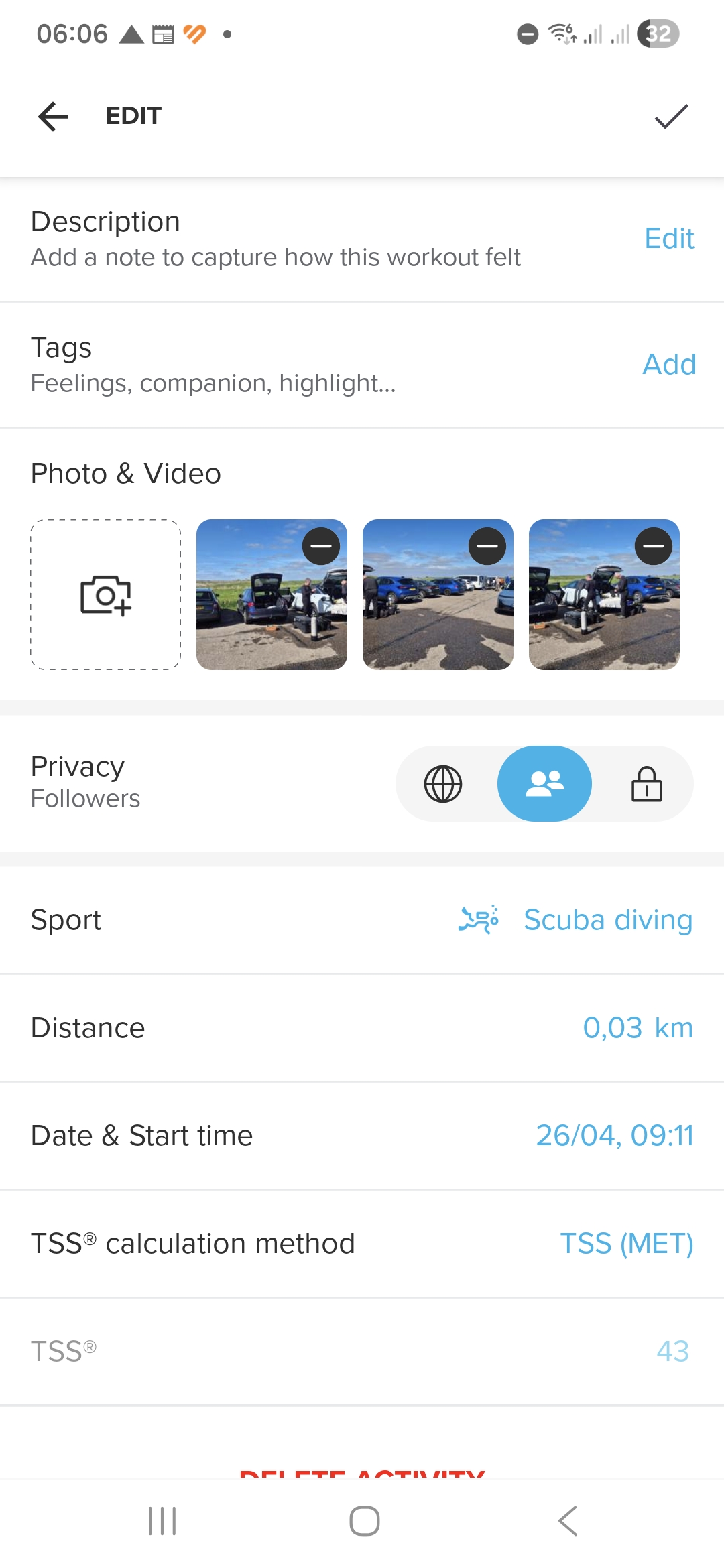

          @hhouter in Suunto App you can attach videos to the dive log just like photos
          • H Offline
            hhouter @pavel.samokha
            @pavel.samokha Great, learning everyday. Thanks !! @estragio So all is possible…Screenshot_20260430_060652_Suunto.jpeg
