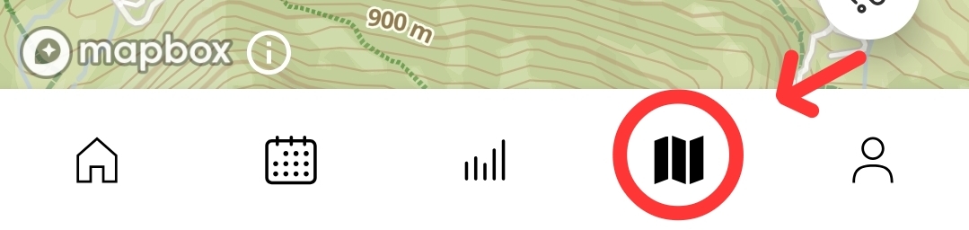

                      Maybe a trivial question: Have you enabled location services on your smartphone, and does the Suunto app also have permission to access your location?
                      At least on Android — unfortunately, I can’t say how it works on Apple devices.
                      A simple test is to tap the map icon at the bottom of the list in the Suunto app. You should then see your location displayed on the map.
