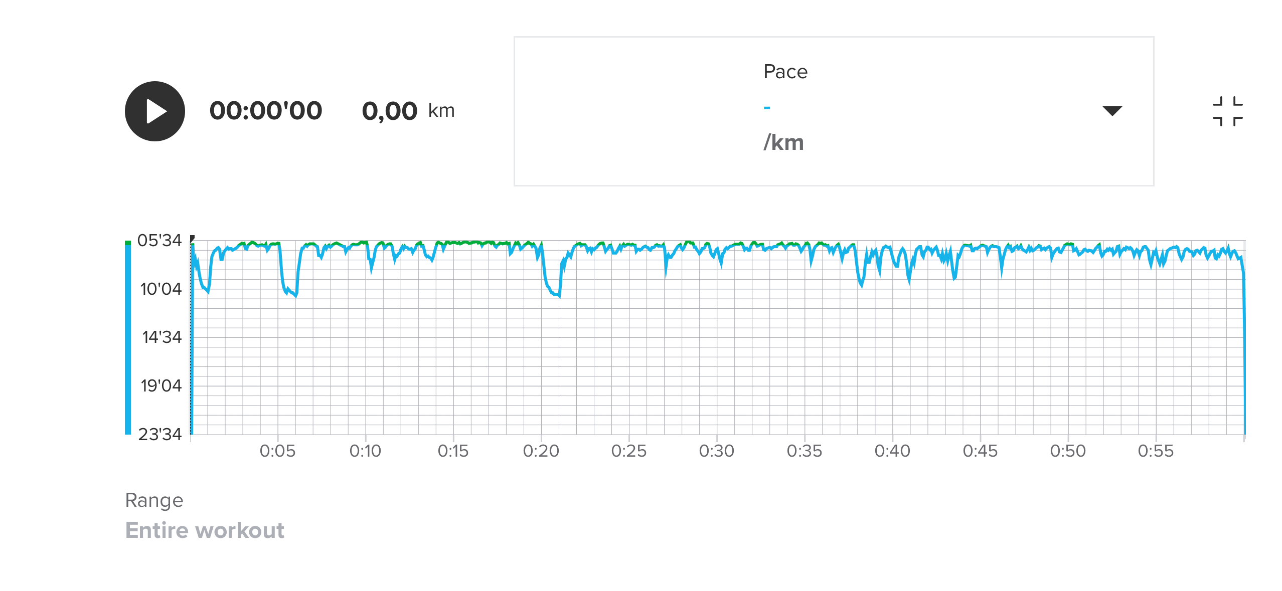

      What I find weird is that it seems that the Pace and Distance come from the watch instead of the foot pod when running on a treadmill. This can quite easily be seen when looking at the paces for the splits after the finishing the run.
      The splits have different paces even though I was running a constant speed on the treadmill. I also verified this by holding my hand still during 5-6min mark and 20-21min mark while continuing to run the same speed.
      If the Stryd pace would have been used, then there would not have been these drops in the Pace:
