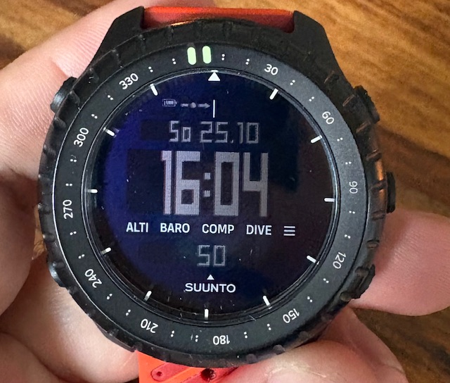

          Adam Krůžela @Egika
          @Egika Yes, the indicator is displayed, but only after you switch to the “BARO” page. You obviously don’t stay on that screen 24/7 (if only because button lock and additional views don’t work on that view).
          On the original first-generation Suunto Core, that indicator in the top-left was visible right on the main locked screen. The huge advantage was that when you were at a camp, for example, a quick glance at the watch told you how the weather was developing without having to switch over to the barometer— but this feature has disappeared.
          Don’t worry, I’m not jumping to conclusions; I’ve gone through the whole watch and read plenty of reviews, also I’m owner of first generation for years.
          The feature I’m talking about simply isn’t there. Besides, on the BARO screen itself, that trend indicator is practically useless anyway since you already have a detailed graph right below it.

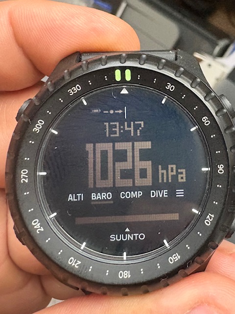

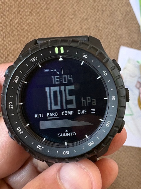

              Alpha Bronze Member
              Besides that… the pressure trend graph is still flat! How is it for you guys?! I’ve been reporting this to Suunto support for a month now, and it still hasn’t been fixed in version 1.13.44. I’ve been monitoring and comparing the pressure trend with my Suunto Core Alpha and Suunto Traverse Alpha, which I wear on my other wrist at the same time. I haven’t seen any graph other than a flat one with no pressure changes in various online reviews either.
              The numerical pressure display on the Core 2 is accurate based on the trend. But the graph is still flat. The Core 2 is, to put it mildly, “strange.” They’ve added a “Dive” feature, but they’ve reduced the diving depth compared to the Core 1, from 10 m to 2 m. 😕
              Where are the logs? The battery isn’t replaceable without a screwdriver. It has a narrow 22 mm ladies’ strap instead of a 24 mm one. It features delicate quick-release pins instead of a durable screw-down NATO strap, and the bezel’s luminescence lasts shorter than on the Core 1…

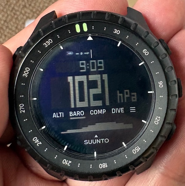

                Egika Platinum Member @Alpha
                @Alpha just now the trend shows this for me
                I don’t see an issue

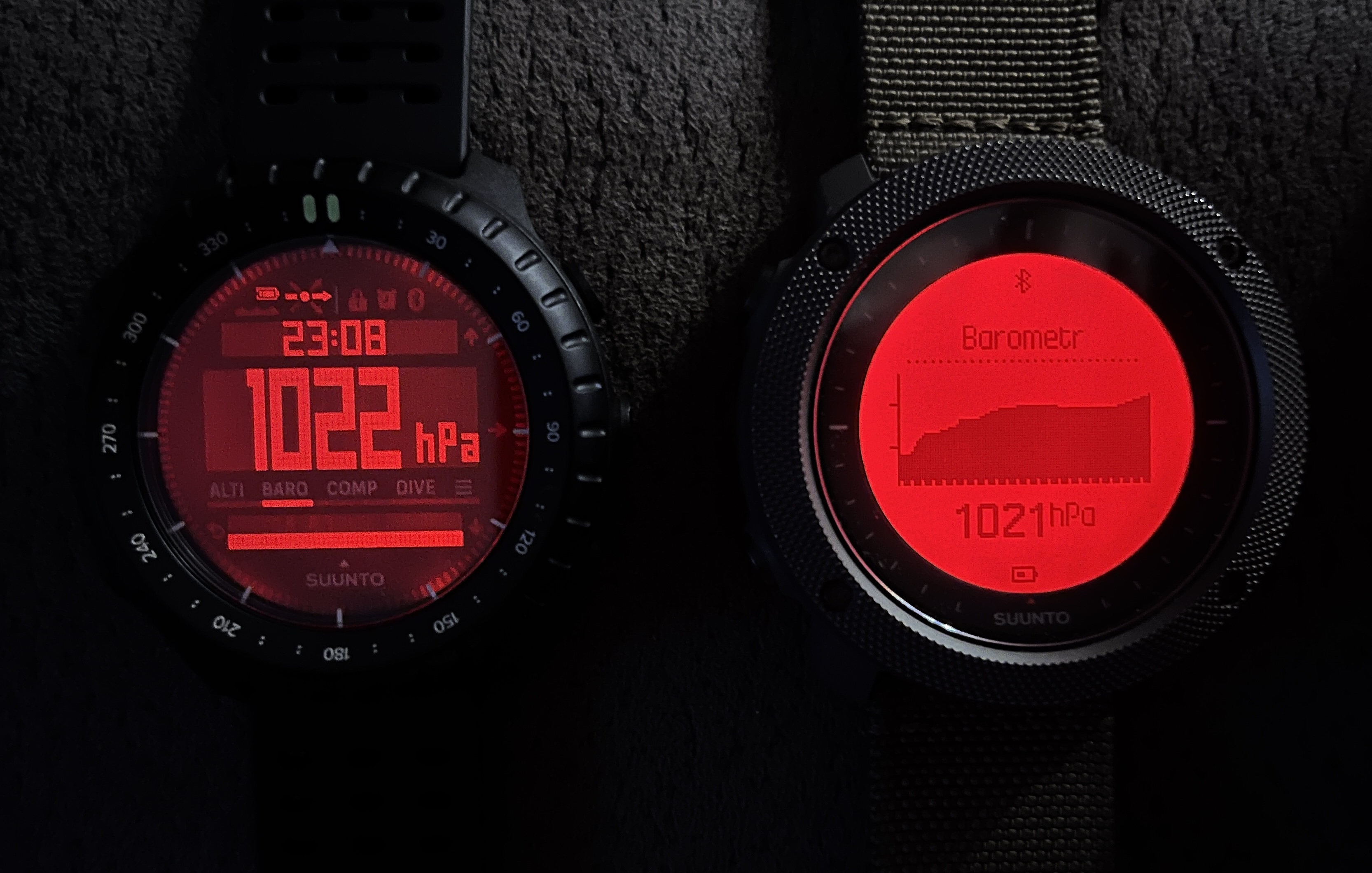

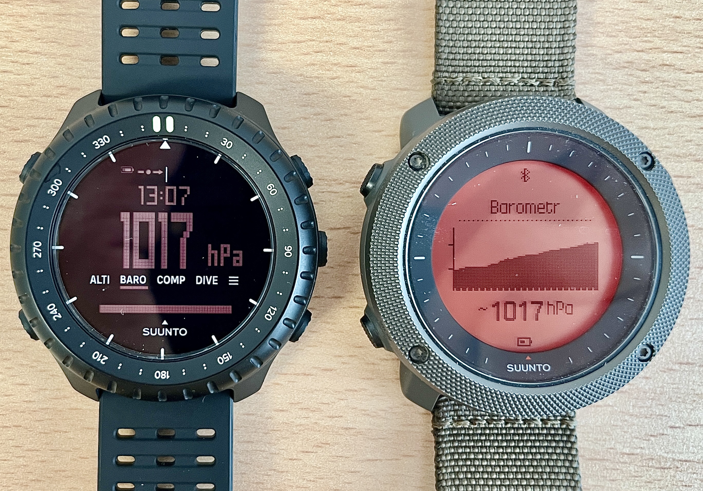

                    Alpha Bronze Member
                    There seems to be a problem…
                    I’m currently wearing two Suunto watches—one on each wrist—so I can compare barometric pressure trends. But the Core 2 watches still show a flat graph, even though the numerical pressure values change just like they do on the Traverse watches. So the problem isn’t with the pressure sensor. It’s probably a software bug.
                    I’ve been working with Suunto support on this since the watch was released. But even after updating to version 1.13.44, there’s still no change.

                      Alpha Bronze Member
                      It won’t be due to the display’s lower resolution. It’s sufficient to show an increase of a few hPa (as in the attached images).
