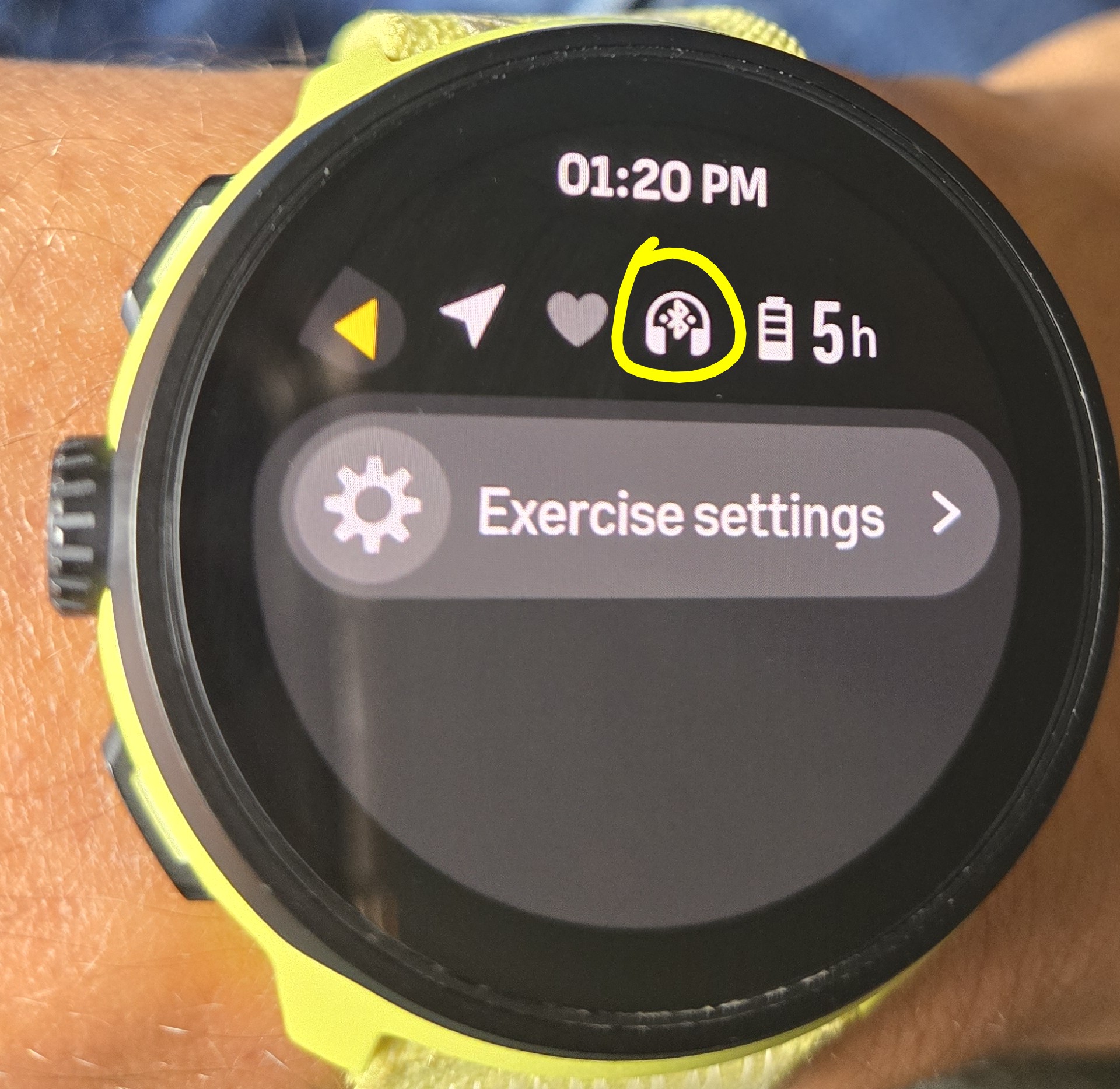

            Dtpeter
            Short update: on my two latest 5K runs i´ve been testing the Suunto Run watch vocal feedback, and sadly it does not work? 😕
            Voice settings was ON 👍
            Watch paired with my AirPods 4 👍
            Click to activate START 👍 and begin my run…
            The watch provide the beep-sound + vibration alert for every kilometer but, no vocal feedback with time, distance, average pace.
            Is there anyone here who can actually confirm that this function works on the Suunto Run watch??
              Dtpeter @Egika

              • herlasH Offline
                herlas Silver Members @Dtpeter
                @Dtpeter that was an answer applicable to Suunto watches not named Run/Run2, just tested here my Run with Airpods pro and it’s working as expected with no phone.
                Make your airpods are paired though and voice enabled.

                  Dtpeter @herlas
                  @herlas thanks for the reply + confirmation 👍
                  After I saw your comment today, I went through all the steps on the watch to make sure that “all the bells and whistles” was turned on. Then i went for my 6K run but, still > no voice/vocal feedback hmm…
                  Though, when i finished my run, stretched out and rested a bit then i tested the default mp3 music-file that the Suunto Run watch comes with, and still no sound - then i went into the volume-level, and noticed volume was turned 100% down/off by default?
                  So i turned up the volume, and the mp3 file with title “Making Plays” 🎼 was clear and fine in my AirPods 4
                  So, could that might be the case for the missing voice feedback during my runs?
                    Dtpeter
                    Just a small update: finally got the vocal-feedback from the watch working on my 6K run yesterday, and as it turned out then it was related to that the volume level in the music-app was turned 100% down/off by default.
                    (something not mentioned in the Suunto Run manual)
                    So if you happen to experience the same issue, then be aware of the following:
                    Under the START menu > Exercise settings > Sound Alerts:
                    Sound On
                    Voice On
                    Pair your watch with your headphones
                    Go to the music-app, to acces volume, and make sure the volume level is up.
                    My only complaint, was that the voice feedback (pr. kilometer) mentions the following distance, lap-time, average pace, average heart rate - but, the voice mentions my lap-time twice?
                    Was hoping for voice feedback (pr. kilometer) mentions (how much time i´ve been out running eg. minutes ) and then distance > my lap-time > average pace > average heart rate.
                    Guess that could be set in the Suunto App ?
