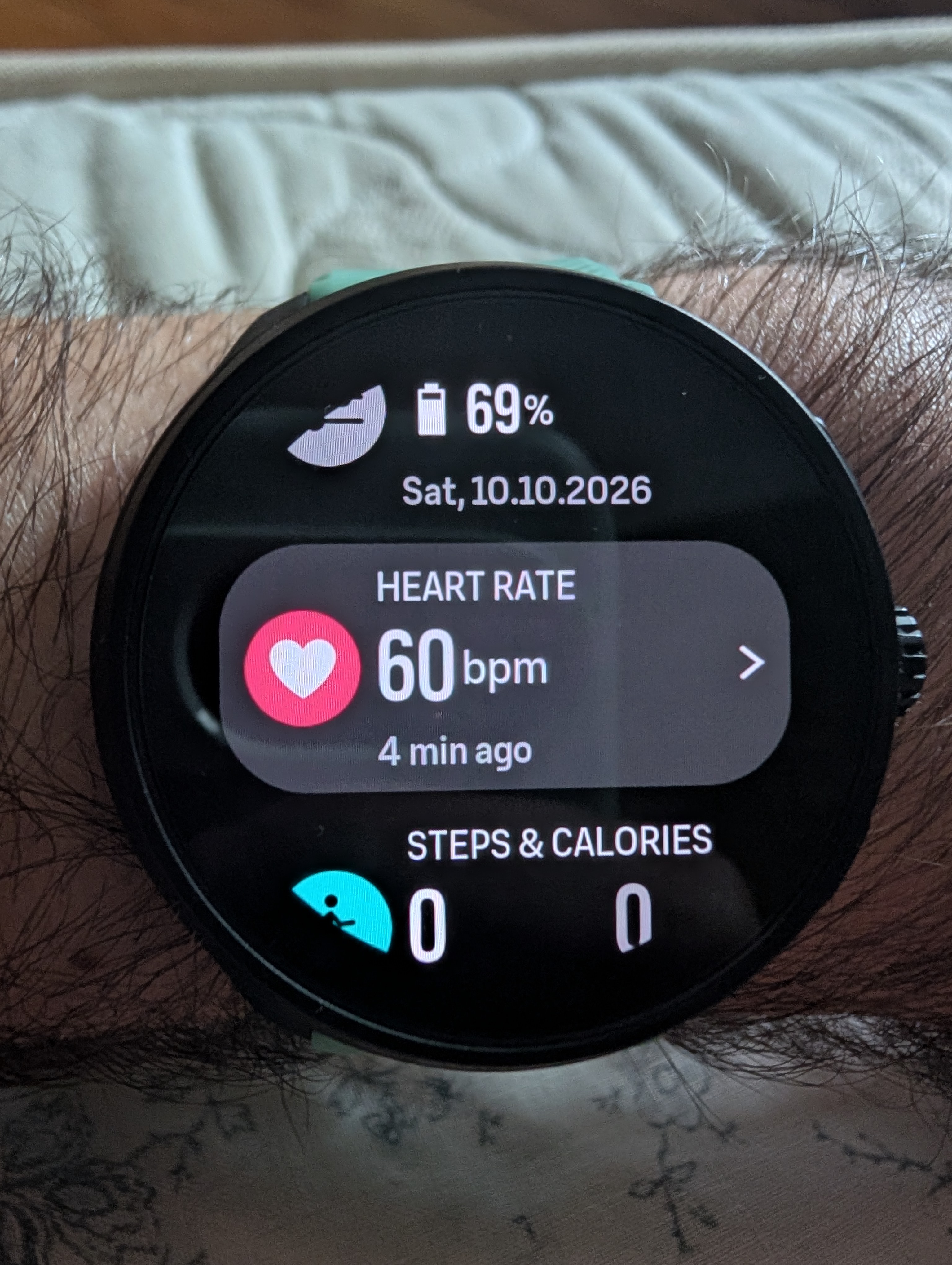

                      I have the race 2 as well and thought the functionality HR recording wise would be similar. Initially when I started using the Run 2, it would show the same thing as the picture you took (when the last HR measurement was taken).

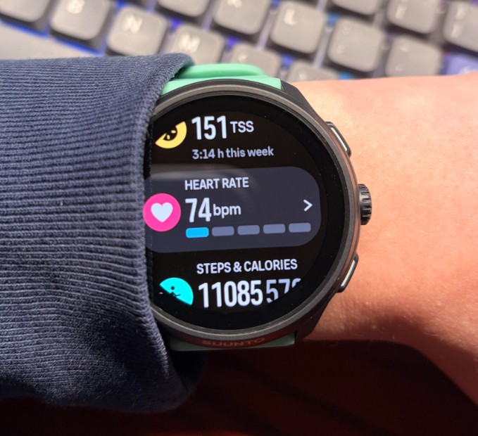

                      Now for me, the HR sensor is on constantly and has these little bars underneath:
                      I’ll perform a soft reset and see if it fixes it being on constantly.

                          @backyard It is hard to say… I haven’t been keeping track but i would say around 4-5 days. I do usually run for about 40 min to an hour a day.
                          After the soft reset, the sensor has stopped recording every second during normal usage which seems to be the intended outcome.

                            backyard @strain
                            @strain My Run 2 lasts about 10 days with three runs a week, each lasting around an hour. Yes, sometimes mine gets “stuck” too and measures heart rate every second. It’s fine after I perform a “soft reset.” It’s a bug.
