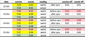

              This is what I’ve observed over the last three days.
              The watch’s sunrise and sunset times become inaccurate right at midnight, with an error of about 5-10 minutes. After syncing, the times are almost spot on again, usually within 0-1 minute, but only until the next midnight.
              This doesn’t make sense to me. I specifically bought an ABC watch so I wouldn’t have to rely on a phone connection. At this point, I have to sync the watch with the app every day just to keep the sunrise and sunset times accurate.

              • klipowiczK Offline
                klipowicz @klipowicz
                Update to my previous observations:
                The interesting thing is that the watch is significantly off only after the first midnight. If I don’t connect it to the app the next day, the time drifts by only about a minute the following day, which is normal day-to-day variation. However, the watch remains inaccurate because of the significant shift that occurred the previous day.
                It almost seems like the watch either has incorrect coordinates programmed for the selected location or uses an incorrect formula to calculate sunrise and sunset times. It may then be trying to correct the time based on the data received from the app during the last sync and overwrite it the following day at midnight.
