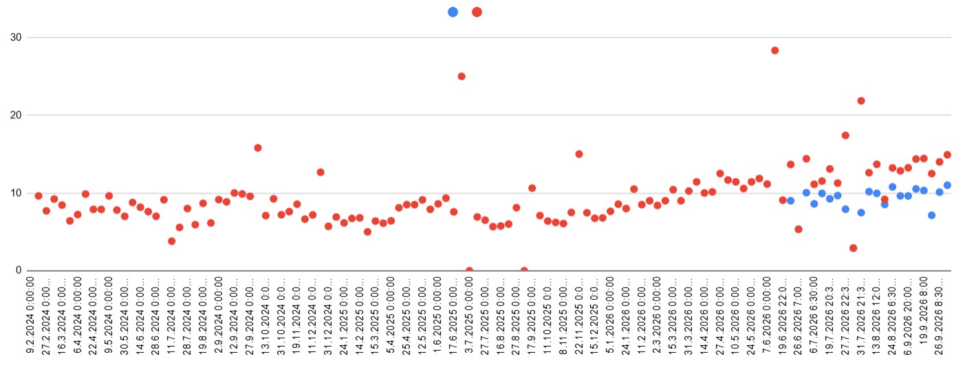

              @thanasis My SVTiS battery life has also dropped significantly. Below you can see my tracking data showing the daily consumption percentage. I only started logging this after I felt the battery was getting worse.
              Even without GPS use (blue dots), the daily drain matches what my watch used to consume including GPS tracking (red dots). I received a warranty replacement last September, but both units have had similarly poor battery life on the same firmware.
              F 1 Reply Last reply Reply Quote 3

                @Milan-Šádek It is therefore quite clear to me that this issue is related to the firmware updates, and I can say that it started in June 2025.
                For the next update, if there ever is one, my only wish would be to see this issue fixed. In my opinion, the watch does not need any new features, it already does everything I need perfectly. However, I don’t think it is acceptable to sell a watch with a claimed battery performance that simply does not match the actual battery life users experience.
