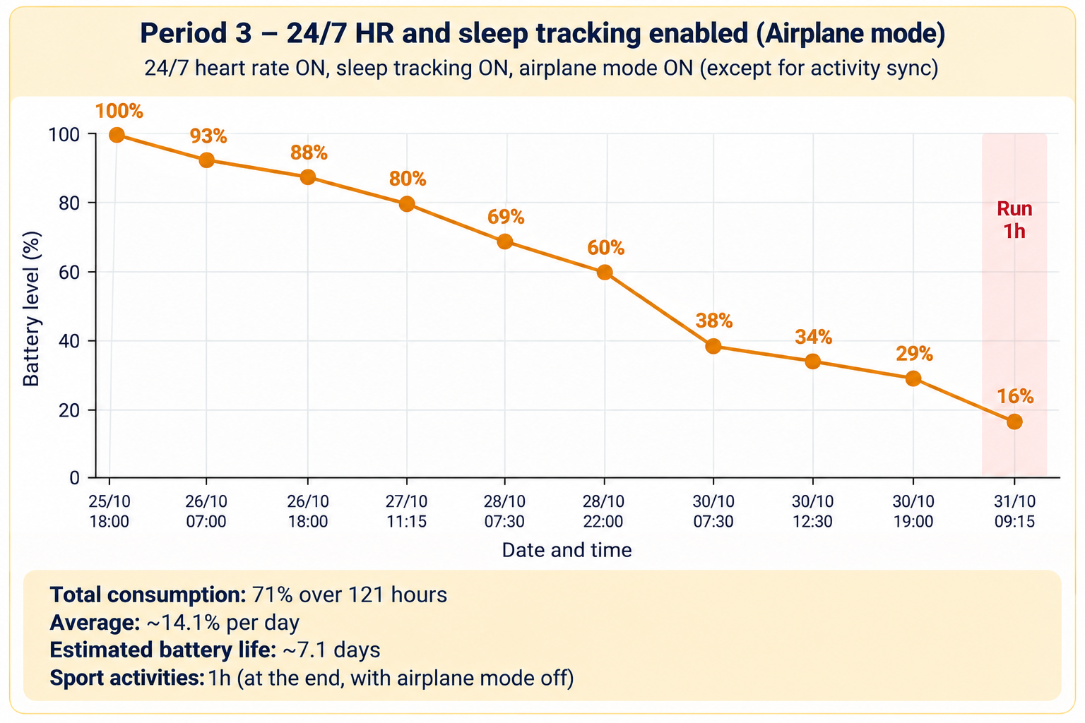

            Quick update after a third battery test.
            This time I re-enabled both 24/7 heart rate and sleep tracking, performed a soft reset, and kept the watch in airplane mode to see whether the Bluetooth connection / phone notifications could be responsible for the high background drain.
            Settings:
            • 24/7 HR: ON
            • Sleep tracking: ON
            • Airplane mode: ON
            • Medium brightness
            • Always-on display: OFF
            • Raise to wake: Full wake
            • Discovery mode: OFF
            From October 25 at 18:00 (100%) to October 30 at 19:00 (29%), the watch consumed 71% in 121 hours.
            That works out to approximately 14.1% per day, or around 7.1 days of theoretical battery life.
            So airplane mode did improve the result compared with my previous tests (~17–18% per day), but the background consumption still seems quite high to me.
            For comparison, my three tests so far are:
            1. HR + sleep ON, normal connectivity: ~18.1%/day (~5.5 days)
            2. HR + sleep OFF, normal connectivity: ~17.2%/day (~5.8 days)
            3. HR + sleep ON, airplane mode: ~14.1%/day (~7.1 days)
            This also seems to confirm that 24/7 HR and sleep tracking are not the main cause, since disabling them made almost no difference.
            At 29% on October 30 at 19:00, I disabled airplane mode and then recorded a 1-hour run. The battery was at 16% the following morning. I therefore excluded this last part from the 14.1%/day calculation because the conditions were no longer the same.
            I’m a bit disappointed that, even after trying all of this, I can’t seem to get significantly better battery life out of the watch. At this point, I think I’ll just accept the ~7 days I’m getting and live with it.
