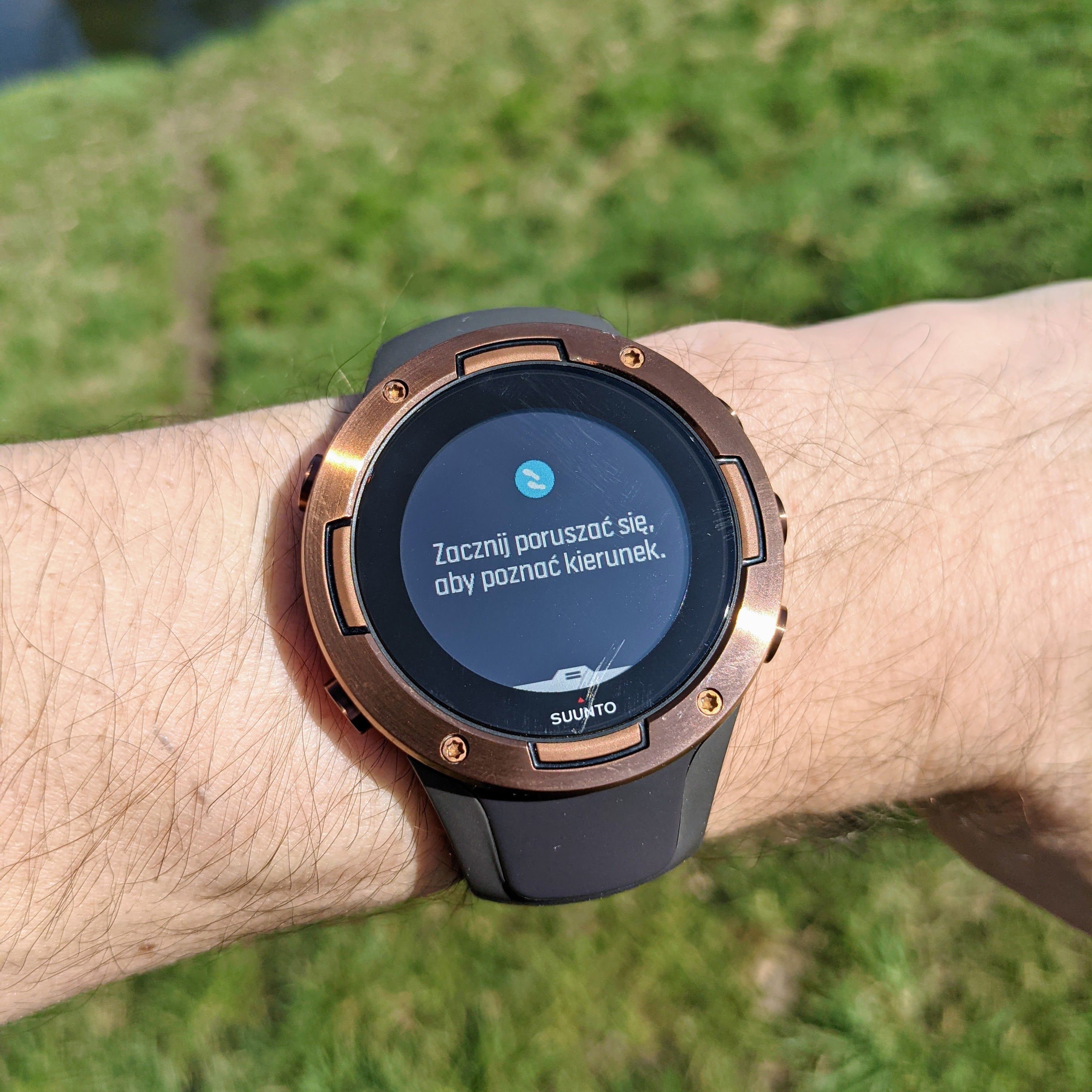

      Hello,
      is it only me who thinks that it’s really unnecessary and annoying that Suunto 5 displays info text asking user to keep moving in order to see direction when on active navigation screen?
      I understand it’s extra precaution for new Suunto 5 users since this watch doesn’t have the compass.
      However I don’t think it should be used past first workout since there is already a UI clue - when watch knows the direction, an arrow is being displayed inside the icon in the center of the screen. When stationary, only the dot is being displayed instead, indicating that the watch doesn’t know the direction. This is enough.
      I’d really like to switch off this info screen reminding me to start moving in order to see the direction. It requires me to press the middle button to reveal the path which is quite dangerous when running in hard terrain.
      Apart from this little issue - I find the watch really well designed and I believe the readability of data displayed on the screen and in the mobile app is superb and better than what Garmin or Polar have to offer. This is good design and I appreciate it.
      Can anyone from Suunto team comment on this?
      S9PP 2.44.52
      Brad_OlwinB Sébastien FayolleS 2 Replies Last reply Reply Quote 4
        Brad_Olwin Moderator @Łukasz Szmigiel
        @Łukasz-Szmigiel This has been reported and hopefully a fix will come, Suunto knows about the issue. I have this problem as well.
        Łukasz SzmigielŁ 1 Reply Last reply Reply Quote 5

          • Łukasz SzmigielŁ Offline
            Łukasz Szmigiel @Brad_Olwin
            @Brad_Olwin thanks for the head’s up. I didn’t know it was already reported. Great news that it’ll be fixed!
            S9PP 2.44.52
                      Łukasz Szmigiel
                      I’ve tested it with latest firmware. It’s still there 😞
                      S9PP 2.44.52
                        @Łukasz-Szmigiel I noticed when using this if I press the middle button the message disappears and I get the route/breadcrumb. I did not test whether the message would come back again if I stood still. Did you try this? I will test again on Wednesday.
                          @Brad_Olwin it disappears and it always worked that way. The problem is - it restarts whenever the screen changes - either by manually changing it or by invoking auto pause or even receiving a notification.
                          S9PP 2.44.52
                                Łukasz Szmigiel
                                Just a friendly reminder that this stubborn bastard is still with us with 2.14.12. What’s funny is that waypoints produced with Komoot don’t help it either as each waypoint notification resets the “dismissed” status of “keep moving…” notification 😉

                                    • Tomas5T Offline
                                      Tomas5 Gold Members @Łukasz Szmigiel
                                      @łukasz-szmigiel yes if this message wasnt pop up so often it would be better even without arrow just dot is enough to see if i am on track. Map view is good with a ability to zoom in and zoom out which is great. I was able to switch from message to map view but it must by done manualy by button.
                                        Łukasz Szmigiel
                                        Either it’s fixed or I’m hallucinating things. I was unable to reproduce the nag after it was initially dismissed, by switching the screens and cycling back to navigation. Only when toggling pause was it reintroduced (well, ideally I’d like it gone forever but it’s great nevertheless). I’ll have to hit the trails and give it another go to be sure.
                                        S9PP 2.44.52
                                          Łukasz Szmigiel
                                          Nah. Message (ie. notification from phone) resets the nag. I guess “it’s by design” then 💩
