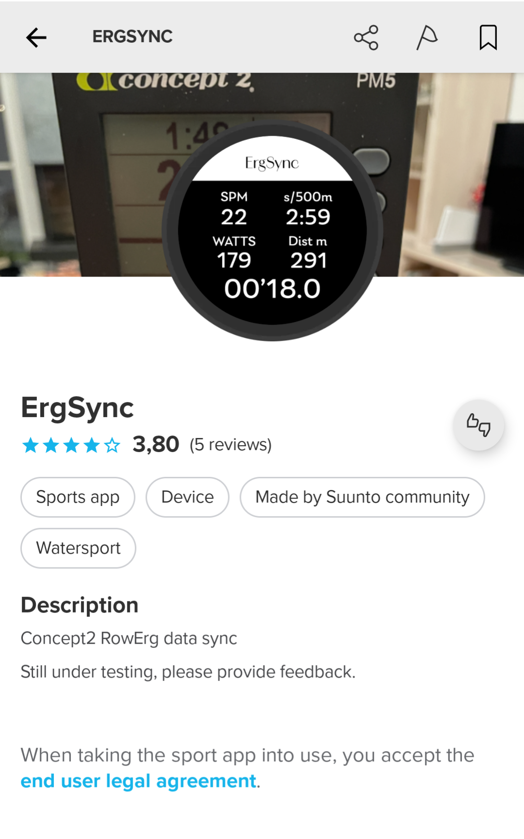

      I just uploaded version 0.4 of ErgSync to SuuntoPlus store:
      • 3 screens with all stats from PM5 (use bottom button to switch)
      • added logging of 4 main stats
      • switched to using icons
      • fixed distance display (4 > 5 digits), please test
      • display wrist HR
      TODO
      • update graphics and descriptions in SuuntoPlus store for new version
      • improve the readability of data (restore text descriptions instead of icons - please give feedback)
      • looking into options of how to send the activity along with 4 logged stats to Concept2 LogBook (ErgData)
      Martin LillepuuM P 2 Replies Last reply Reply Quote 5
      • Martin LillepuuM Offline
        Martin Lillepuu Bronze Member @Martin Lillepuu
        said in Suunto and Concept 2 indoor rowing:
        Hi,
        TODO: update graphics in SuuntoPlus store for new look
        Here are some photos of ErgSync v0.4 https://photos.app.goo.gl/LRGEyvKZCFhAu9oA7

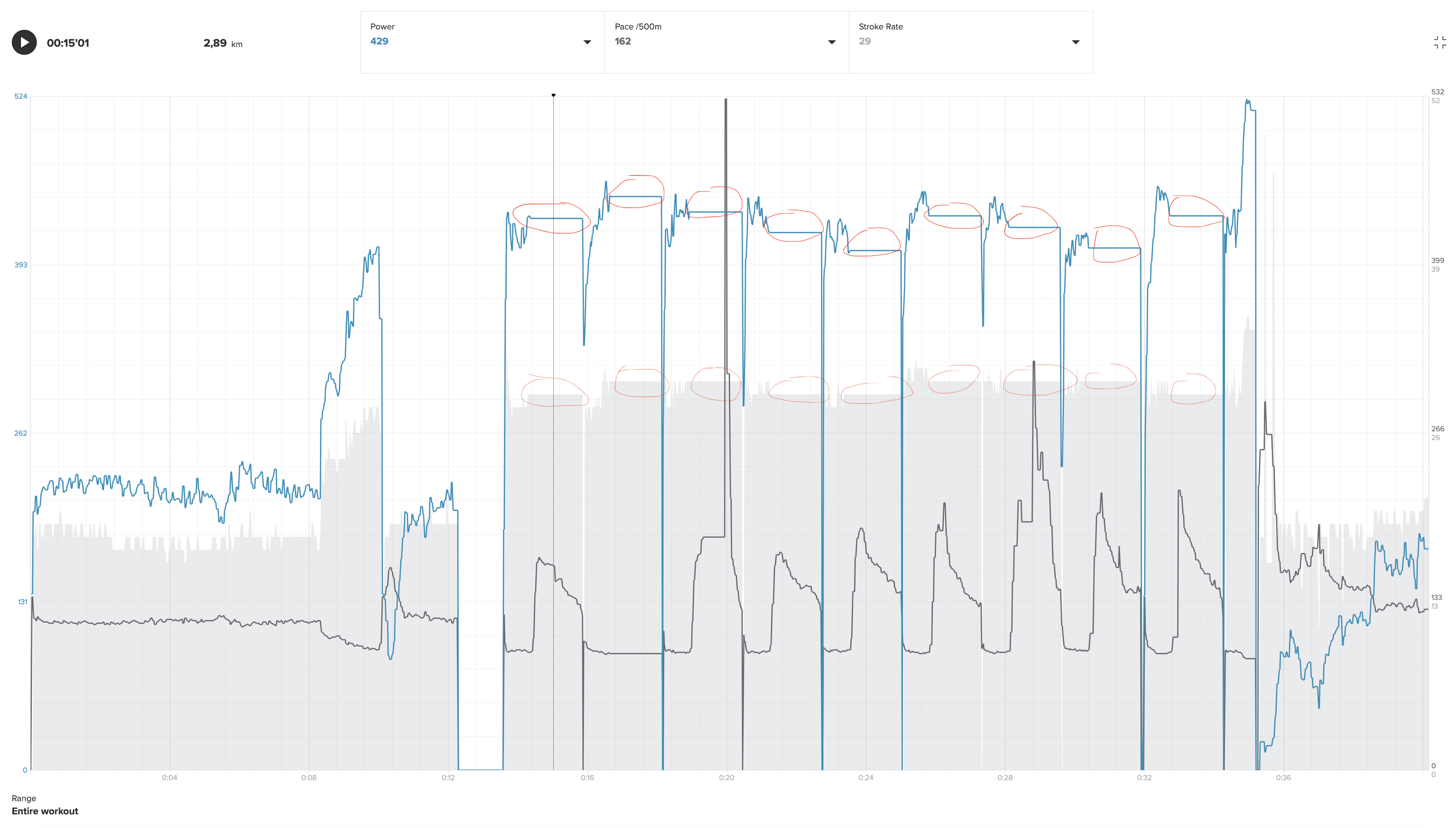

                    Did some intervals the other day, and when in recovery between the intervals the last recorded power and stroke rate seems to be continuously logged until the next interval starts. Assuming this is a PM5 thing as its data also looks to be locked, but maybe the data is on a different data stream or those values can be set to zero for the Suunto logging during recovery time?

                      Oh yea, and another thing, when switching between PM5 workouts, the distance always reflects the last distance from the PM5,
                      Example, warm up row in “just row” shows distance for that, then switching to intervals, there is a new distance, then cool down row in “Just row” will be the last logged distance that then gets sent to the mobile app.
                      A solution could be to have a dedicated distance variable on the watch app that continuously adds the distances during the whole workout for later sending.
                      Suunto Spartan Sport WHR
                      Suunto Race

                        @peringmar I assume you’re not active during the rest portion of intervals? When I do interval workouts, during rest periods I continue to take light strokes at low power. Screenshot from intervals.icu
                        I consider a session as having continuous movement without stopping so if I were to do several 100m sprints and racking the handle in between, I’d record them as distinct sessions.
                        I’m similar with cycling and running. If I do intervals in cycling, I keep spinning during recoveries at low power, etc.

                          Think you miss interpreted what I wrote, so I hope this clarifies it.
                          1. I too keep rowing at a slower pace in the rest sessions of intervals, but the issue that I posted was that when the rest session is activated when doing intervals on the PM5 (the interval mode) the last measured power and stroke rate keeps getting logged on the watch until the next interval starts. So no rest session power/stroke rate gets logged until the next interval starts.
                          2. A proposed solution for the distance was the following. Example:
                            10 minute warmup in “Just row” (2500m) gets written to variable “distance” on the watch.
                            Switch to intervals on PM5, the intervals (4000m), variable “distance” gets updated to 6500m
                            Exit intervals, cooldown in “Just row” (1000m)
                            final variable “distance” 75000m gets sent to mobile app, instead of just 1000m like its currently.
                          Suunto Race
                          P ravenR 2 Replies Last reply Reply Quote 0
                            From my screenshot, where the continues lines lie at like 440 Watts during the rest mode instead of the actual power
