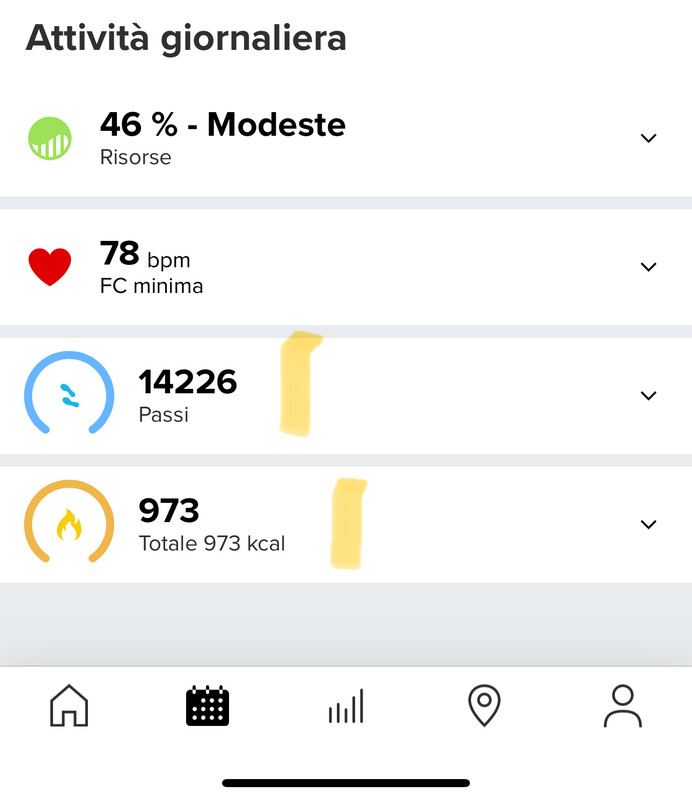

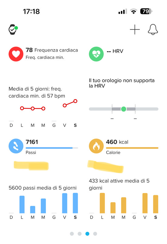

      But today in the watch widget the steps count and calories are the sum of today and yesterday’s values:
      In the home of the app scrolling right todays values are ok,
      instead in calendar tab the values for today are the sum with yesterday’s values, the same on the widget on the watch ( steps nd calories count ).

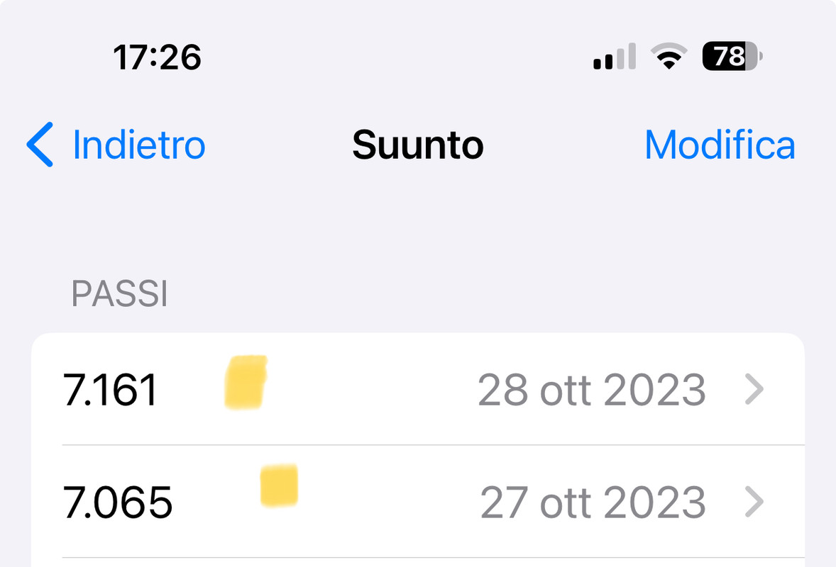

      I can say that the values passed to health app are ok as you can see in the image below.
      Watch and iOS app versions are the latest ( just bought snd updated)

      Anyone else saw this? Is it a known bug?
      Thanks

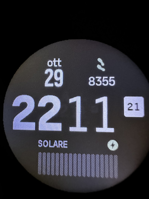

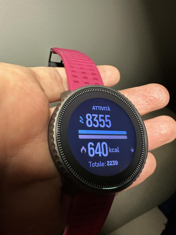

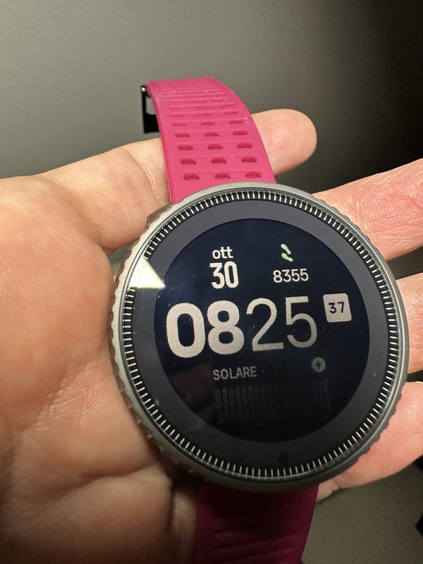

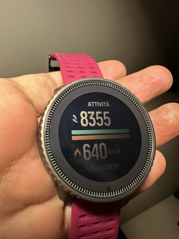

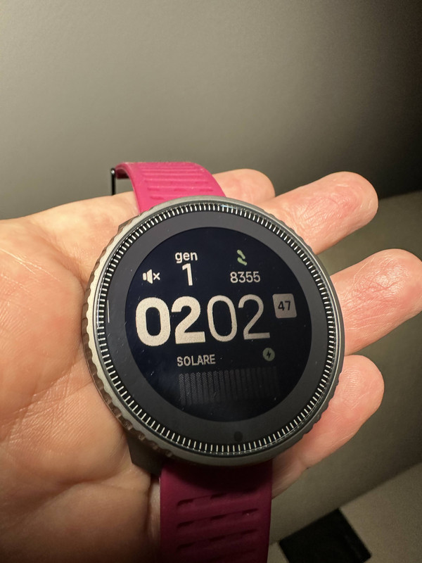

                      @isazi hello i can confirm the bug
                      Powered off yesteday evening 22:11 with 8355 steps
                      Powered on this morning and you can see that before sync date/time was wrong and steps/calories were from yesterday;
                      after syncing with the app the date/time is ok but values did not reset.
                      Registers uploaded to Suunto do you need anything to locate them?
                      I think you should have recreated as well and it’s easy for Suunto too
                      Alfredo

                        @isazi Hi, any news from Suunto, did you check the reported problem with them? I think it’s easy to reproduce… Thank You
