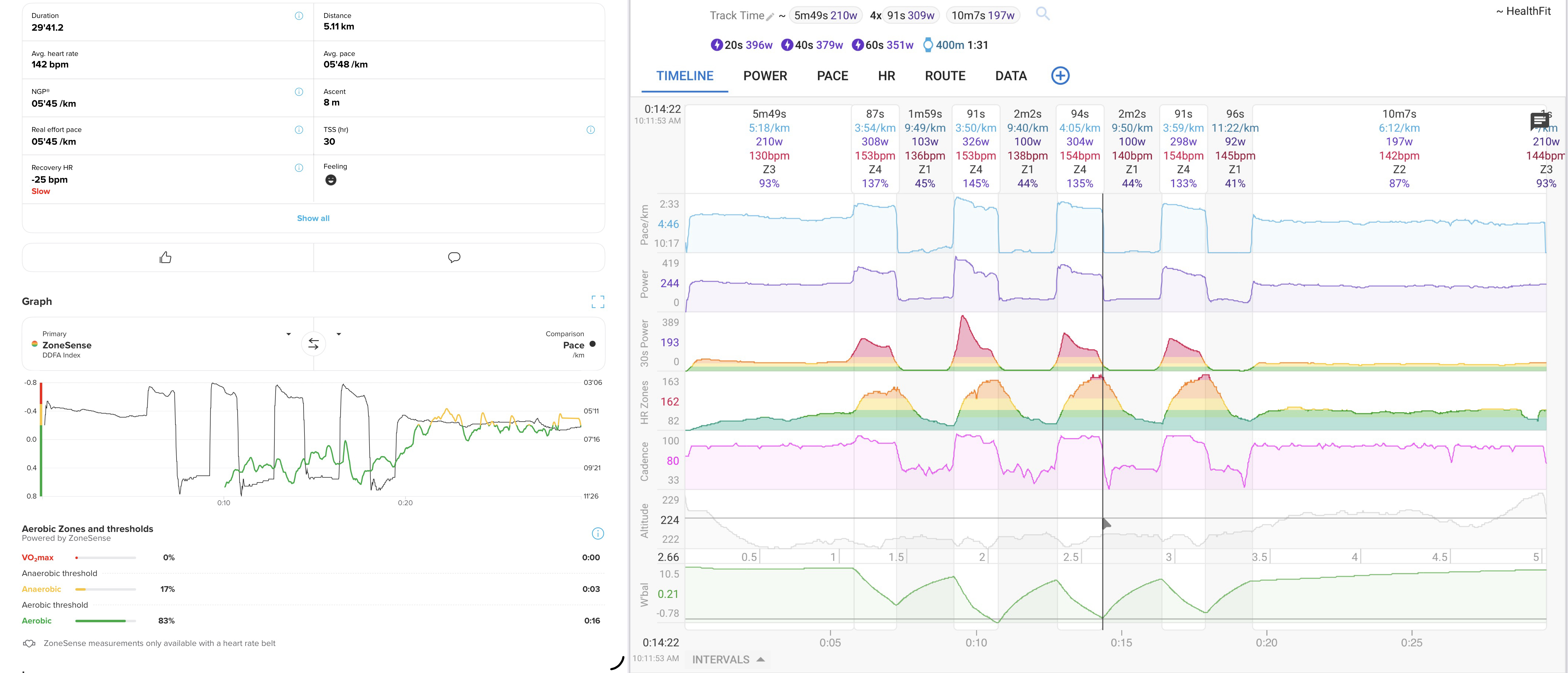

        Thanks for the report on that. My use would be interval work, things like doing repeating 800m and deciding whether to stop after four iterations or six, etc.

                Yeah, seems long endurance efforts isn’t the strong point. For me that’s fine. I may do one 20km-22km effort a year, and most of the time I’m doing either 5km or 10km overall efforts. When possible, I like to get time on track and do interval work with 100m, 200m, 400m, and 800m targets, and recoveries in between.
                This is where ZoneSense might not even register at all for a shorter interval; I might do 200m at 3:30/km, then switch to a walk and see the entire time was “green” as the effort wasn’t long enough. That’s not a slam on ZoneSense; it’s not what it’s meant to do. I’m curious if situations like that might actually register with Garmin’s Stamina or not. Post-session, I can model workouts on intervals.icu and see W’bal effects when I go above my running FTP, but during session there’s no real tool for this I have at the moment. Here’s an example (4x 400m) with Suunto/ZoneSense on left, intervals.icu on right:
