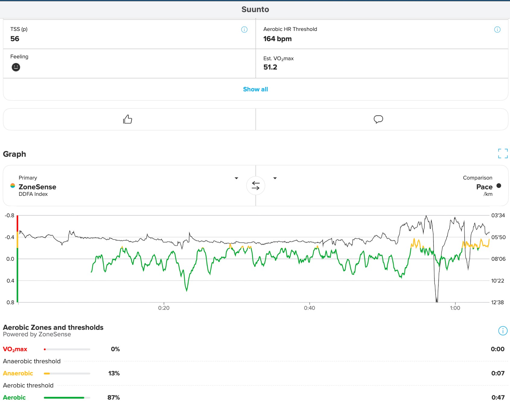

                                        • Francesco PaganoF
                                          I’m 4.5 months in a horrible state where it feels like all my progress from the past 3 years have gone. Probably the result of severe overtraining.
                                          My aerobic runs used to be around 5:30 min/km below 145 bpm, now I’m well above that heart rate at 6:00 min/km.
                                          Today after 40 minutes of another miserably slow run with elevated HR, I decided to have fun and run by the rhythm of music. I did some sprints, some fast splits, even uphill.
                                          Result from ZoneSense: Aerobic Threshold 164 bpm 🤣
                                          S9PP
                                          Suunto Spark black
                                          S5
                                          thanasisT 1 Reply Last reply
                                          Reply Quote 0
                                          • thanasisT
                                            thanasis Bronze Member @Francesco Pagano
                                            @Francesco-Pagano why can’t this be possible ?
                                            Francesco PaganoF 1 Reply Last reply
                                            Reply Quote 0
