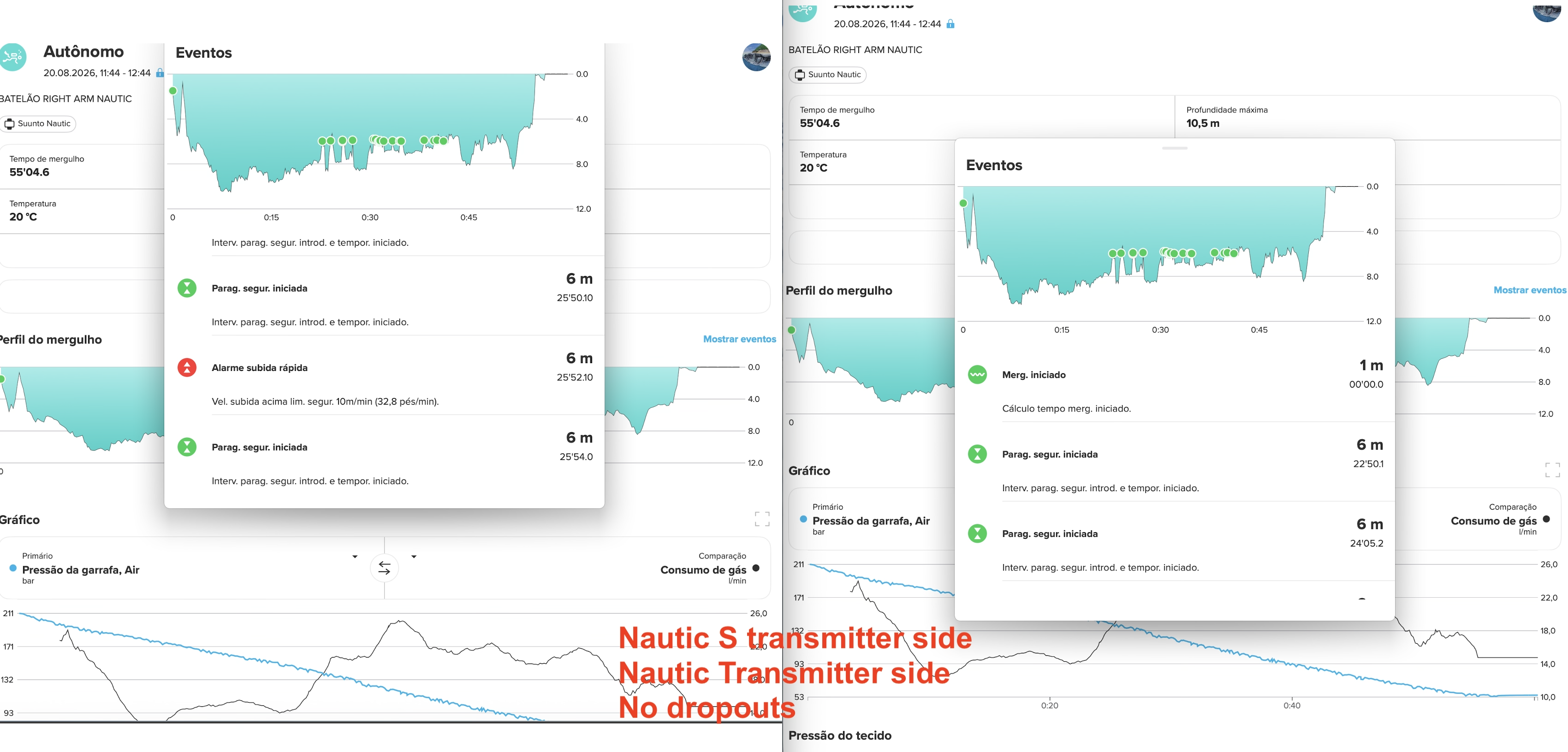

      So did 2 dives this morning (maximum depth 11m)
      Nautic - new firmware 2.55.46
      Nautic S - 2.54.12
      transmiter on Right Side
      Air consumption seems to be correct in Nautic & Nautic S
      1st dive Nautic S had no dropouts or alerts (Left arm)
      1st dive Nautic no droputs or alerts (right arm)
      2st dive Nautic S no dropouts or alerts ( right arm)
      2st dive Nautic no dropouts or alerts (right arm)
      In more and more convinced the issues some people have are due transmitter bad connection with their computer, and is more noticeable at great depths
