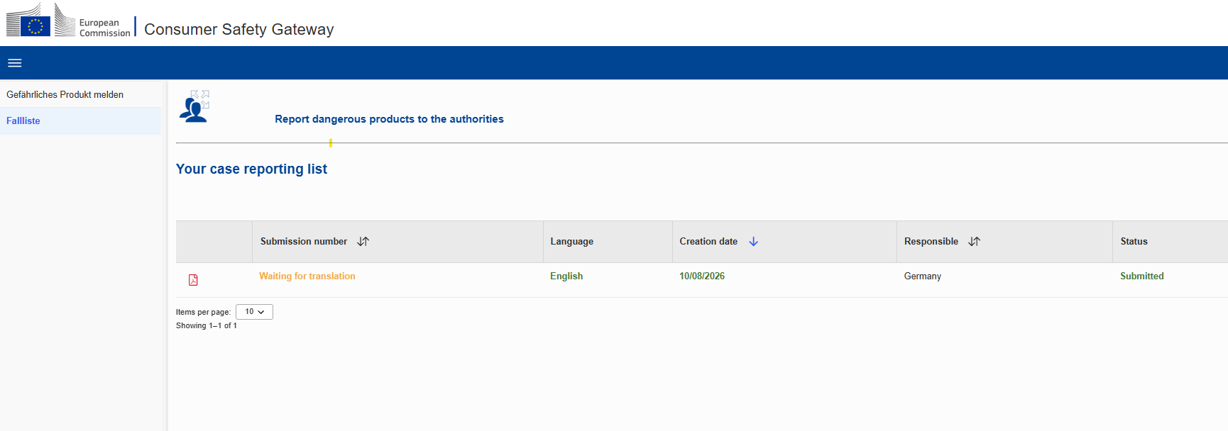

                l.sillsuunto @hhouter
                Since Suunto still shows no meaningful response and reports of Nautic issues keep piling up, I have now reported the Nautic through the European product safety system as a potentially dangerous product.
                Given the false mandatory gas-time alarms and other incorrect dive data, I think an independent safety review is overdue.
                I’ll keep you updated.

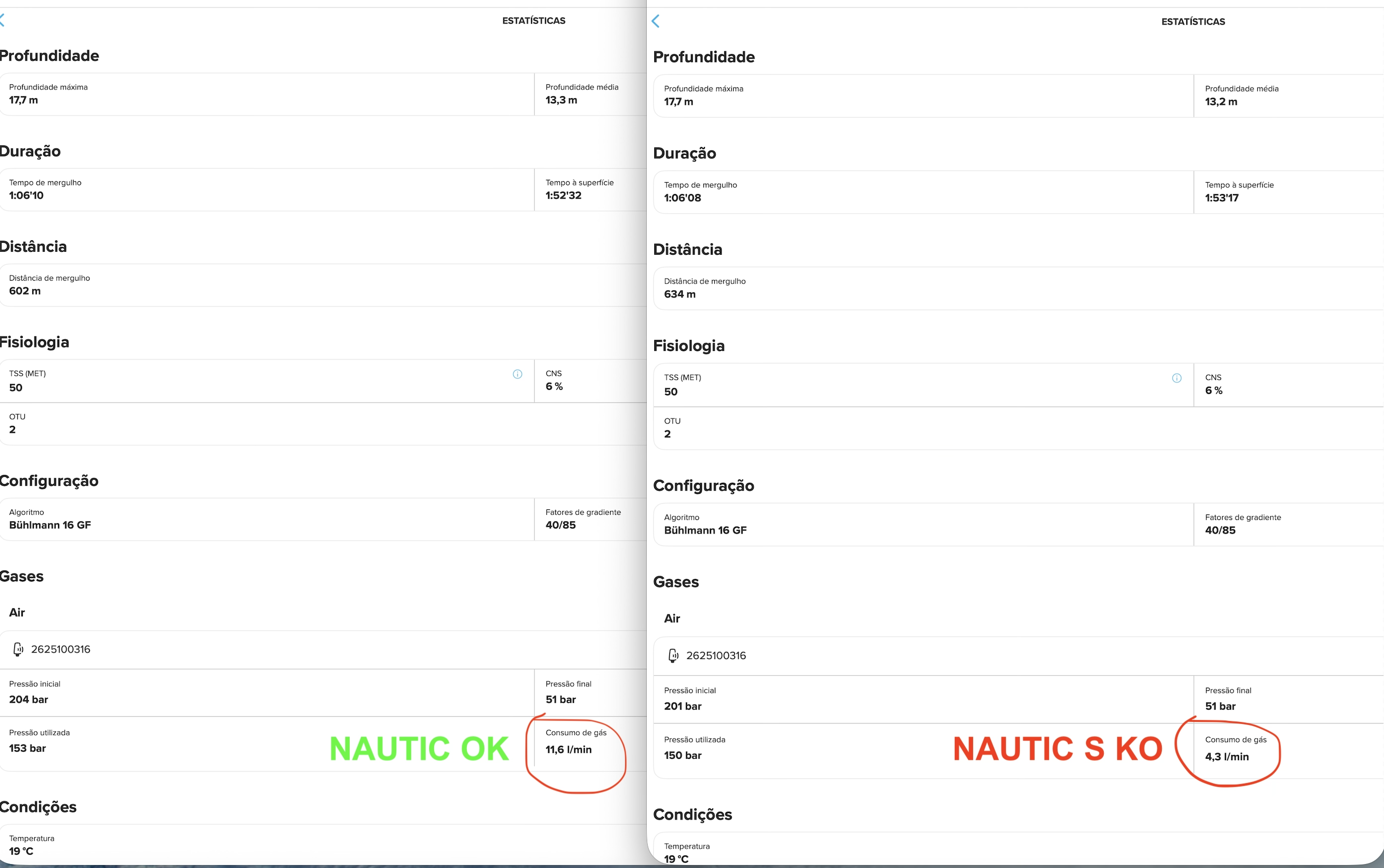

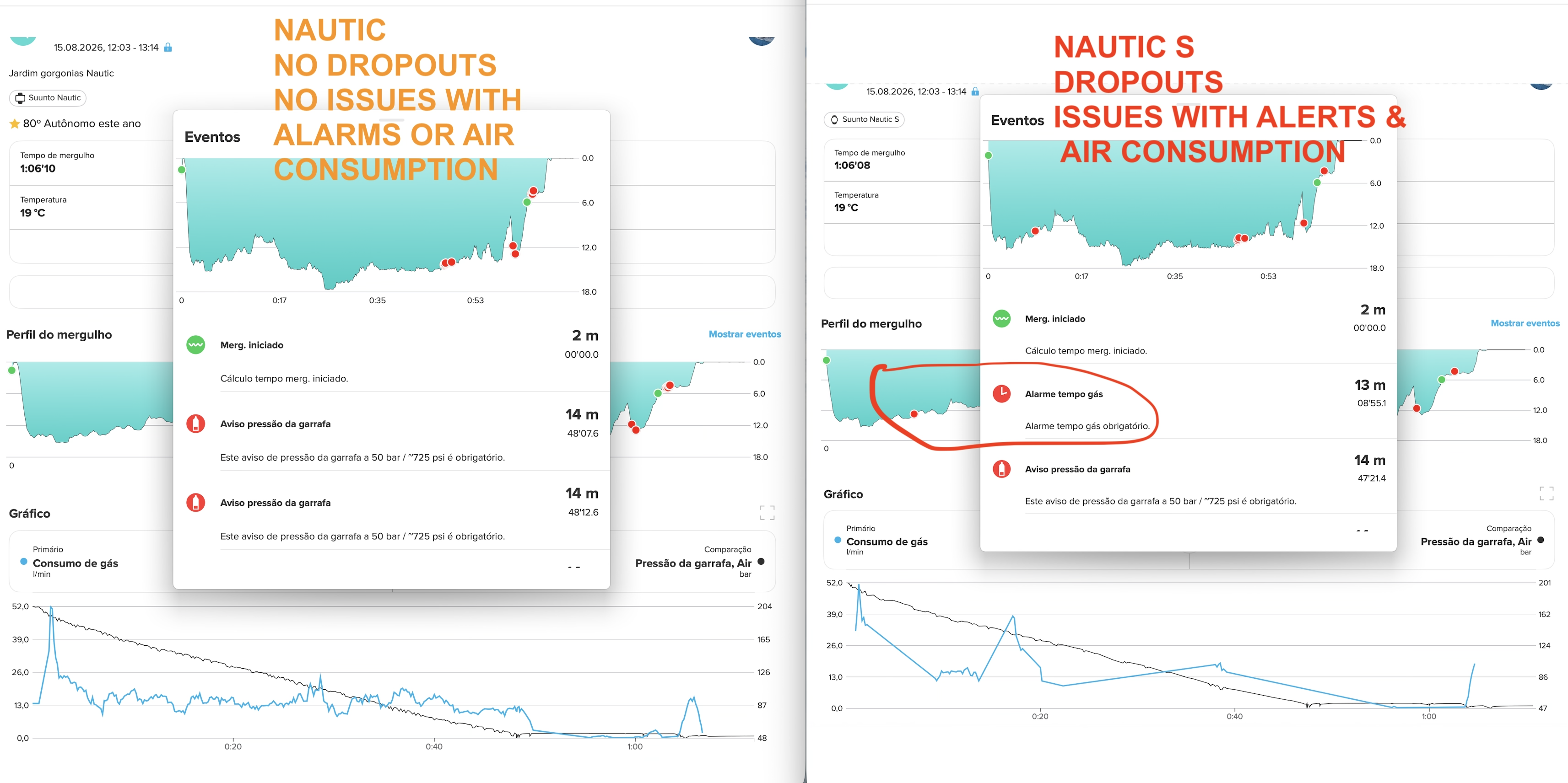

                    Since my latest findings, im starting to get a conclusion based on what I’ve observed (some of you might not be on the same opinion)
                    Nautic - No dropouts > No issues (air consumption or alerts)
                    Nautic - With dropouts > issues air consumption & alerts
                    Nautic S - No dropouts (sidemount ) NO ISSUES watch & transmitter are close by
                    Nautic S - with dropouts (backmount ) ISSUES since the watch is opposite side of transmitter
