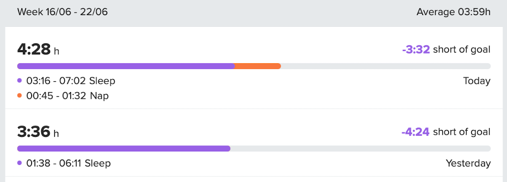

              For example this night it reports
              • falling asleep : 3AM (turned off light at 11PM)
              • wakeup : 7AM (accurate)
              • nap detected : between 1h - 1h42 (AM)
              Will try to change some params to see (rest HR or sleep target)
              Yesterday (firmware 2.43.8) almost all was incorrect
              Start/end sleep time and even the sleep duration seemed incorrect
