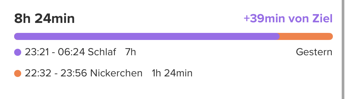

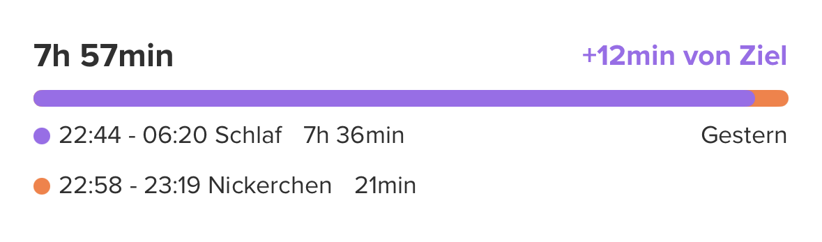

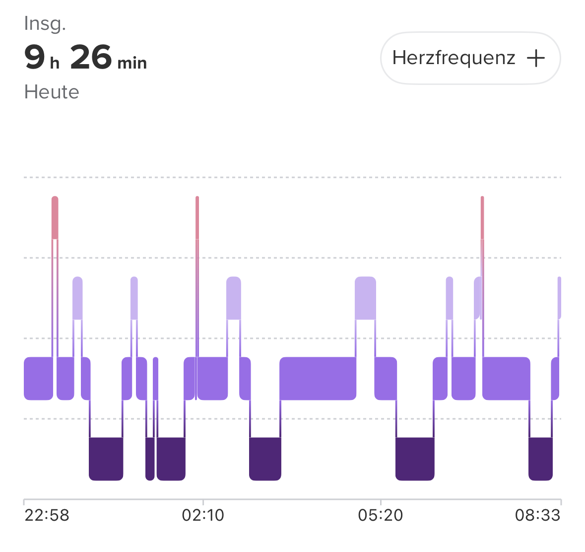

                    2b2bff Gold Members @isazi
                    @isazi said in [Race S - 2.50.28] Nap detected during recorded sleep:
                    so report it again if it happens with the new firmware
                    And there I am:
                    Nap accounted to yesterday:
                    And tonights sleep:

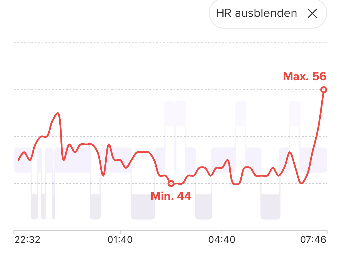

                    Fair enough, I did wakeup because of some noise around 23:55 - as seen by the rising HR. But the sleep tracking didn’t even registered it as wakeup…
                    I think, somebody should look at that code on a higher level as there seems to be something broken in the overall logic…

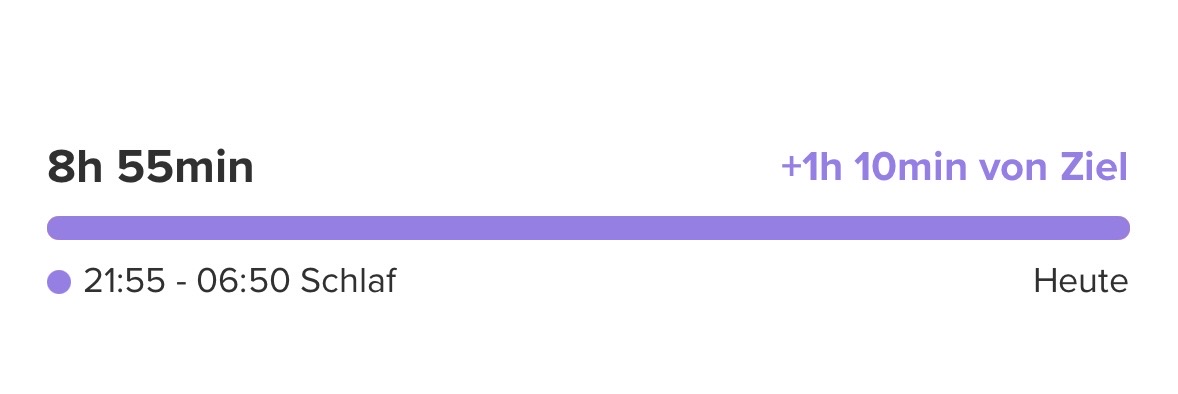

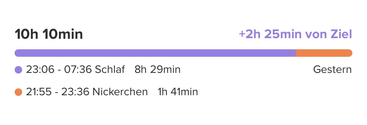

                      2b2bff Gold Members
                      And again…
                      Yesterday:
                      Today:
                      Garmin Epix Pro
