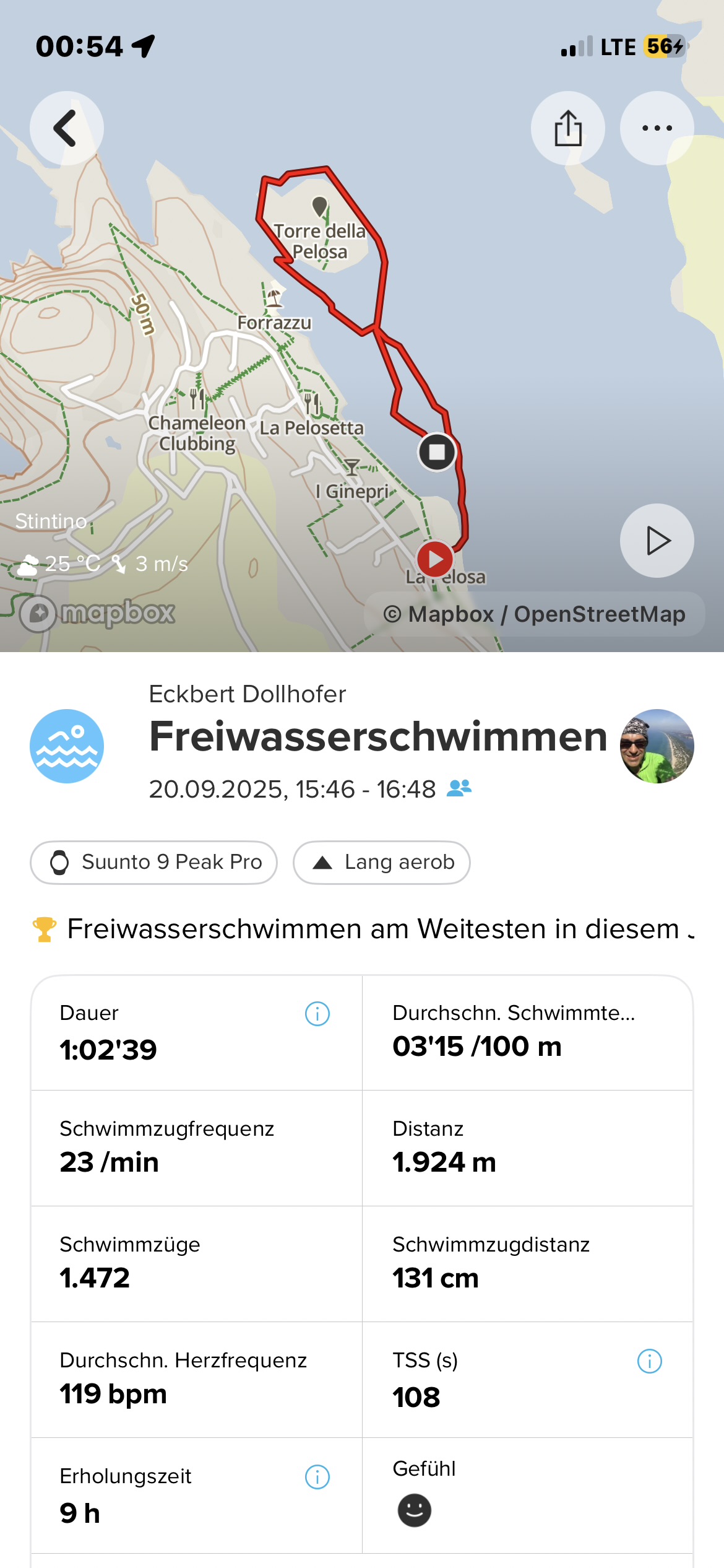

        @Francesco-Pagano this one is from last autumn. I was quite surprised cause earlier swims didn’t work that well from gps. I just carried the watch on my wrist.
