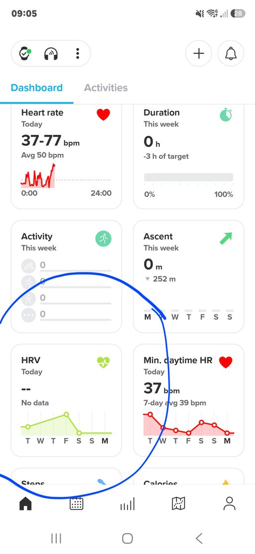

      Due to the new addition to the family (new born baby) R2 does not recognize my sleep pattern to well which can be understandable.
      I would like to ask if during naps watch can take HRV measurements which it does not do right now?

        @Elad-Solomon Taking a measurement during a nap might be an idea, but unfortunately I don’t think it would be very useful since there are many factors throughout the day that can affect HRV. A temporary workaround would be to use an app like Kubios or Elite HRV and take a quick reading first thing in the morning, right after you wake up (but even there I doubt will be useful or at least it wasn’t for me during those sleepless nights)

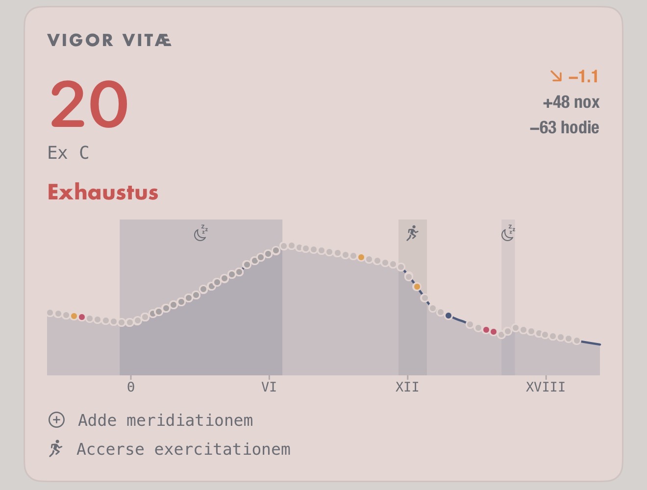

            @GiPFELKiND I did comparative testing of my own algo mimicking Garmin’s Body Battery (analogous to Resources), and found that HRV wasn’t as impactful as I thought.
            Loose concept is a four-way charge/drain mechanism:
            1. Sleep - charge
            2. Wake - not moving - low drain
            3. Wake - not moving but slightly increase HR - higher drain
            4. Exercise - higher drain
            The functionality is dependant on having an accurate max HR, which can be a challenge (and where Garmin’s constant max HR estimation can be helpful).
            @elad-solomon here’s a peak at a nap with mine: it goes up, but not by a lot. Basically, and not to dismiss your needs, but worry about the baby and not a very fragile fictional estimation of your resources. 🙂
